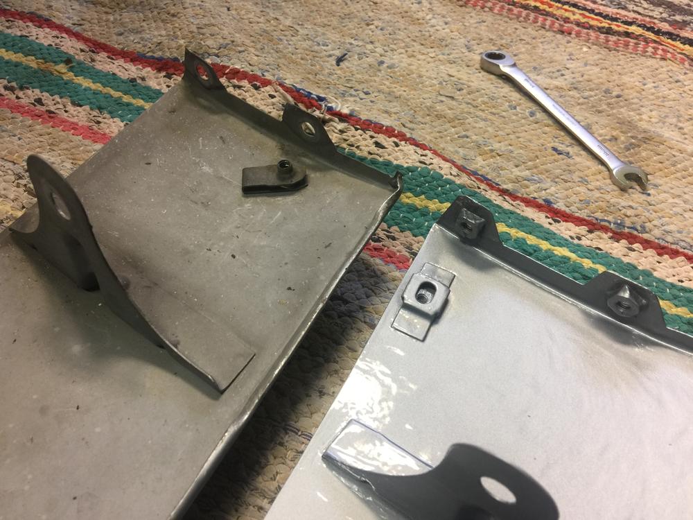

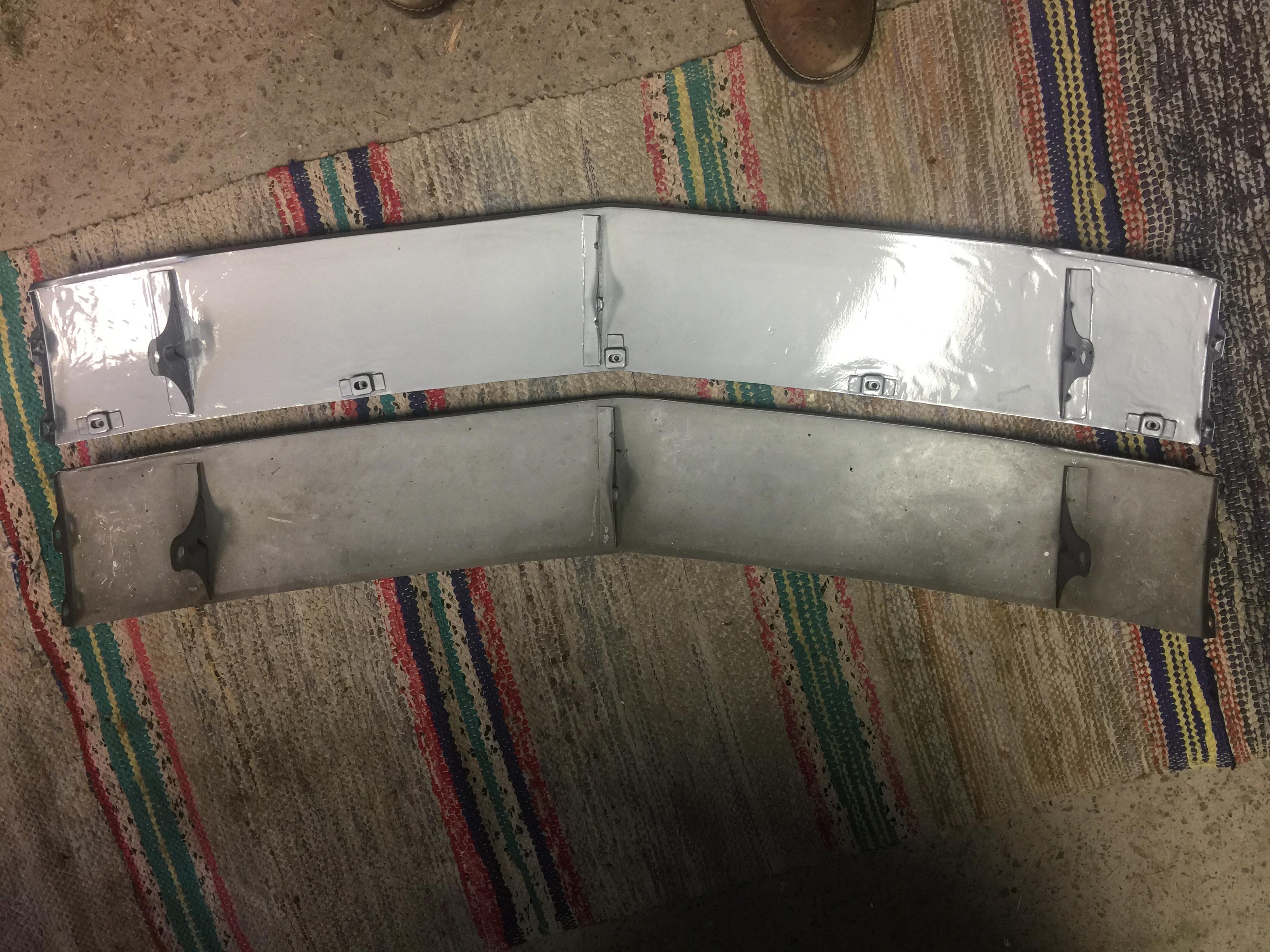

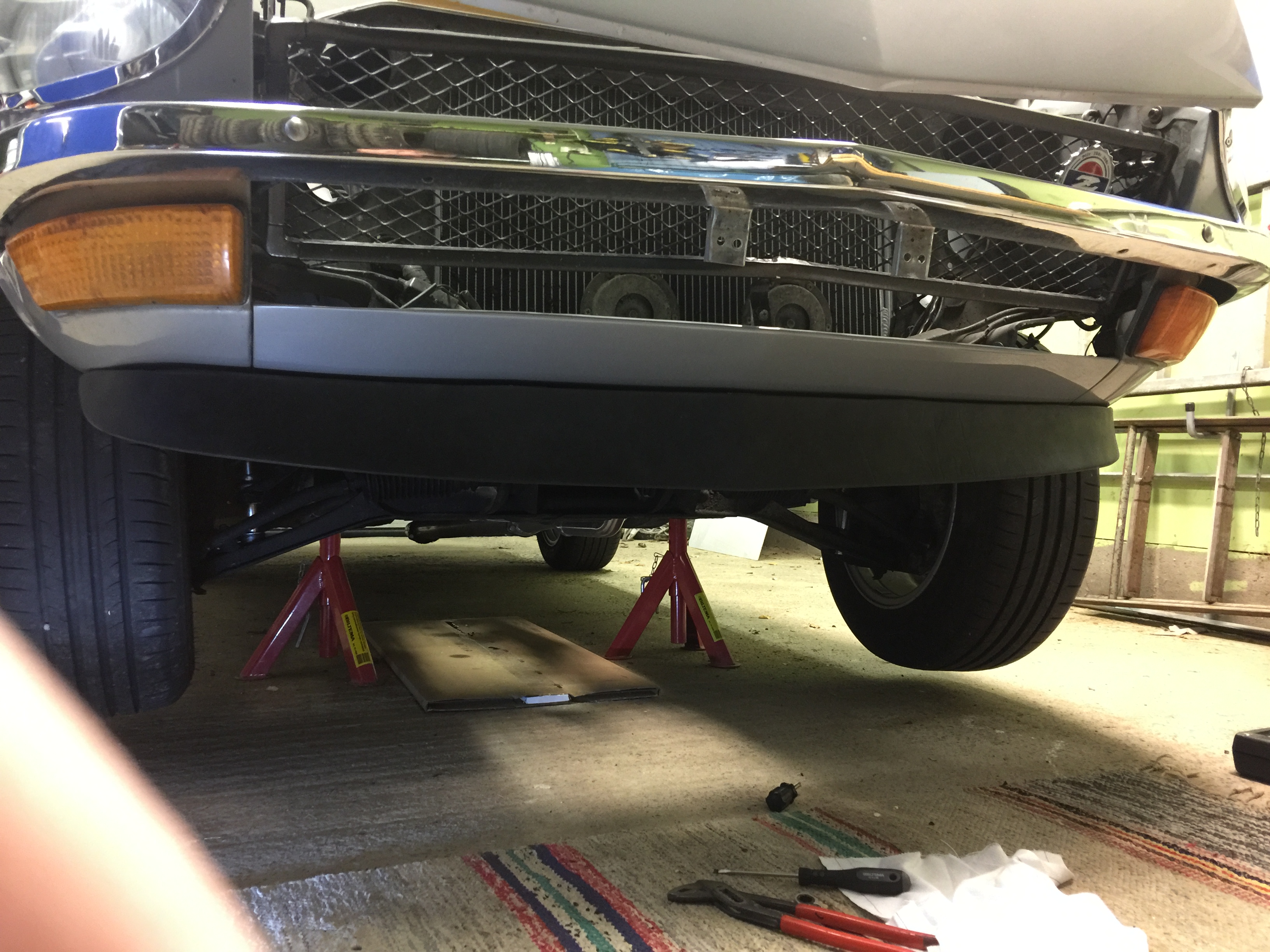

IMG_9951.JPGIMG_9949.JPGIMG_9950.JPGGot my Oem Euro front valence (predrilled with built in nuts for the Oem front spoiler) back from paint.
Discovered that the Us valence and the Euro valence have different ways of mounting.
Euro has built in nuts Us don't, or is it something that depends on what year it's made?
Hope to get time to put the valence and spoiler on the car this week.

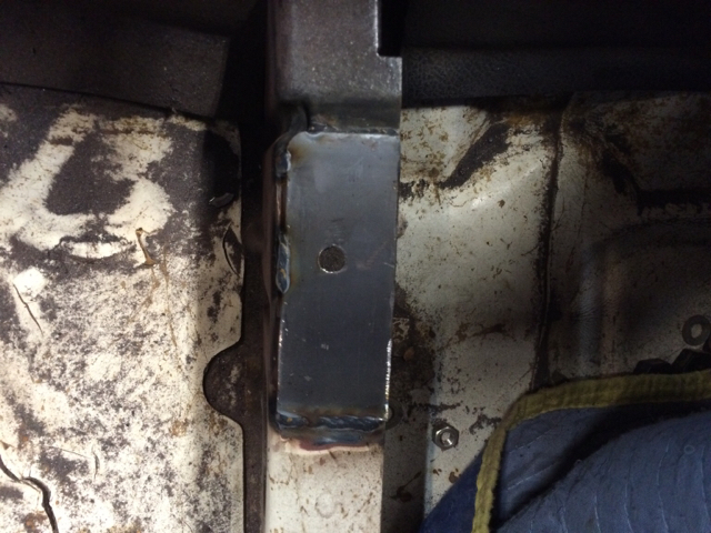

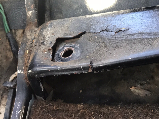

My awesome mechanic, Rod Schmitt in Rancho Cucamonga, CA took care of a couple of items for me. The driver seat had punched through the mounting areas on the left side, both front and rear. He welded them back into place and added 1/8-inch steel plates on all four corners to strengthen it all. I will finally be able to lean back into the seat comfortably!
The frame for the lower half (seating area) of the seat was broken and bent and needed to be replaced, which he also took care of.

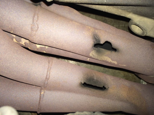

Also, he welded up some holes in the exhaust system. Should run even better now.IMG_6980.JPG.6112f4ae4edc054e130ae11f9408a165.JPGImage1517362979.613675.jpg.7aedcb51b2509c62e36ac3d7845e8d9e.jpgImage1517362997.654253.jpg.a0e459ca8f32b94d896faf453973917f.jpgImage1517363010.268423.jpg.0b148c56b88c8291c00f7fc1c7d8fba6.jpg

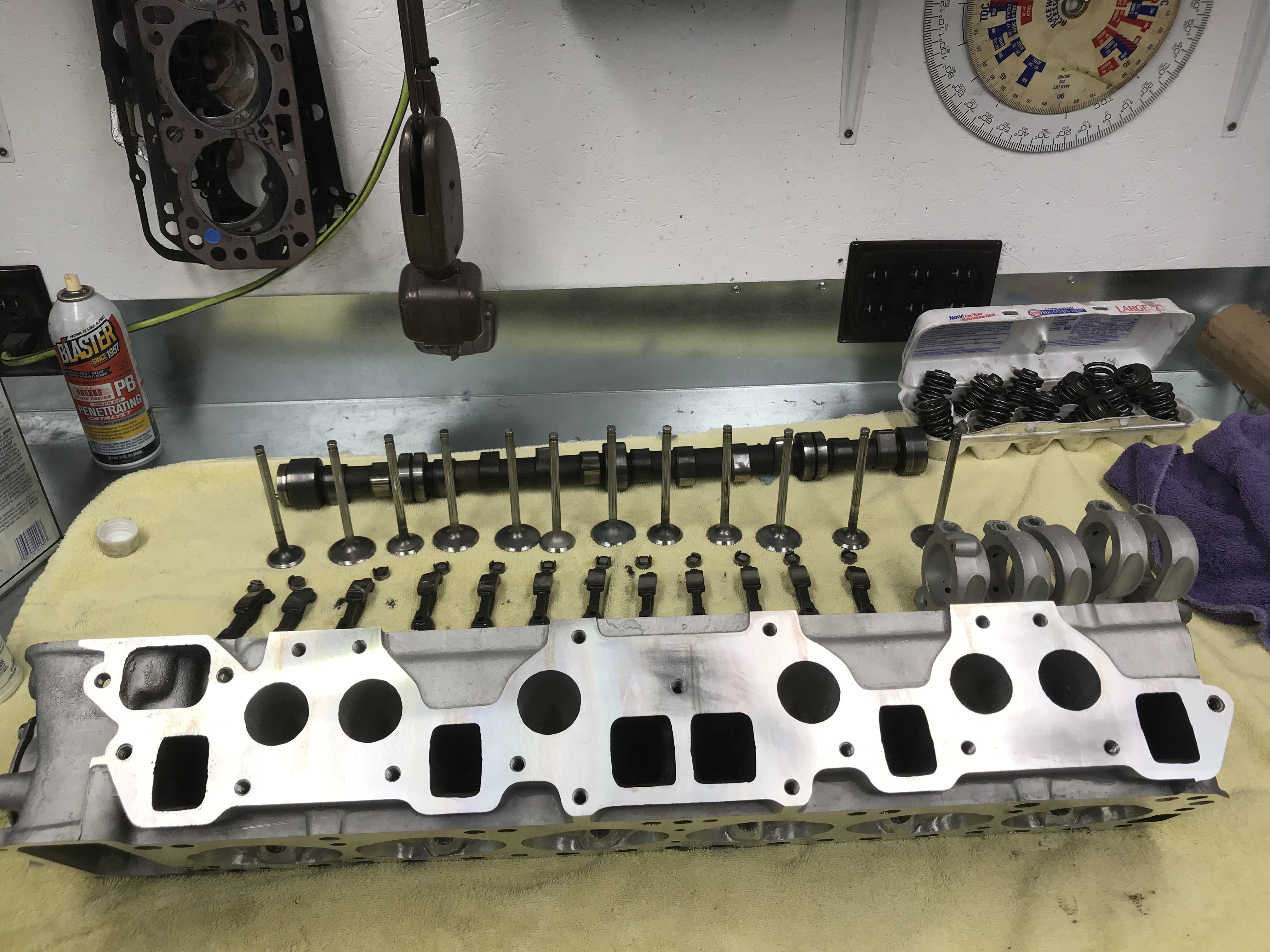

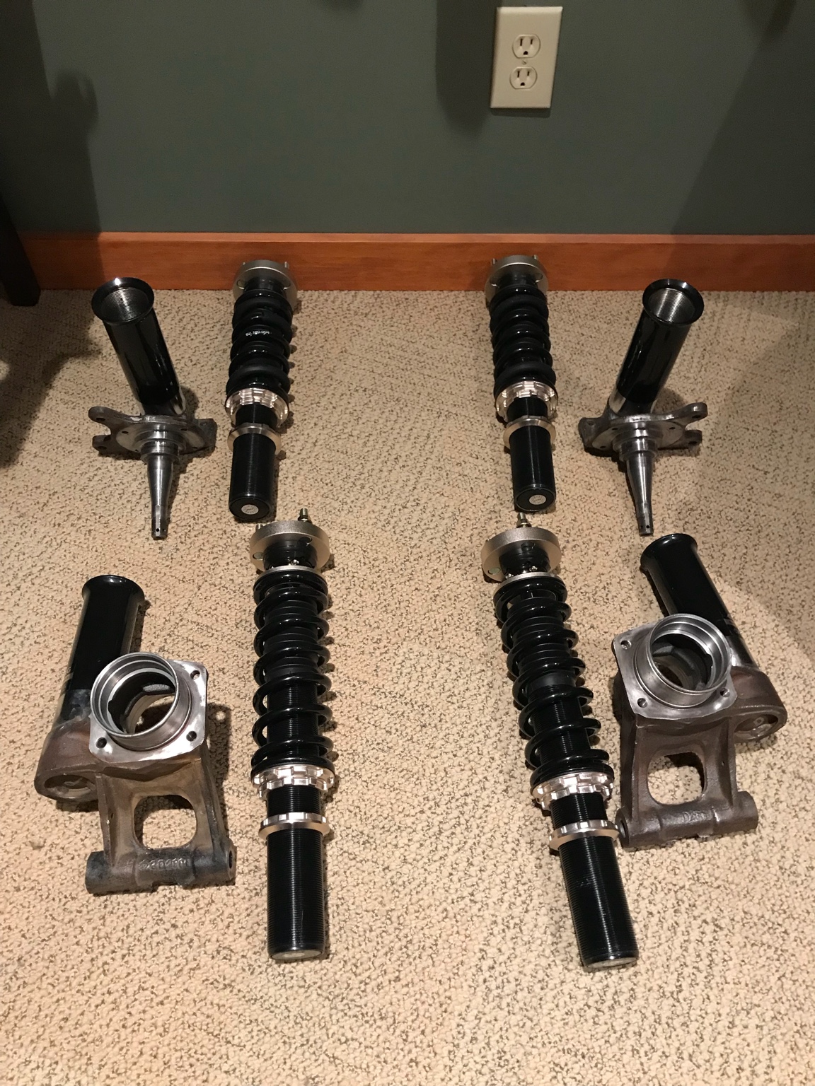

Bought a lot that included triple carbs, coil overs and camber plates, NOS Nissan valve springs, rockers and lash pads, NOS front fender and sugar scoop, engine bearings and rings, rear wheel well repair piece, and two rocker panels.
