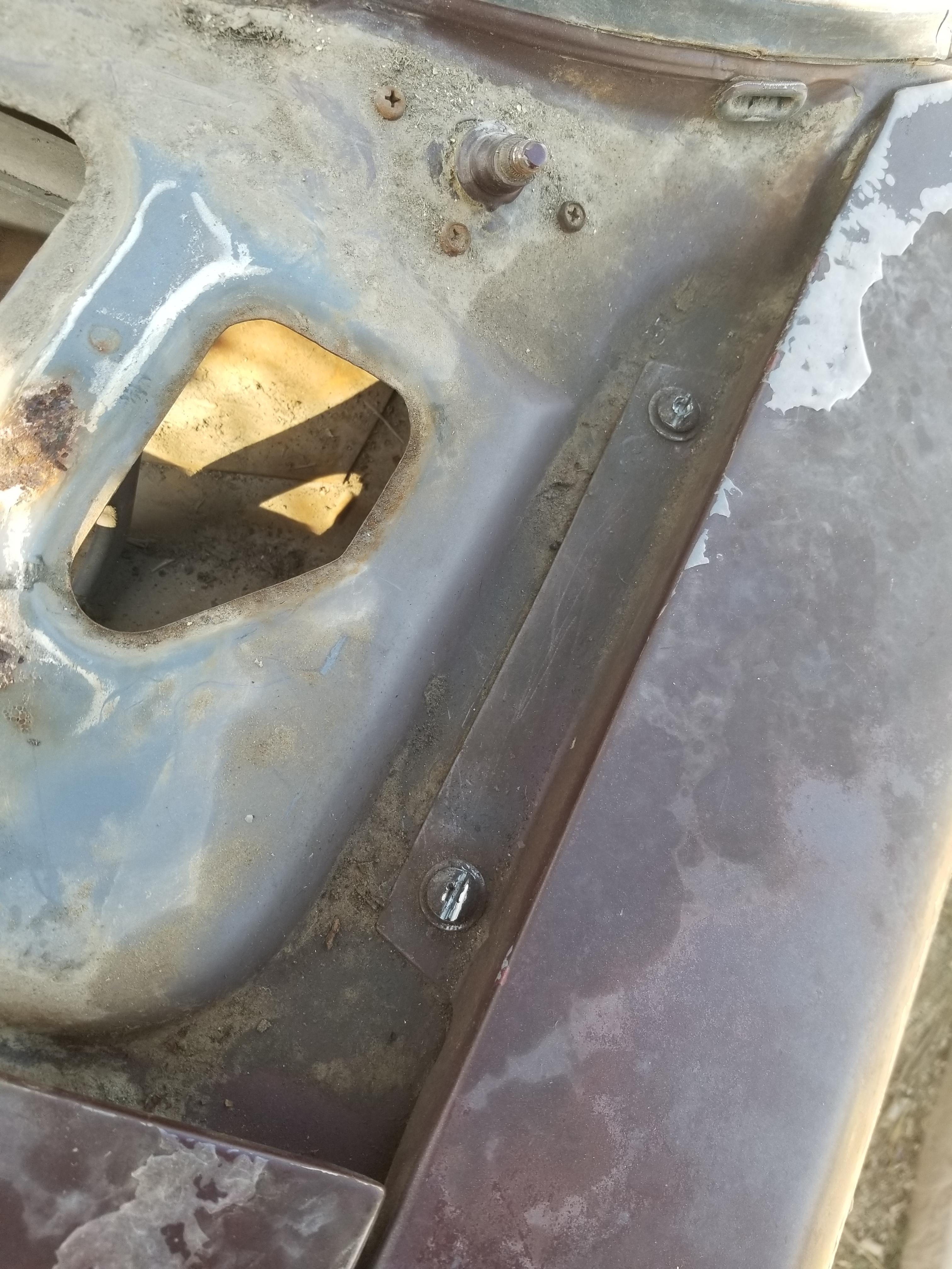

Hey guys so I'm trying to put new doors on my 78' 280z coupe. But I can't because it's hard so Iim trying to remove fenders for Easter task plus I'm restoring it so I'm getting rid of any rust I have so 2 birds one stone but I can't get these two bolts off can someone tell me what I can do I know it has nuts on the bottom but i cant see them and idk what size they could be. This is all stock 280z. Thanks guys this is my first project and one of my bucket list cars so sorry if I'm asking noob questions

As Patcon says, a penetrating oil is best.  WD40 is a light oil for displacing water (WD = Water Displacement).  A penetrating oil has a penetrating fluid that weeps into the threads and carries the oil with it. A 50:50 mix of ATF and Acetone is a good home-brew.   I like Liquid wrench over PB blaster.
If you have a high current/wattage soldering iron you can place it on the head of the bolt and heat it up for 10min then cool with the penetrating oil to break the crusty corrosion.
