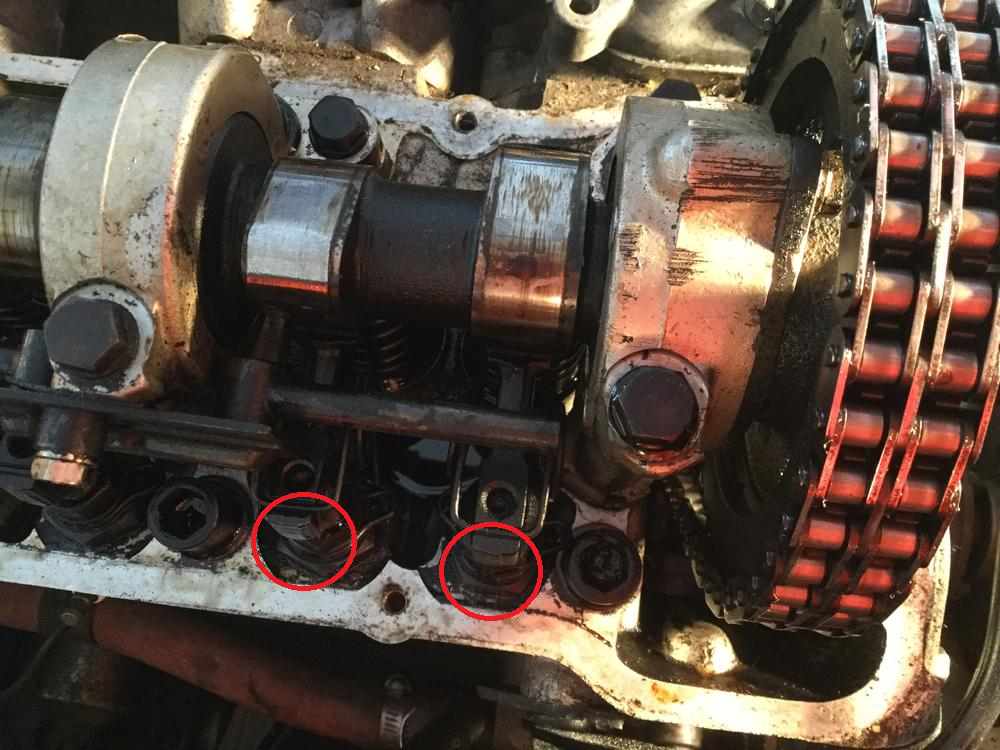

There's so many ways to get TDC it's funny but I'll add my way to make it even funnier.  I used stacked feeler gauges to get the bottom of rockers #1 and #2 to be the exact distance from the top of the head.  Wanted to make one out a spark plug but I never knew how hard it is to cut a spark plug. :D
Same distance where the circles are...
Lots of rounded bolt head edges on that head, and the cam lobes look painfully dry and crudded up.  The valve seals and stems can't be better.  wouldn't be a surprise if a valve was sticking a little, delayed closing maybe.  Or a cam lobe is on its way out.
A picture of the whole head would be interesting and some close ups of the other cam lobes.

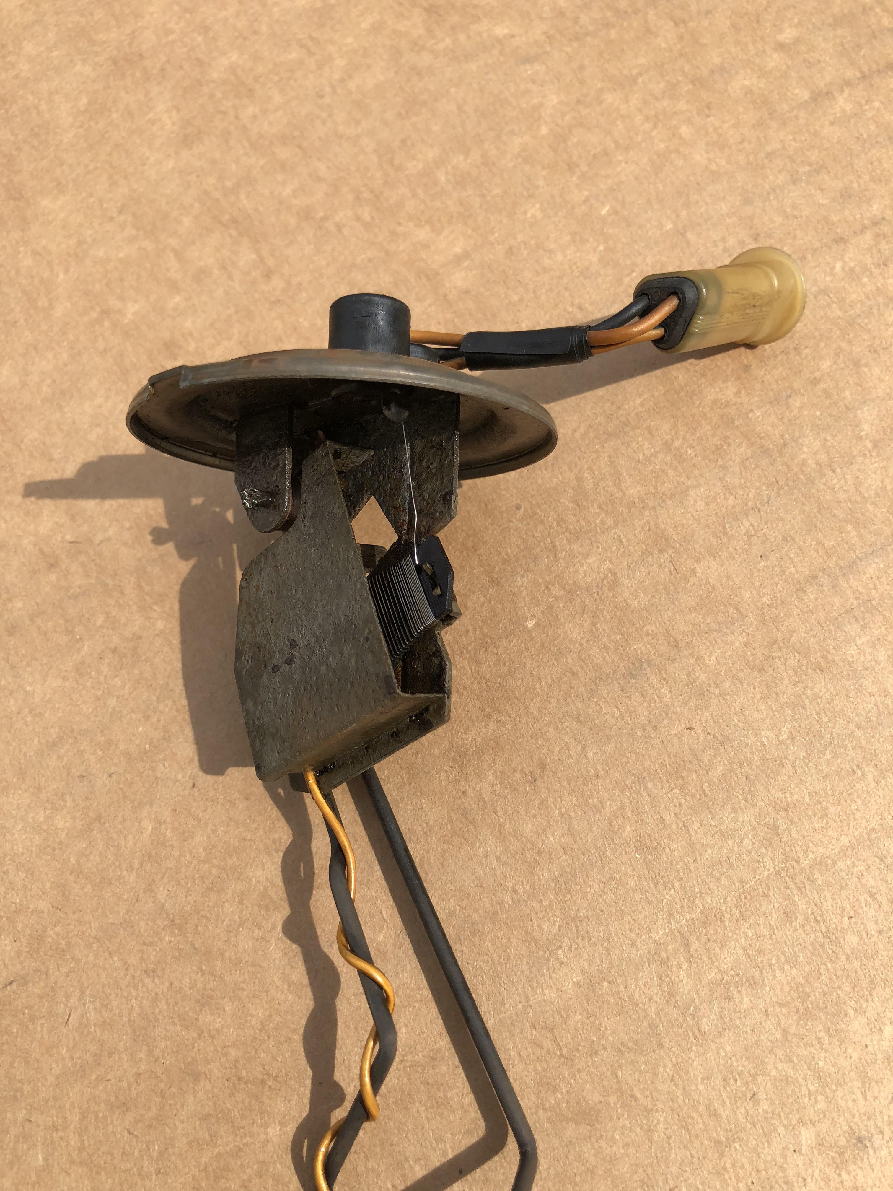

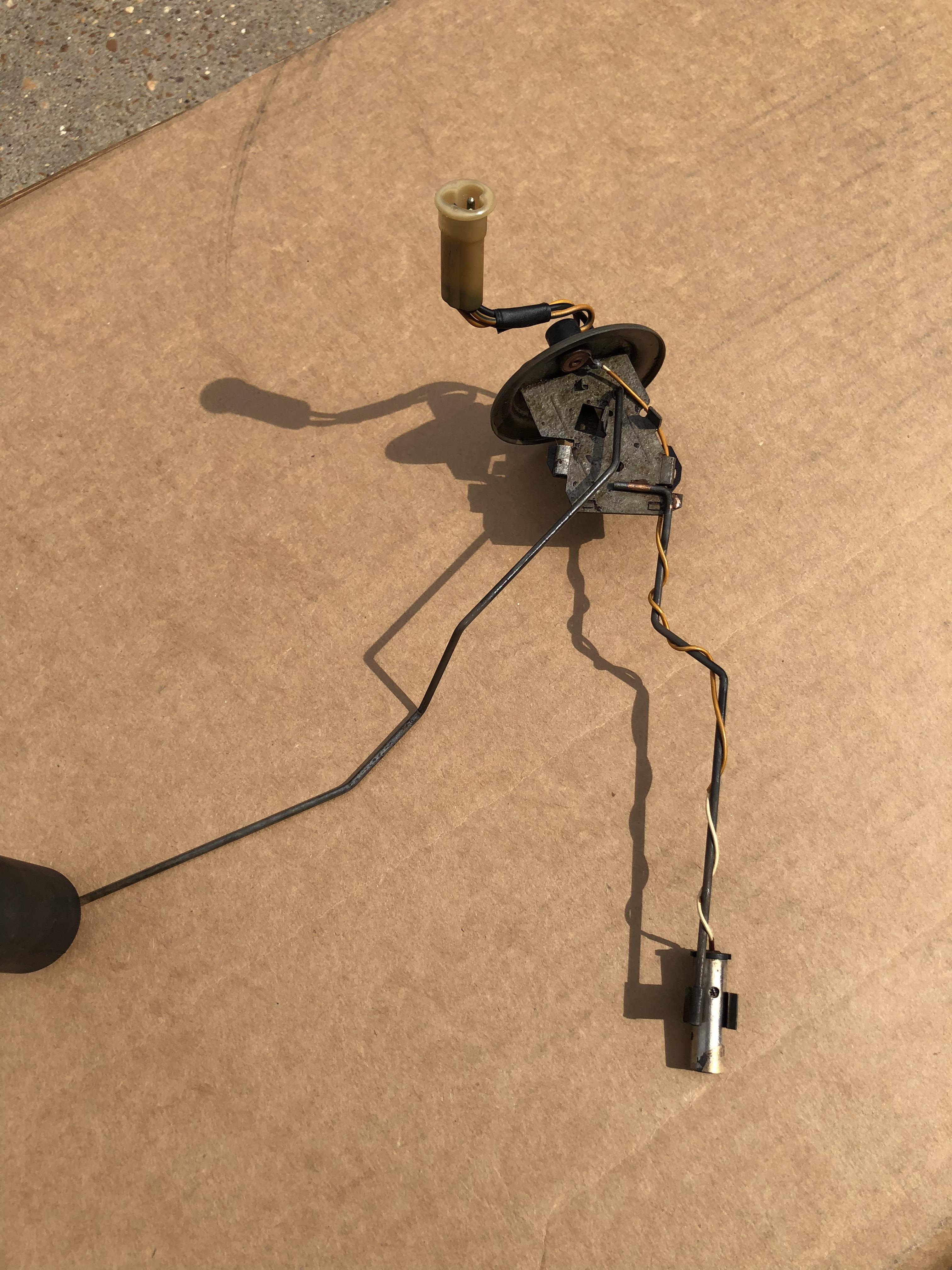

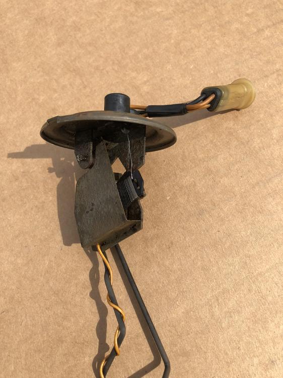

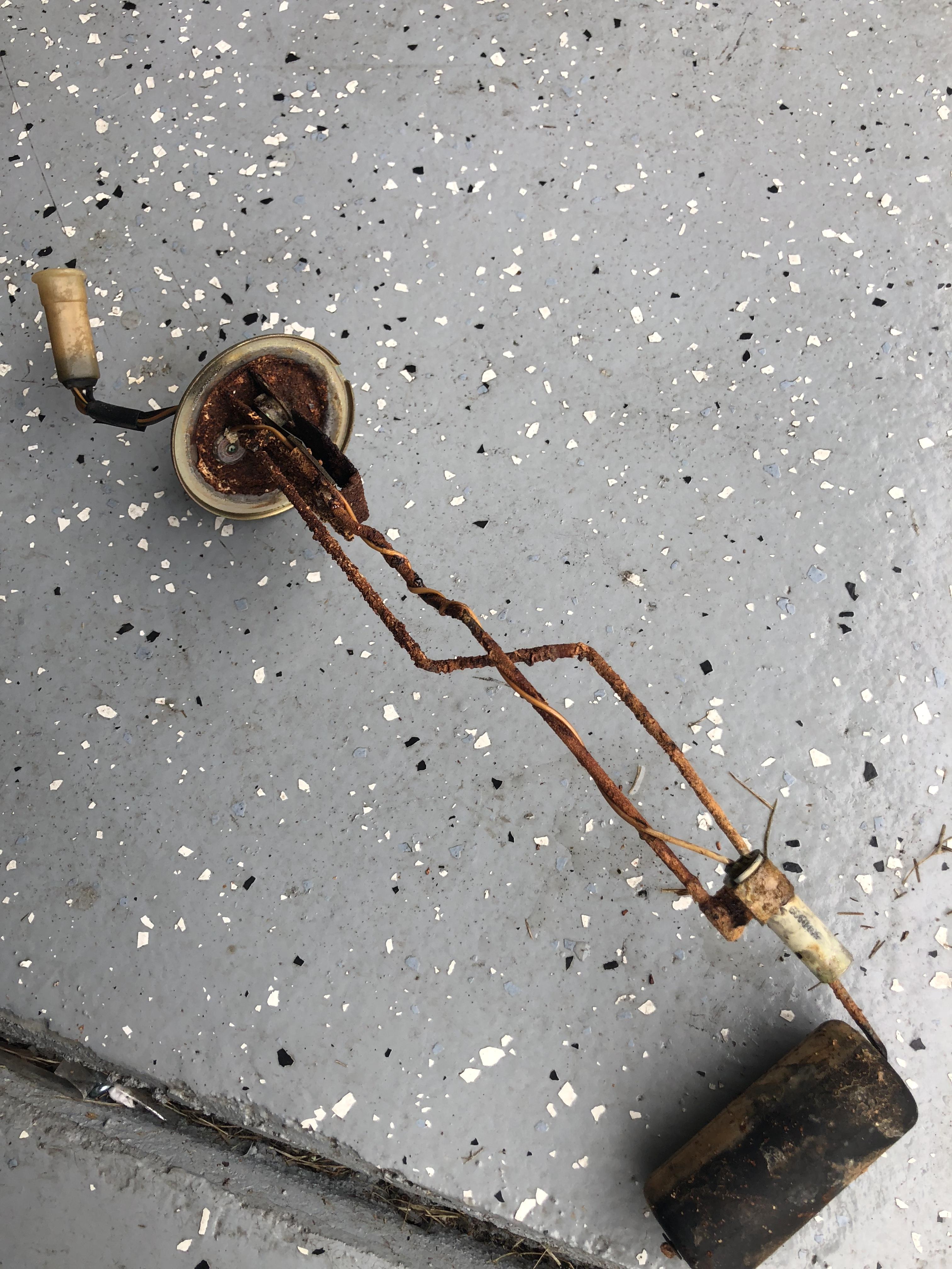

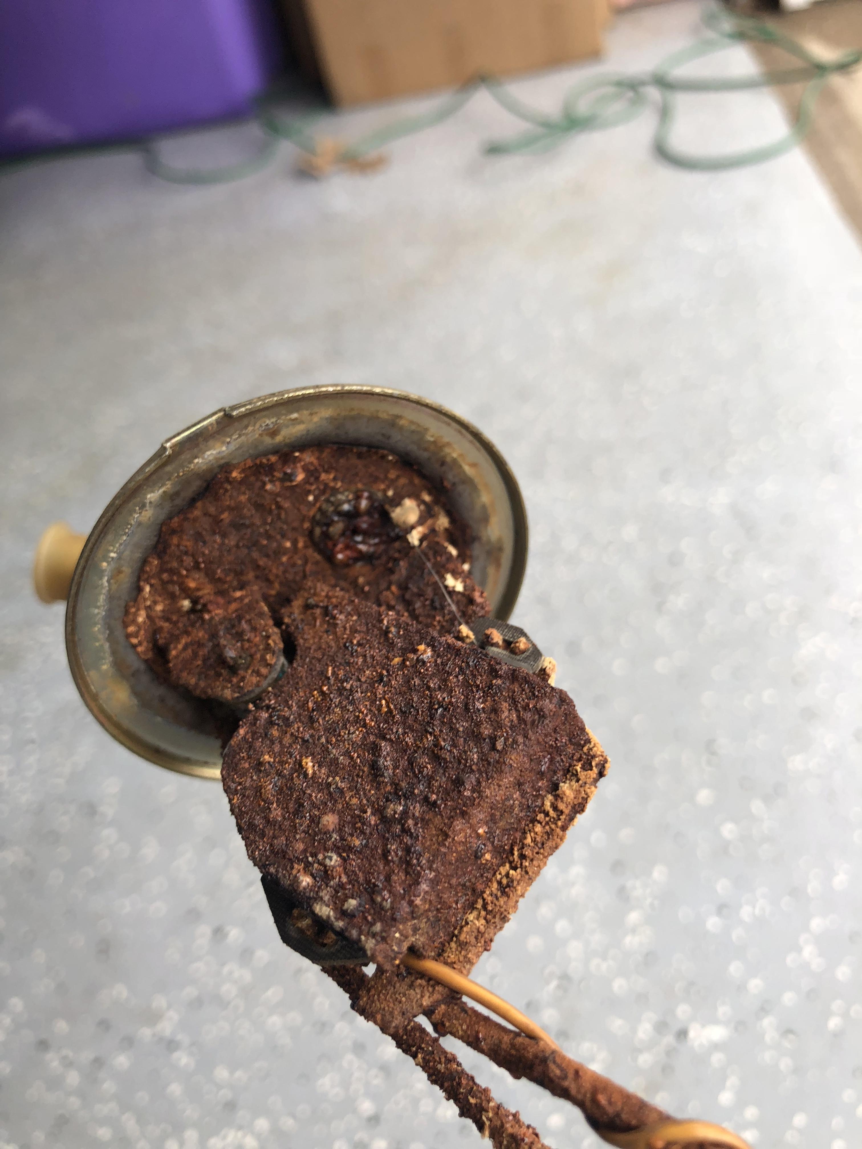

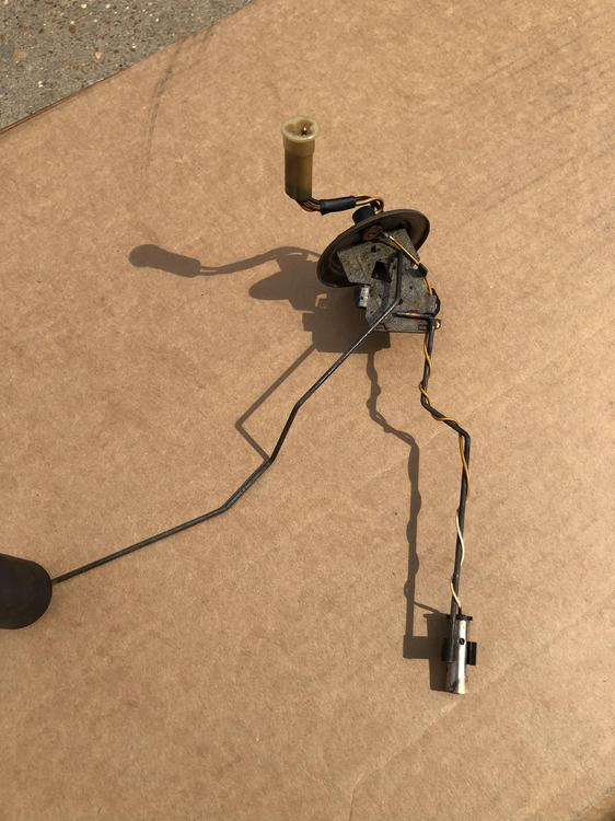

Of note my fuel sending unit looked like crap when I pulled the gas tank.  Totally covered with rust, but still moved.  Companies online wanted around $200 to rebuild it, so I did it myself.  Check out the before and after photos.  I checked the resistance and it went from around 17 to 85 ohms from empty to full.  I let it sit is a bath of muriatic acid mixed 5 to 1 with water for about 30 mins.  Then hit it with WD-40 and plastic brush. Looks great now.
make very sure the muriatic acid is fully neutralized, it will corrode horribly if not. I have used muriatic acid to remove rust before on steel, the  problem is it seems to get into the very pores of the metal, and stays trapped there, causing the corrosion. Keep an eye on that sending unit. See if it looks ok after a day or two. I would have recommended using a less aggressive approach (after what happened to me) but since you have already done it, maybe soaking in a baking soda bath overnight may be something to consider.
I just re read your post, I don't recall the mix I used that had the problem, perhaps your 20% solution will not have the same effects I battled.
