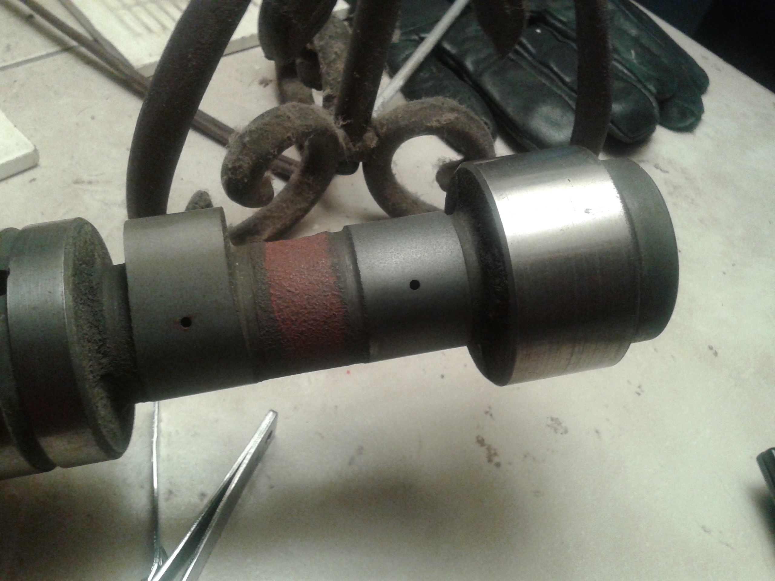

I saw the too big blob also and wondered.  Notice though, and I've wondered about this in the past, how five holes in your picture are lined up, except the second one doesn't have a hole.  The're not in the same spot on every lobe, relative to the ramp, they are in a line so that they can be drilled efficiently.  The second one is on the ramp so they didn't drill it.  So, if there was a hole in the #1 lobe I'd expect it to be on the other side so that the next three can be drilled, off the ramps.
Your picture looks way too clean.  It's unnatural.  But there is a lot of oil, as there should be.
I photoshopped it! :P
That's a freshly machine shop worked N42 before I ever put it in my '77.  ran the oil pump with a drill to prime all the oil lines, brand new VR1 too.
