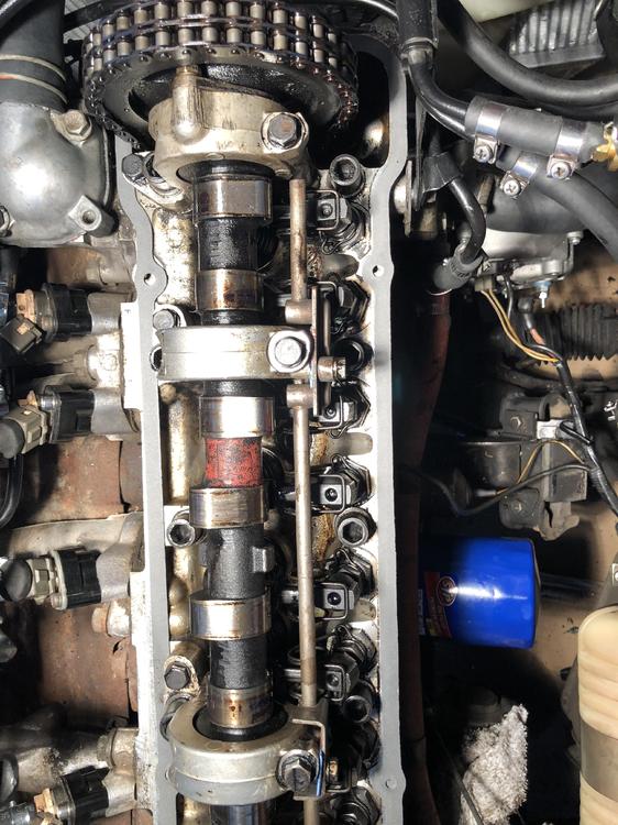

Okay I spent the last 2 hrs cleaning the head and valve cover where it had caked oil everywhere.  It’s not perfect but I got most of the debris that I feel confident nothing is going to get stuck in a valve or spring.  Added assembly lube to the cam lobes.  Spray bar is cleaned out and installed with homemade gaskets The dizzy is back and all hooked up.  Whew....

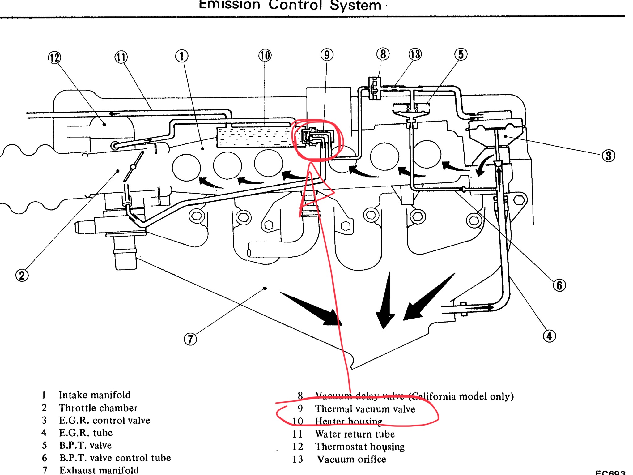

Moving back to this thread for a question.  As I was tracking down misc hoses disconnected And looking through the FSM i found where two of my emmisions/ vacuum hoses belong.  They go to this thing called the Thermal Vacuum Valve.  It appears the plastic connection to mine are broken off.  See attached photo.  My car is a CA model.  What is the function of this thing and do i need it connected?  My assumption is Yes but wanted to ask before spending more $$.
I think I would plug these two hoses.  I removed all that stuff and put an N42 intake manifold on mine.  In the end I just had to plug the one at the throttle plate, lower left in the photo.
If I remember right it sits on top of the heating plate that connects to the thermostat housing and connects to BPT valve, whatever that is/was.

all kinds of opinions here. I am not qualified to answer other than to say what I have read indicates deleting it has no real performance advantage at full throttle (contrary opinions exist of course). Some say it will benefit the gas mileage at partial throttle, Seems the main thing it is designed for is to lower the combustion temps to reduce the creation oxides of nitrogen (key to making smog). I geek out over trying to respect the original design so tend to go that direction. I have it and AFAIK its not a problem. A recent trip returned 25mpg at mostly 70-80  mph. The main thing is to make sure the EGR valve is clean and fully closed at idle to prevent an leak of gas into the intake that would cause a rough idle. Easy to test just lift up the diaphragm of the actuator while idling. It will run rough, release and it should settle right back down.
For me the idea of lowering combustion temps was the ticket, I like that. I don't have a lead foot and tend to take it easy mostly very short trips and the occasional long trip. It is one more thing to go wrong, but its not very complicated so not hard to service and have working right.
