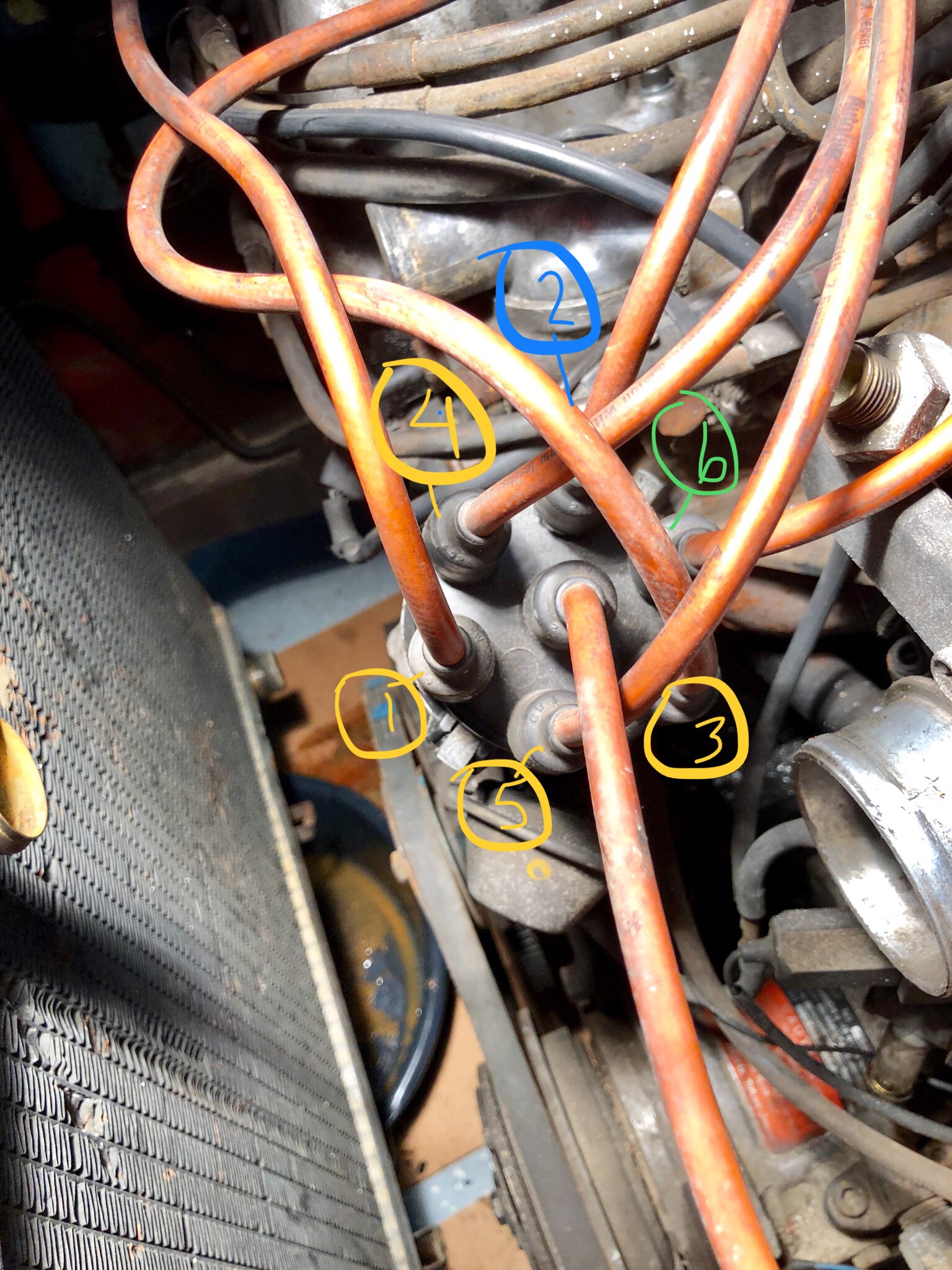

BTW, the spark plug wires were off plugs when I got the car  How do I know which plug goes to the corrrct spark plug?  I’m not 100% sure they’re correct right now.

Firing order, 153624, counter clockwise.  Spark plug go #1 closest to the radiator through #6 in order, next to the firewall at the windshield.
#1 at the front of the motor, number 6 at the rear.  1,2,3,4,5,6

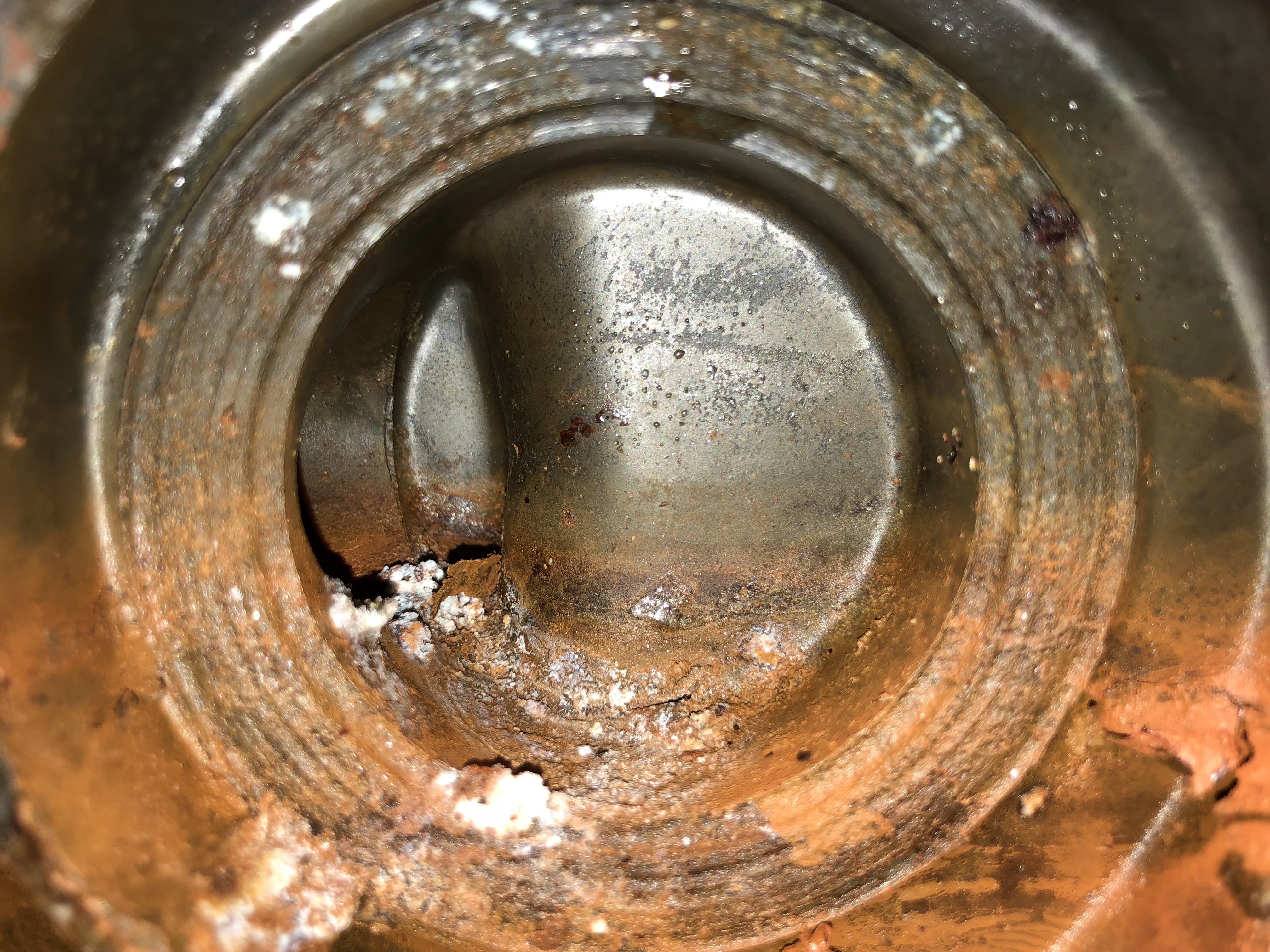

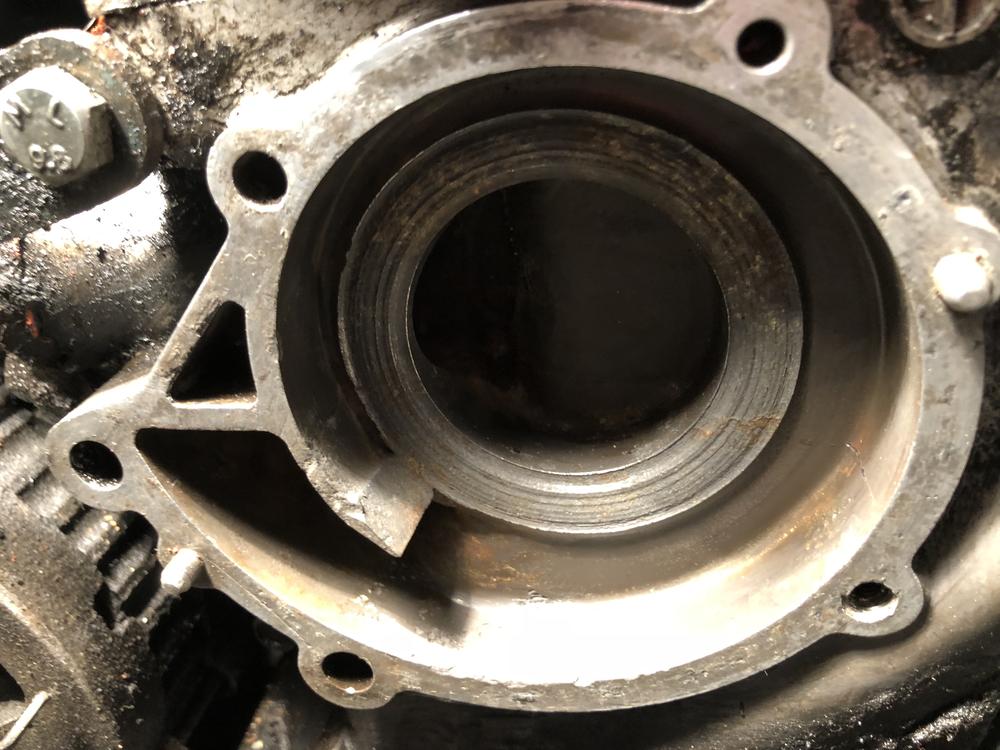

922C1263-9A30-45B2-9CAF-529DC13B2151.jpeg922C1263-9A30-45B2-9CAF-529DC13B2151.jpegSweet, I’m on it and proceeding as directed.  Will report back later.  Just got the water pump off....what a mess in there. Check out the before and after I clean it up pics.    I’m now pulling the radiator and taking it to a shop to have the cleaned and tested.

Looks good to me.  There's a raised mark on #1 of the cap. But that front clip is also a good marker.
Sometimes people move them around to adjust for the distributors drive spindle being off a tooth or two. But if you had someone not familiar with the Zs firing order they will use a straight six ford or chevy order.  My Dad LOL
You can pull the cap, with the timing mark on ~10 degrees on the #1 firing stroke, and see if the rotor is pointing at the #1 wire.
