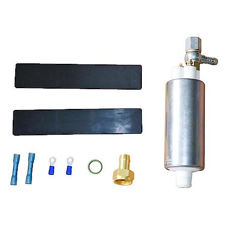

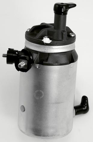

Question.....I can buy a OEM style which are in the $300 ball park range or get a different looking non-OEM from a box auto store for $99?   Here are the difference in the looks of those pumps.B96C4A74-73FB-4D4F-B50F-5F93B8C4E439.jpeg

Blue's tech tips show how to clean/rebuild the OE Bosch,  the $300 one.  Maybe your's can be saved?  I bought one of the last ones advance auto had about 6 years ago, $256.

I think the high dollar pumps are made by Borg Warner now???
A lot of folks run the cheaper pumps without any issue except mounting.  I think you have to use rubber to compensate the difference in size for the mounting.  They're a little louder too from what I've read but who cares, you'll have a header and 2.5" exhaust soon. LOL

The fuel pump rebuild was not what I thought but you may see/read something that'll help.  I bought a new one just because.  Didn't need it but I'd rather have new than get stuck on the side of the road.  I can pressure test it and maybe consider selling it?  I'd have to dig it out of my storage building and figure out a price, no guarantees on the reliability though, it was on the car when I bought it.  Bosch ones I think go to 50 psi without a fuel pressure regulator.  If it goes that high i think it would be okay if your interested, I like new stuff myself.  I am a worrier not a warrior. :D
http://atlanticz.ca/zclub/techtips/fuelpump/index.html

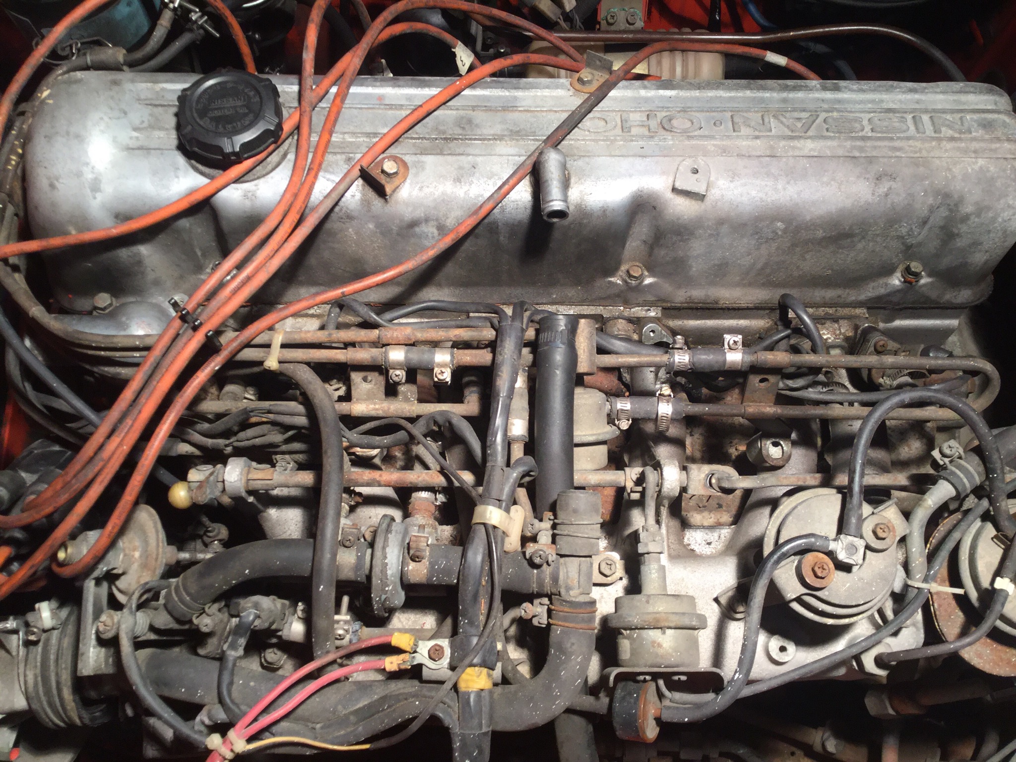

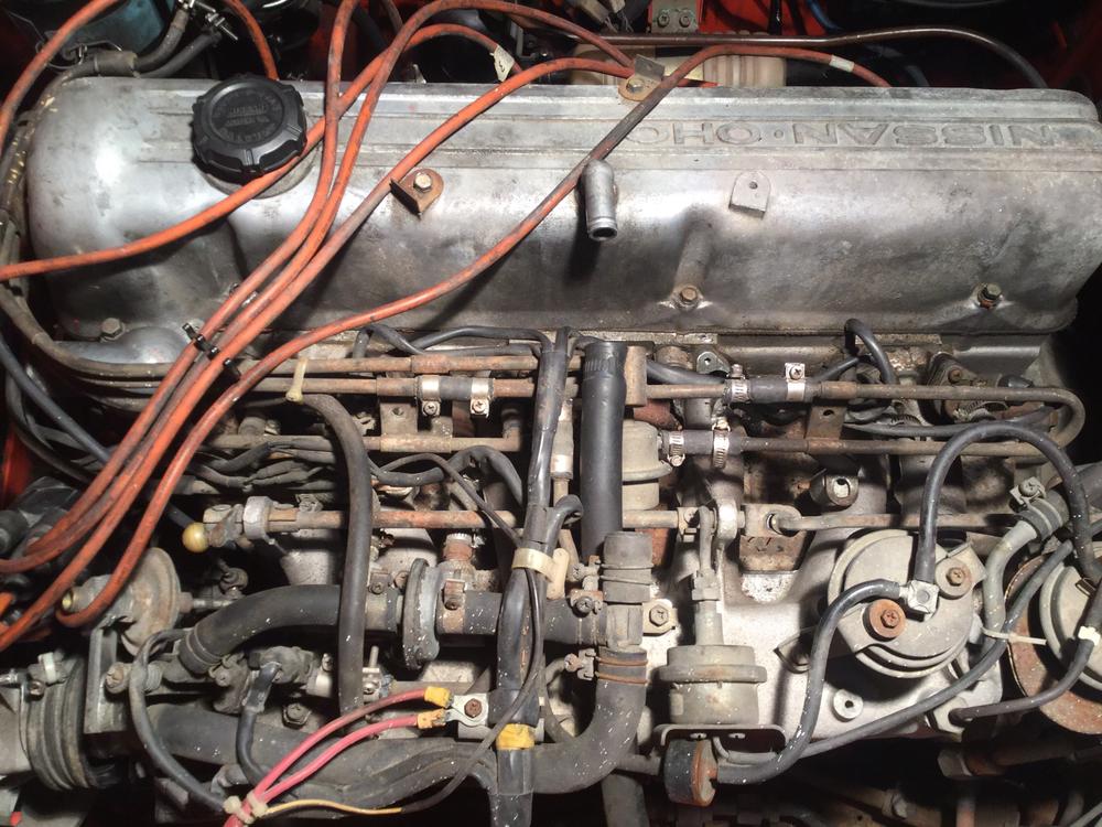

I'd get that N42 head and the N42 intake and delete all the EGR stuff.  I have a funky N47 intake with the beginning of the EGR era, it has the mount but no EGR tunnel underneath connecting to the runners to the intake ports.  I put a block off plate on there just to keep crap from getting down in the hole.
Edited by siteunseen
That engine looks clean.  Mine....not so much. Good advice,  I’ll  call that yard have them pull it.  Is it compatible with everything other than the intake I have.  I know they changed pistons thoughout  the 280z Years.
