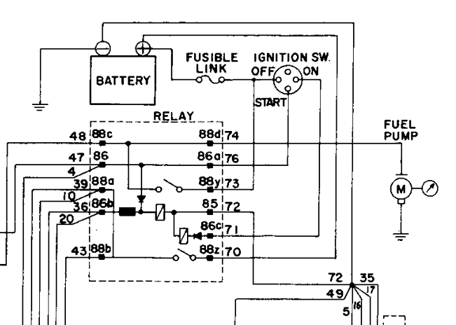

The 280 fuel injection relay schematic shows  a resistor connected to relay pin 86b.  This pin connects to the Air Flow meter fuel pump switch  and the ECU pin 20.
Does anyone know the value of this resistor?

Not sure it's hugely critical.  It just needs to pass enough current to close the fuel pump relay.  Pin 36 is power back  (to ground) from pin 39 through the fuel pump relay contact switch, if I read the diagram right.  Not an electrics guy but the relay coils usually have about 50-60 ohms resistance.  I think that they pull about about 0.3 amps.  Just working from memory on past current draw problems, through relays.  That combined relay is a weird mamajama.
After hurting my brain looking at it I decided that I don't even know why that black rectangle is there.  Seriously, why is it there.  The relay coil provides resistance.  Beside that, I think that somebody would have to disassemble a relay to measure its resistance.  I'm assuming the black rectangle is what you're talking about.

In some of the drawings in the EFI Bible it is shown as a resistor.  I was assuming that it was there as a current limit for the switch in the air flow meter or ECU.  I'm not sure if it is a real resistor or not, may be time to do some experimenting.

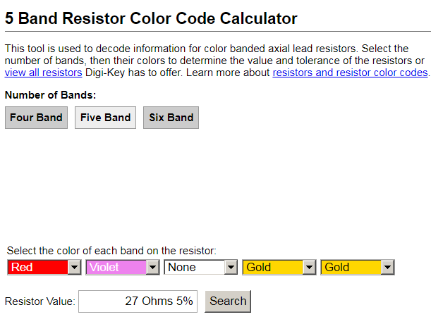

Did you add an extra "0" by accident?  I got a different number.  If I go with a four band the number gets even smaller.
So, with a more time for the subconscious to think, I'm thinking the resistor is to reduce sparking at the fuel pump relay switch contacts in the AFM.  They are so tiny.

As for the purpose... I wasn't there when they designed the thing, but (again if I had to guess), I would theorize the reason the resistor exists is to take advantage of the fact that the "hold" current for the relay magnet is lower than the "pull-in" current. The initial pull in is a straight connection to system voltage through the ignition switch, but once the relay has pulled in and the engine has started, the AFM switch wouldn't need to handle as much current to keep it closed.

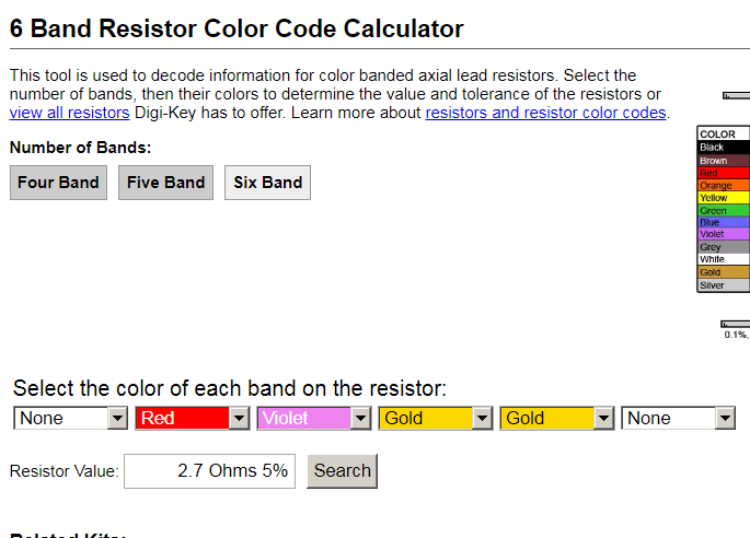

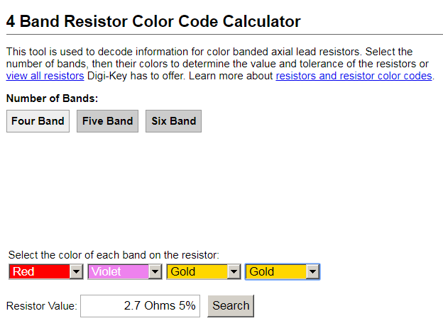

The colors are definitely red, violet, gold, gold.  Seems like a pretty big gap between 2 and 3.  That's why I picked "none" in a 5 band.  But, apparently, the bands start and end on the bumps at the ends of the resistor.  I'm learning.  So, pick 4 or pick 6 and you get the same 2.7.
