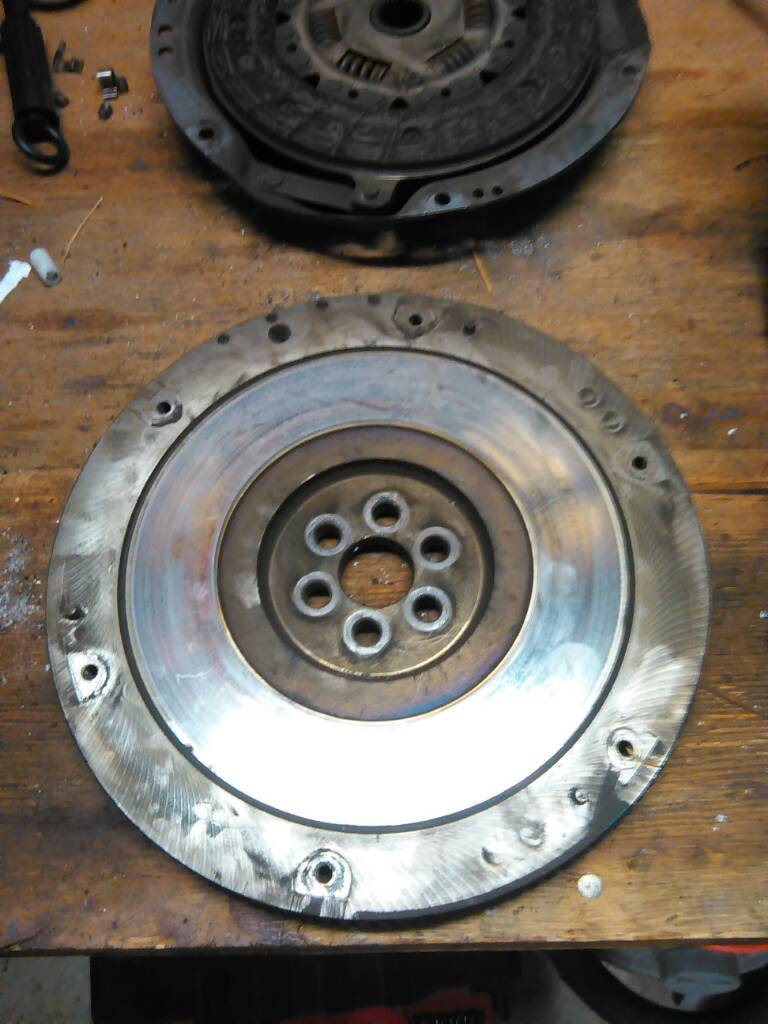

That's all very informative. The machine shop who milled the surfaces on my head and exhaust/intake manifolds can probably take it down to 15 or so. Saving me some money in the process too.
Like the OP in the thread link, I was also considering exhaust, except I'm looking at MSA from the cat back.
All in it would be roughly 800$ for clutch/flywheel.
Machining the stock flywheel would free up some funds to get that exhaust note I've always wanted.

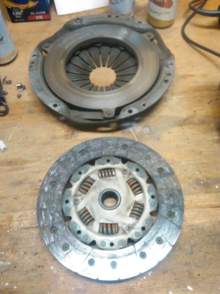

Oddly, I went and turned the switch that stops the clutch pedal back a few turns, went on the same test drive and couldn't get it to slip.
I'm going to pull up the FSM as soon as I can get the kid off the computer from watching princess shows and read about the proper way to adjust the pedal.
It didn't seem necessary because I only replaced the master/slave..not the clutch.
But maybe the dimensions of the new parts are somehow different, causing the clutch to not fully engage.
Not sure how heat had anything to do with it, but there is probably a good explanation.

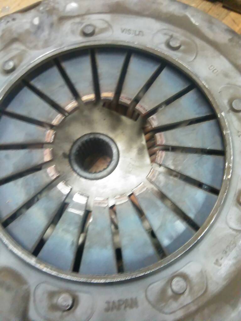

Isn't the brand name stamped on the pressure plate?  I see a Japan there.  I think see Unisia maybe.  I have a clutch disc with Atsugi on it.  They're suppliers to Nissan.
http://www.carparts.com/atsugi-unisia-paraut
It has Visun stamped on it. I googled it and the only related topic it brought up was a Nissan Silvia forum, but no site for a manufacturer.
Sent from my [device_name] using http://Classic Zcar Club mobile
Edit: Visiun brand.
