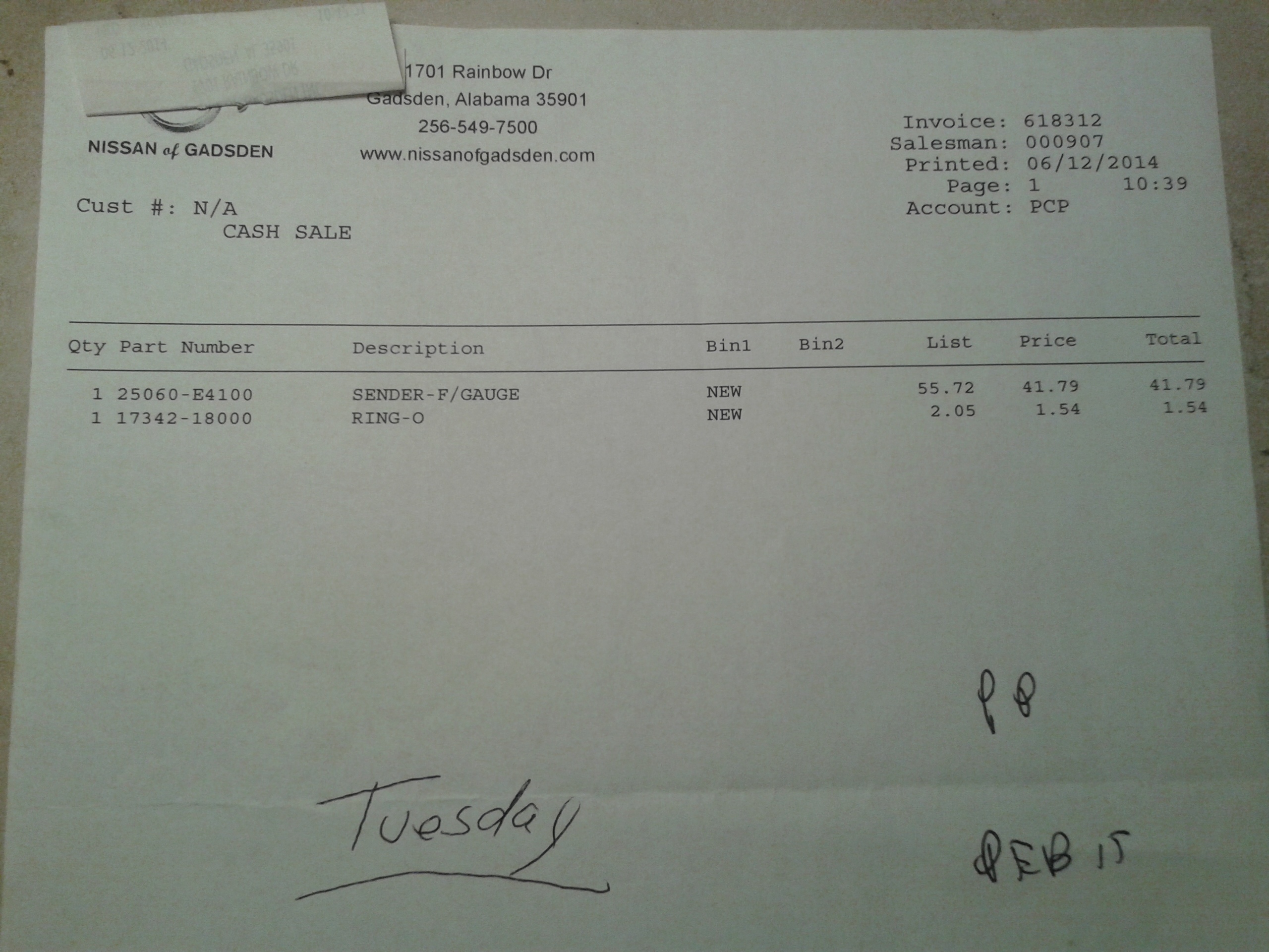

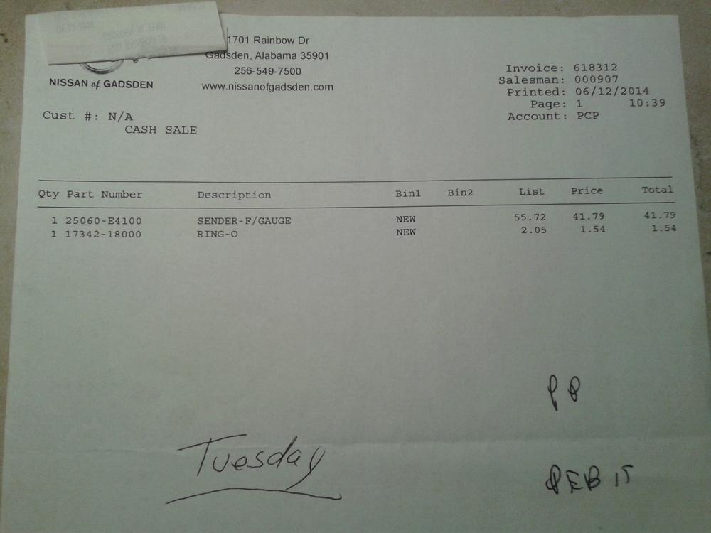

Thanks I'll call my local nissan dealer next week, lets see.
Than at least the gauge is working - the lamp is not sooo important. As the sender is mounted in the top of the fuel tank in a 78 280z its easy to mess around with it on a later state anyway ;)
