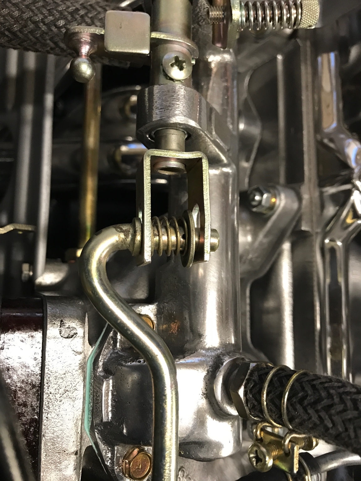

If you are asking how the spring and washer go. The cotter pin goes on the outside( non spring) side of the washer, you have to compress the spring to install the cotter pin. The hooked rod is in the correct position.
