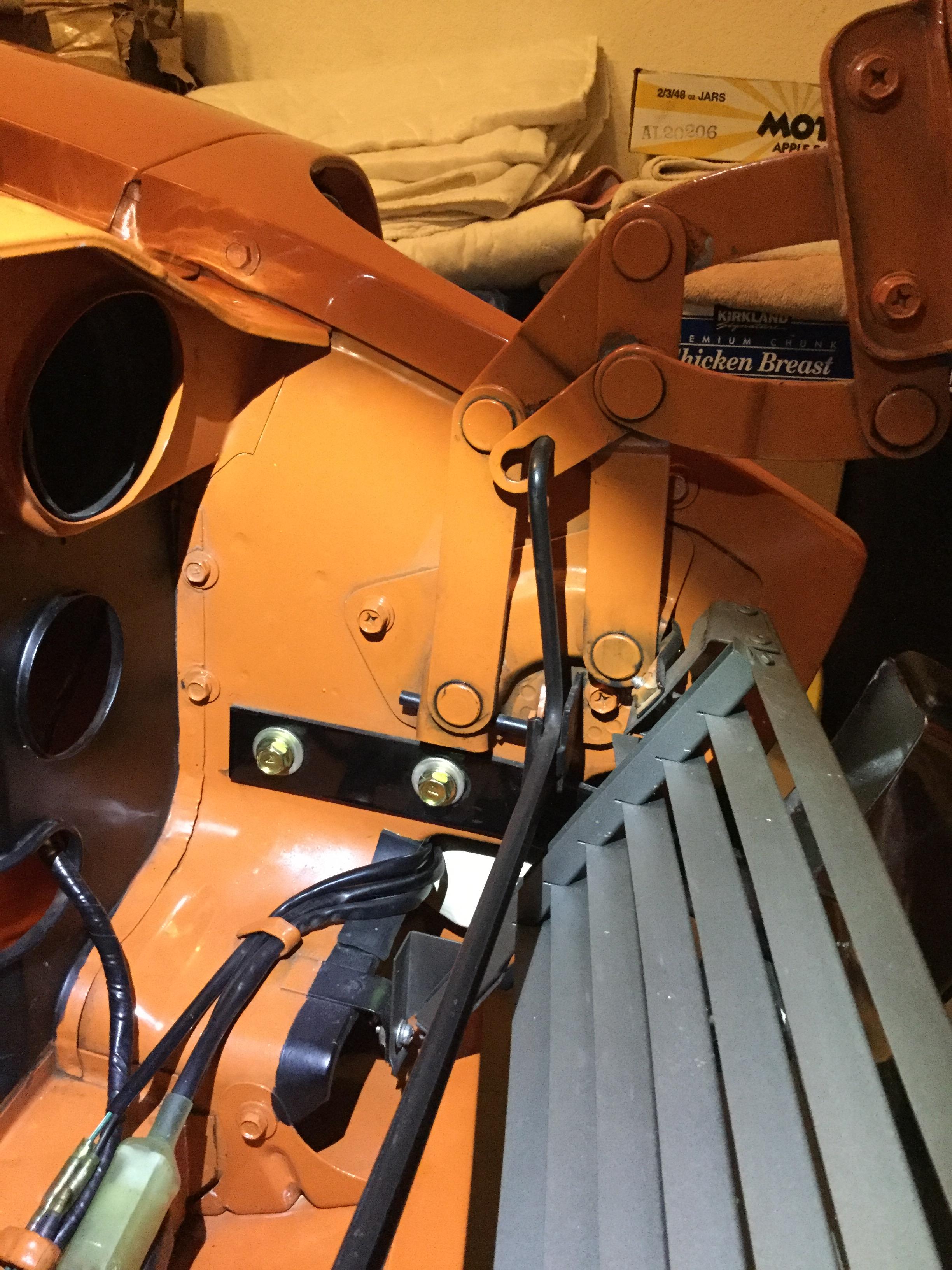

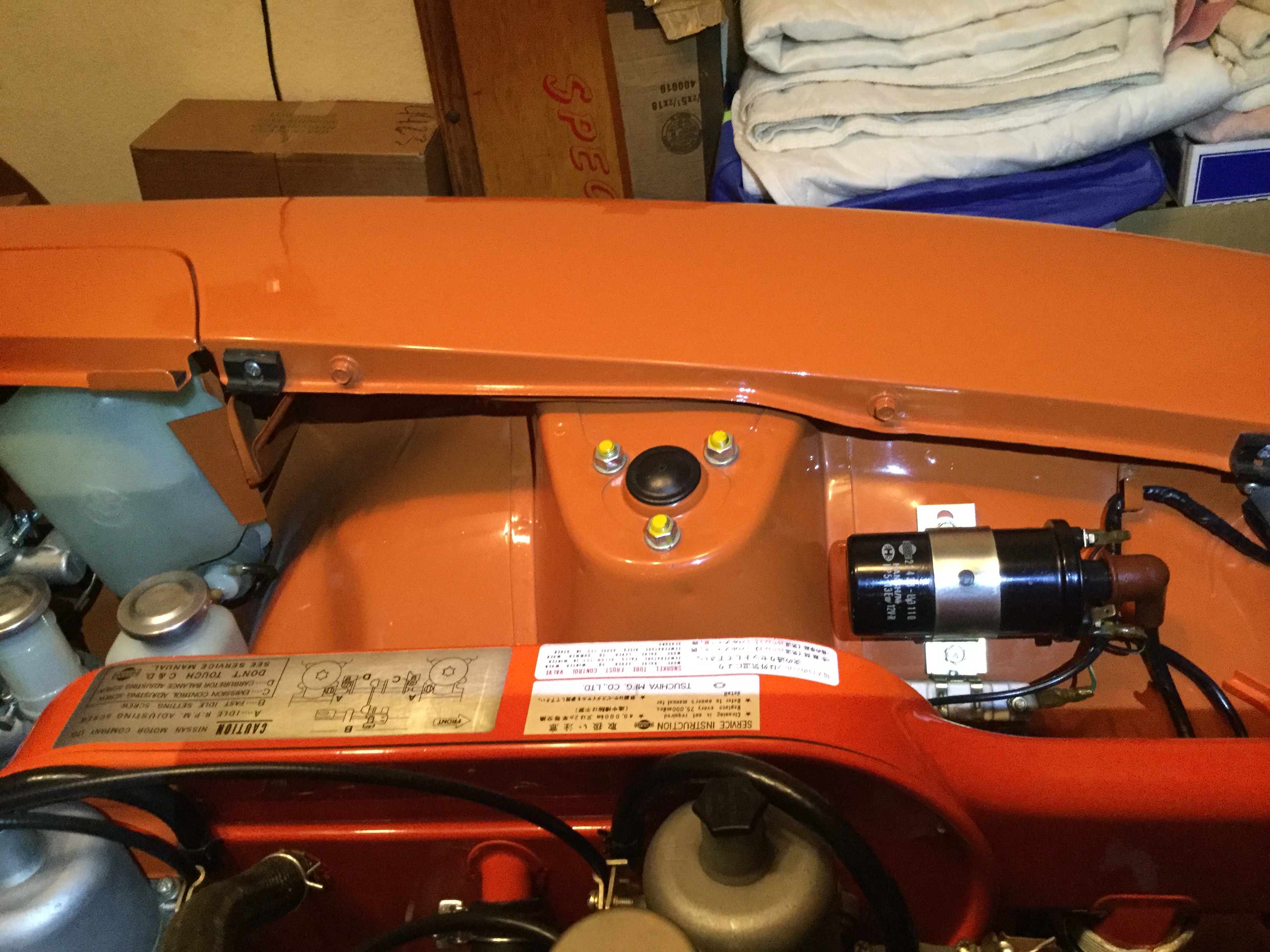

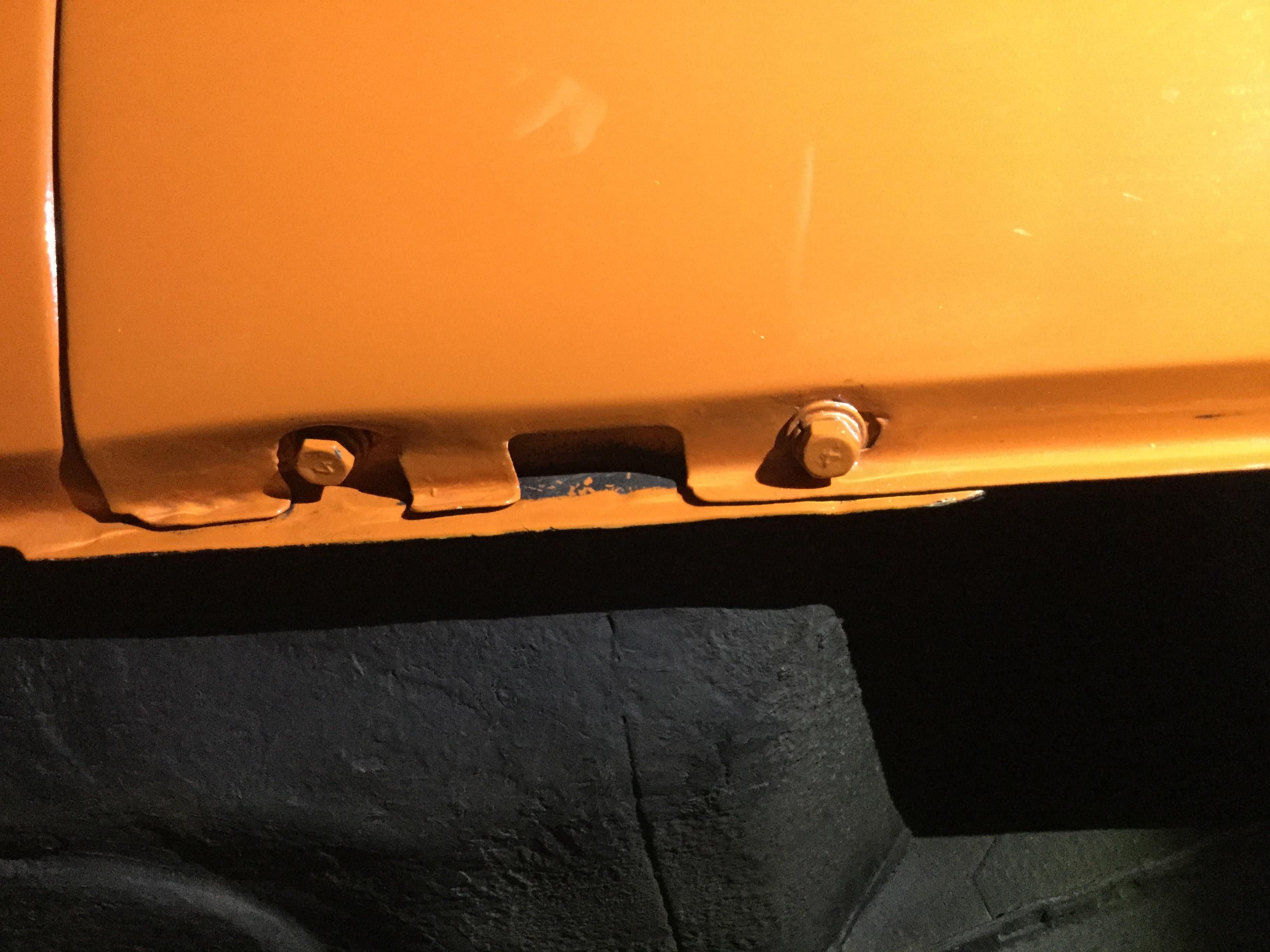

Gary  those fender fasteners between fender and hood were painted.
The bolts fastening the bottom of the fenders at the pitch welds
just behind the front wheel wells were painted.
the 4 fasteners on the front of the radiator support fastening the edges
to the inner fender are painted.
All of the other fasteners you mentioned are correct.
Let me know if more pics would help.
Dan
