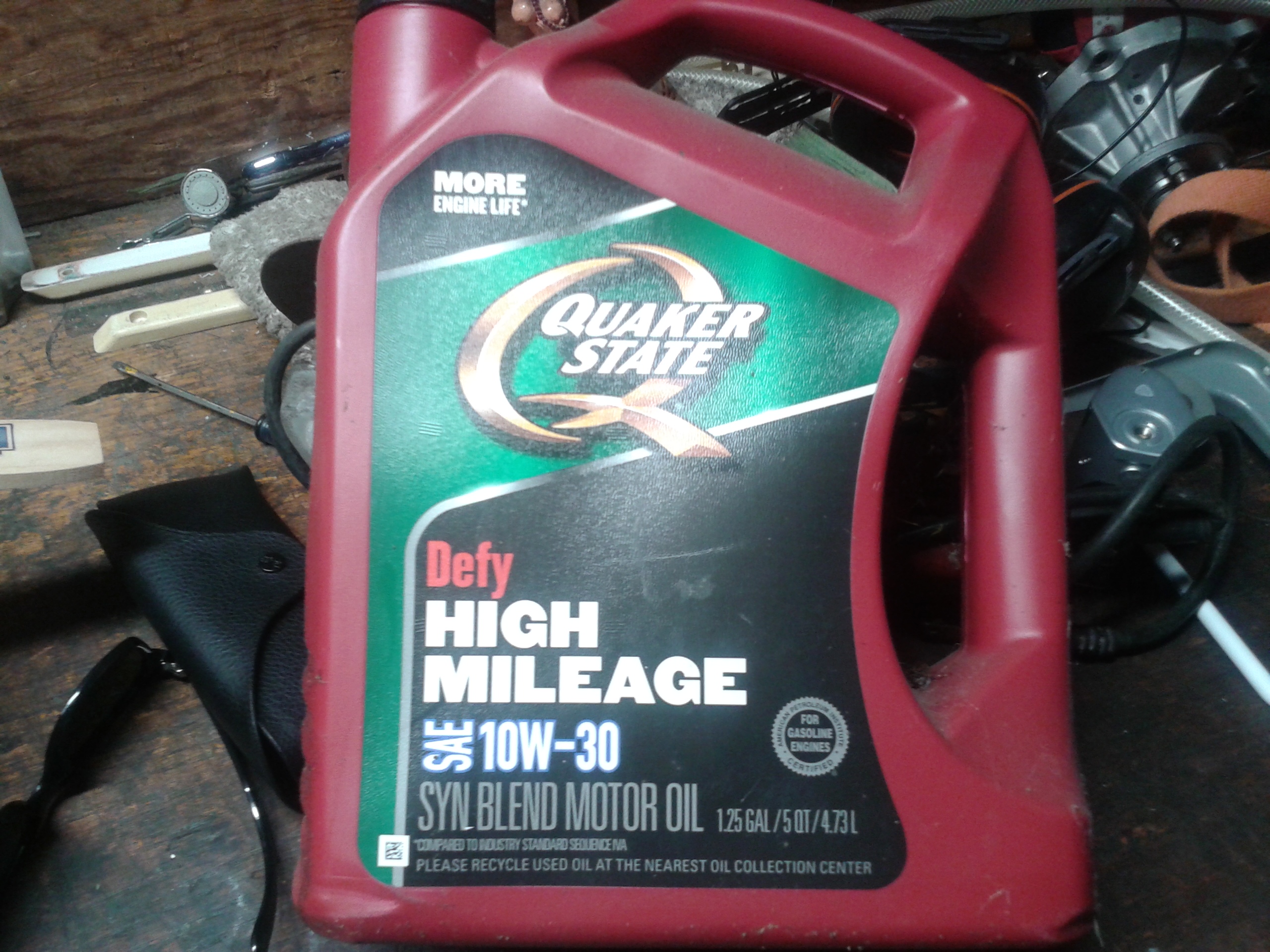

I use to use the defy but no longer able to get it .so I looked on the quaker state site and no longer made. that is what led me to the rotella t4 oil. I believe the quaker state high mileage oil is what replaced it and when I called them I think if I remember right the zinc was about 800ppms.
