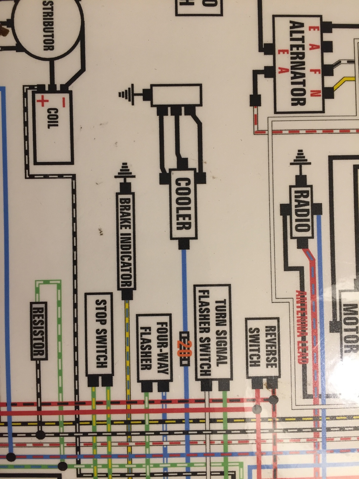

The unidentified 3 pin connection that only has two wire has a red wire and blue/white wire
The unidentified blue wire is solid
The not sure red wire is solid and like a 12 gauge abit thicker than the other leads. IMG_4803.JPG

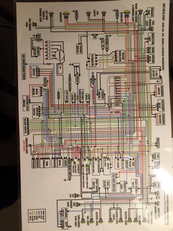

I would test continuity from the "no idea" wires to the pins on the other ends of the harness.  It's all right there in front of you in the big red picture, not hidden inside the dash.  They probably go to the blower or the switch and that will tell something.
To two biggest questions I have on this is the blue lead off the harness by the console. Was hoping someone knew where that went. I would agree that it appears to be a accessory power. I think I may have figured out the two pin connection. I think it went to my old automatic lever.

Behind my heater/radio console i have a blue/white wire with a fuse holder labeled as a AC lead. Past the fuse holder the wire ends at a female lead. That would allow you to connect the wire you identified in the picture and because you said it was an AC car that would make some sense to me.
Just a guess. I can send photo is needed.

Joe Behind my heater/radio console i have a blue/white wire with a fuse holder labeled as a AC lead. Past the fuse holder the wire ends at a female lead. That would allow you to connect the wire you identified in the picture and because you said it was an AC car that would make some sense to me.  Just a guess. I can send photo is needed.
So found why I marked it a AC (Cooler) here a wiring diagram I used when doing my dash. IMG_5611.thumb.JPG.c82486734c331b99a716446afee34f66.JPGIMG_5611.thumb.JPG.064a1021cc291c4263f0614d5971df71.JPG
This a Prospero diagram
Sent from my iPhone using Classic Zcar Club mobileIMG_5612.thumb.JPG.8bdc6aa4de97fe7ffc51eb2c4293d157.JPG
