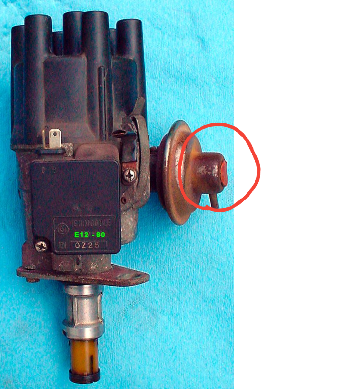

The 280Z dizzy single pick up (D6F4 to D6F6) had 17 degrees mechanical advance and 10 to 18 degrees vacuum advance depending on model number dizzy. You can mount a HEI just about anywhere.
Thd 280ZX 79 - early 81 (D6K8 and D6K9) had 17 mechanical, but came with 10 to 30 vacuum advance. You can remove a blob of plastic to access a screw to adjust the spring tension in the vacuum dash pot, but it is tricky and you can damage it beyond repair.
I don't know what your setup is, but if you are using tripples, you probably have the initial timing set higher than 10 degrees. If you have 15 degrees initial advance, you could have conditions with 63 degrees advance on some distributors.
Something to keep in mind when you install one of these distributors.
@EuroDat: Did you ever try this? Does turning the screw clockwise increase or decrease the vacuum advance?

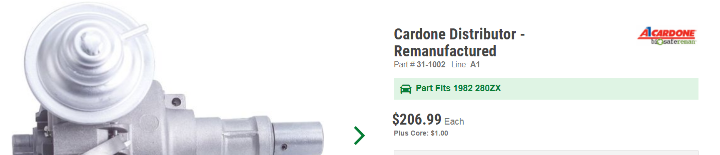

I might have to do this as Cardone can't tell which advance they implemented. All years got the same parts number.
@german240  Yes. We did it on a mates old rust bucket 280ZX. Unfortunatly we were not very carefull and the dremel we were using had too large a grinding head for the job.
We managed to get the plastic out and adjust the screw, but it had a vacuum leak because the grinder went through the side wall. Its very thin and easy to do. Sealed it with a blob of silicone and it didn't leak in the time he had it.
If I had to do it again, I would buy a kit of small grinding bits and take plenty of time to carefully remove the plastic.
