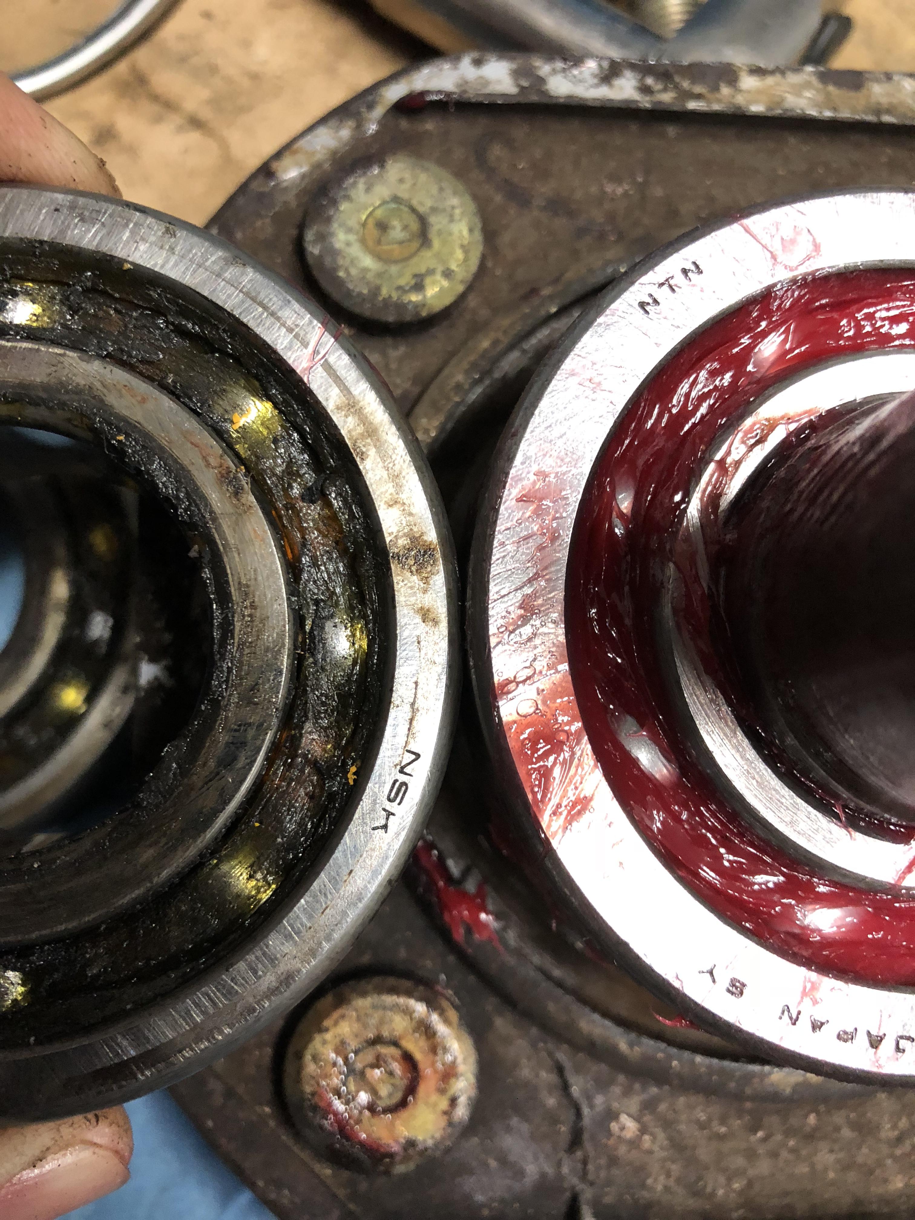

10 hours ago, fairladyz432 said:
there’s a difference in thickness but not sure if that can make any difference
That difference in thickness doesn't make any difference with respect to the problem you're having. Just larger balls in one bearing. From an outside "user" standpoint, doesn't change any of the external geometry.

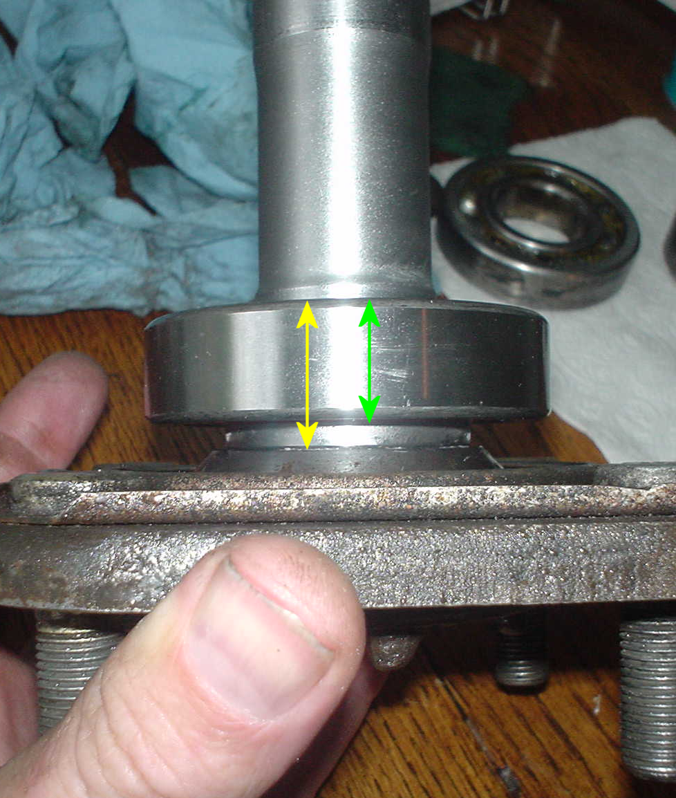

3 hours ago, 240260280 said:
These are the two measurements that need to be the same on both outside bearings.
Pedantic, I know, but ... Only the yellow needs to be the same measurement on the outside bearing. The ratio between race length and extended flange length won't affect the final location of the mating surfaces. As long as the total comes up to the same total width, the flange could be 90% of the width and a tiny thin "bearing" portion could make up the other 10%. The mating faces would still be in the correct locations.
It would be the wrong bearing for the application. but it would "work".   Haha!   I'll tune the OCD down now.   :)

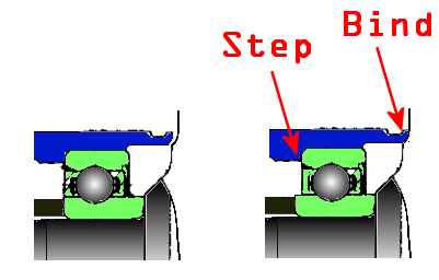

Sorry. CO you are right. I did not express it quite correctly.  Here is the point I was trying to make:
If the outside shell is stepped back, then the flange will draw in too far and bind. I mistakenly used outer race shell size rather than the step.
Edited by 240260280
