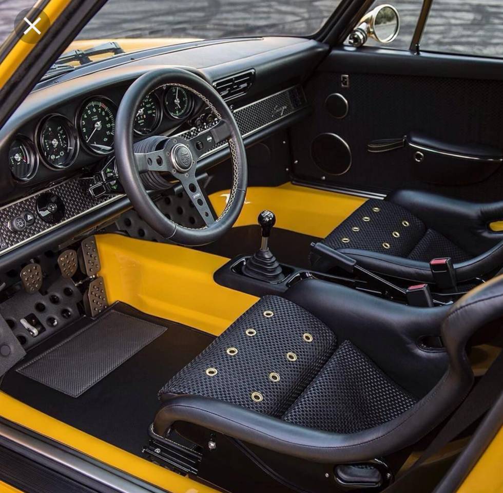

The Singer is what everything is being styled around, I've been reproducing parts for Porsches for a long time and thought it was time the Datsun got some love.

If Singer did a Z car I would consider robbing a bank just to own one. ? They are the best 911's I've seen. Light weight too!
The 911 aftermarket  is fantastic. 240Z values have to get near 911's though for some of that stuff.
Local built Singer clone attached. Notice everything drilled out.
