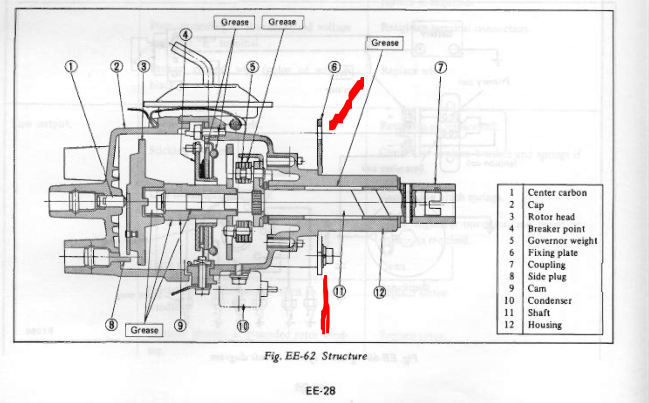

Patcon makes an excellent point.  There is definitely a few degrees of extra on the other adjustment.  I dinked around with mine when I was trying to clock my rotor for better centering over the electrodes, when I was trying to run more advance.  Funny though, eventually I got tired of trying to squeeze out a few more HP fractions and set everything pretty much back to stock.
The FSM shows it with the bolt still in it.  You can't see it from the top.  I marked the slot that you can see also.

It can't be a "tooth off" unless you removed the oil pump.  Or you have a US V8 engine installed.  The Datsun distributors use a slot and a tang to tie the distributor shaft to the drive shaft.  It can only install one way.

Doesn't look like you're actually measuring and there are other things that could be wrong.  Seems like verifying where things are at would be easier than dropping the oil pump and moving the drive gear over a tooth.  That's what you'll have to do to get more adjustment.  I was just describing how the distributor drive works, above.  It's not like a Chevy or Mopar where you just lift the distributor up and re- "stab" it a tooth over.  It only fits one way, in one position.
