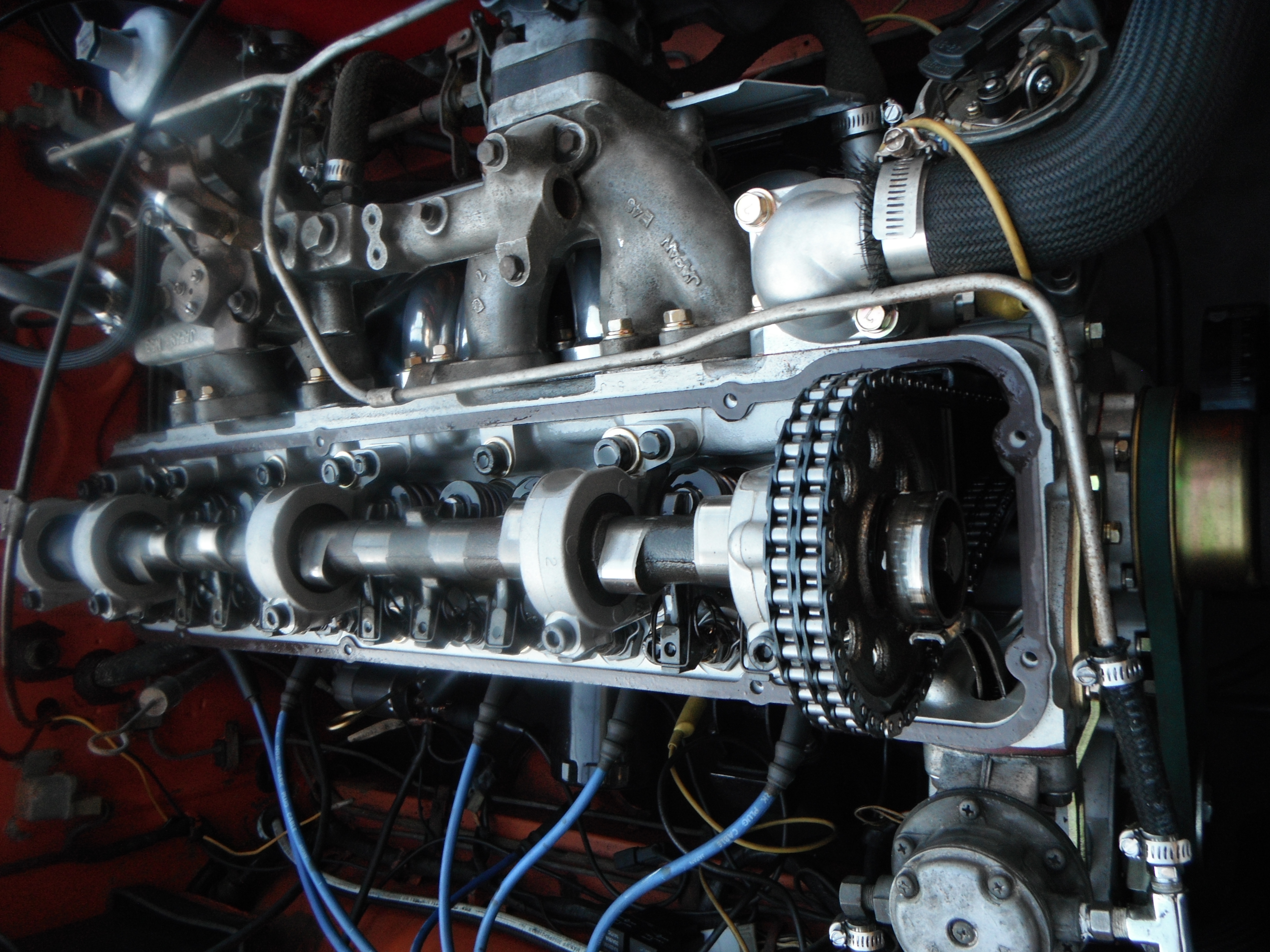

Here's a shot from a couple months ago, oh crap it's 5.7 MB probably way too big sorry.DSCF0339.JPG
