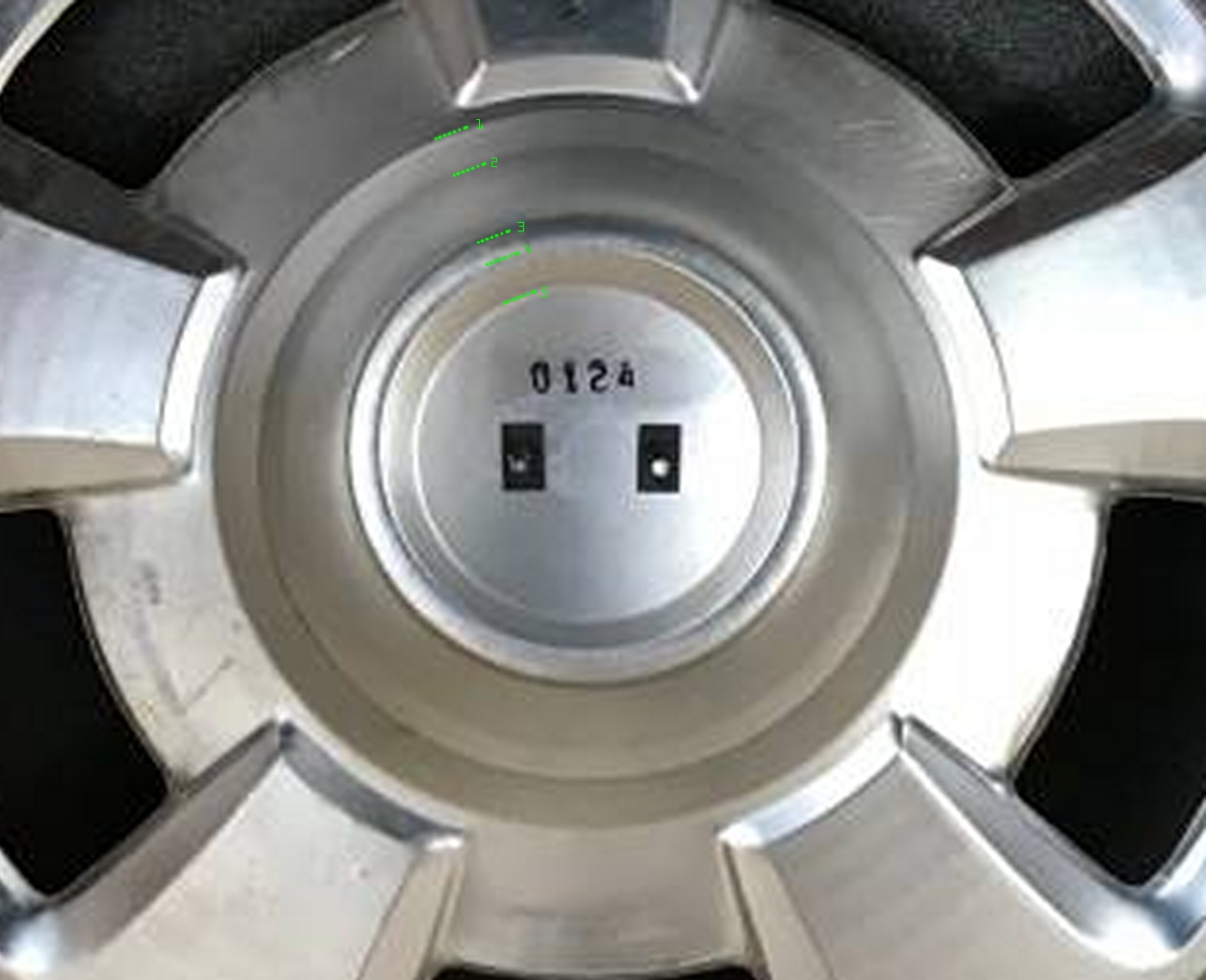

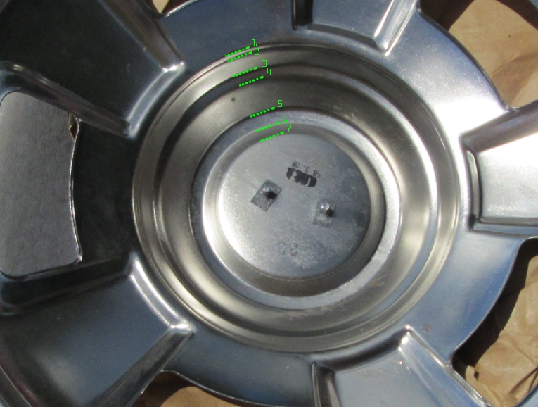

Real has 7 bends.                                                                                                                                              Fake  has 5 bends
Haha!! Good eyes! I saw that too and was trying to find some other pics to confirm, but I think we may have found "the tell".
I found a pic where I noticed that missing extra bend, but they were on the ones with the valve stem hole in the center of the slot, and not the center of the spoke. It's conceivable that they changed the die and removed those bends when they went to the valve in the spoke location.
So is the pic you posted from valve at hole, or valve at spoke?
