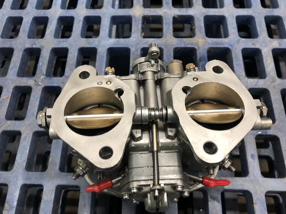

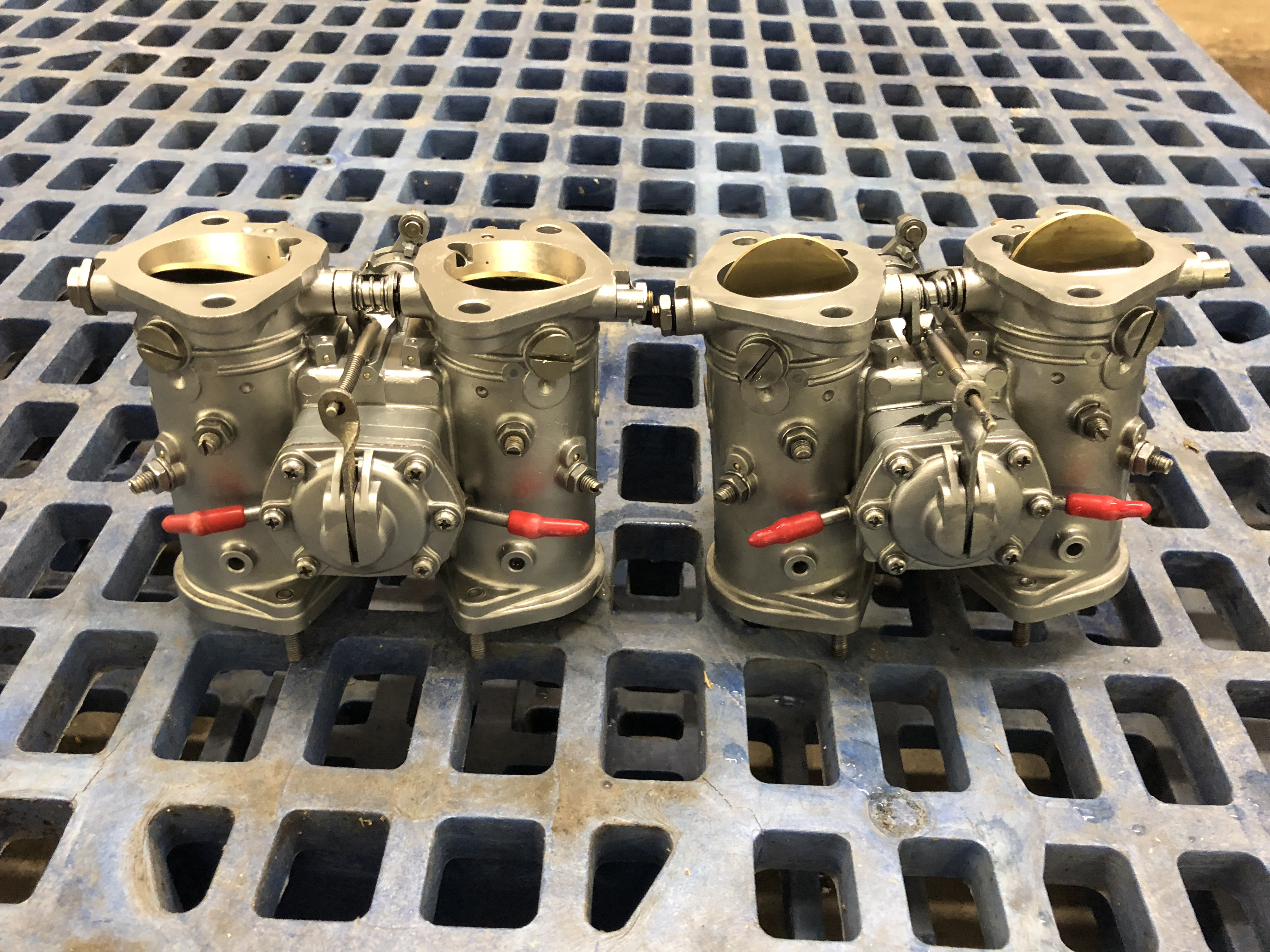

1 minute ago, S30Driver said:

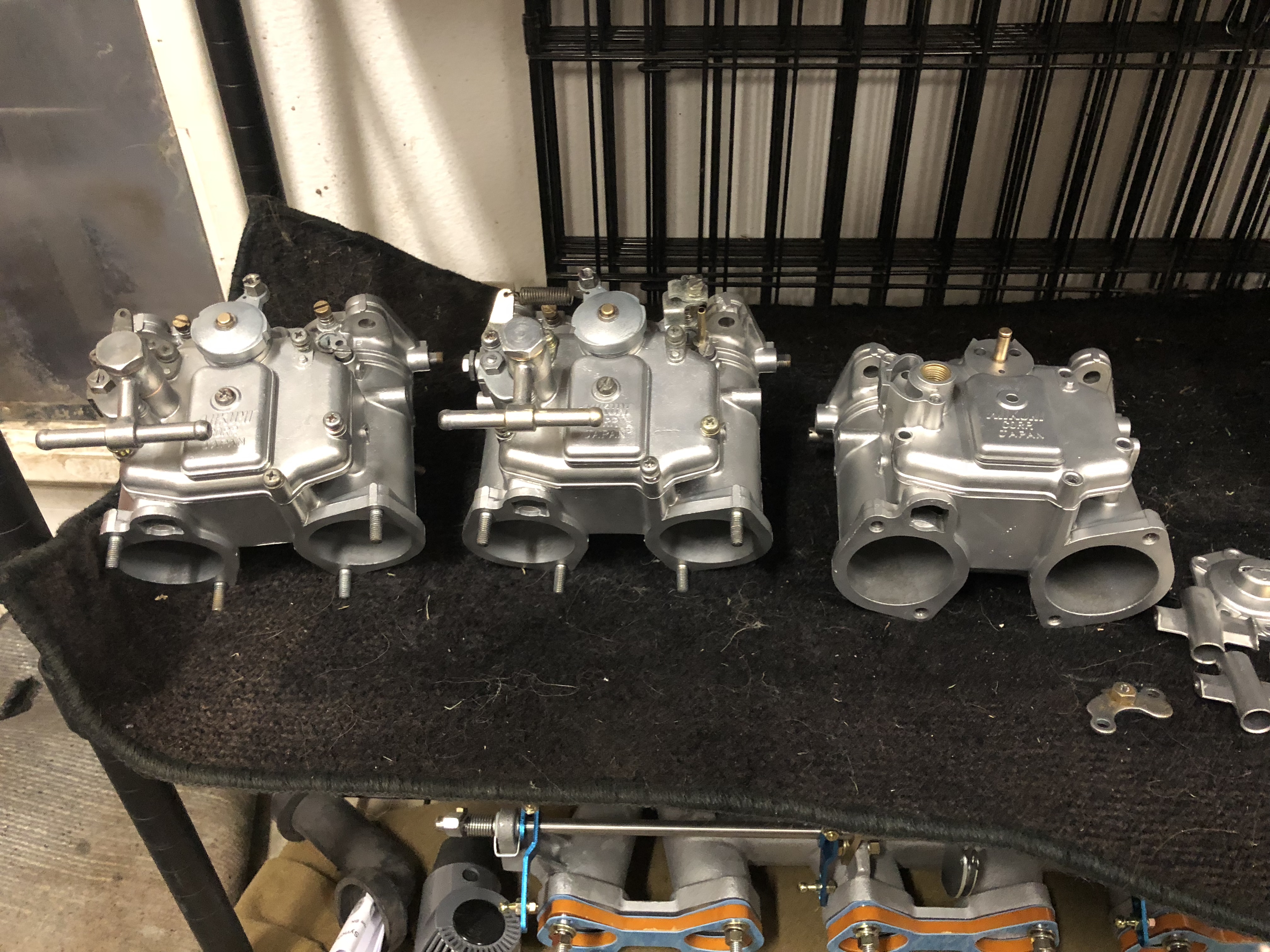

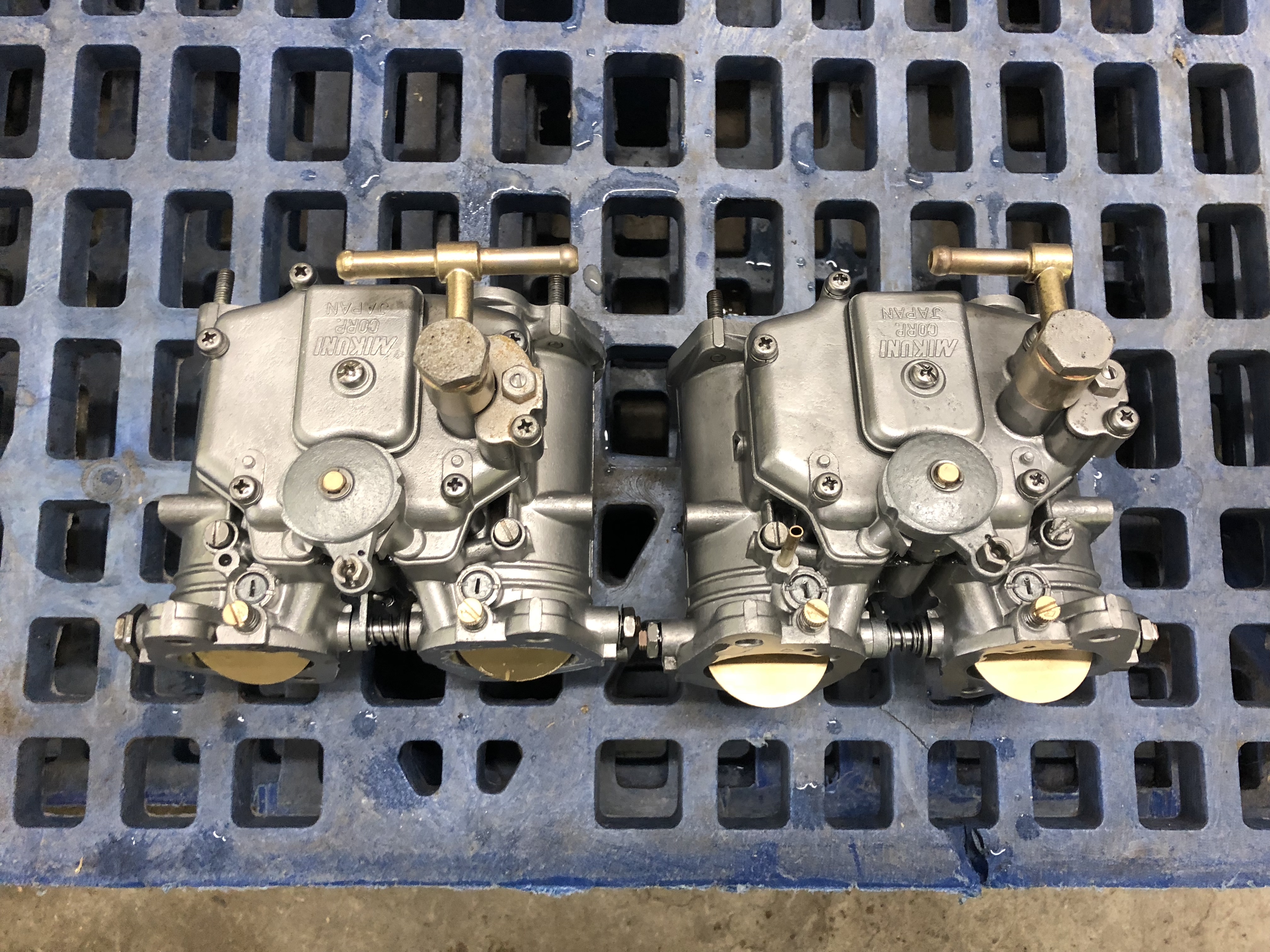

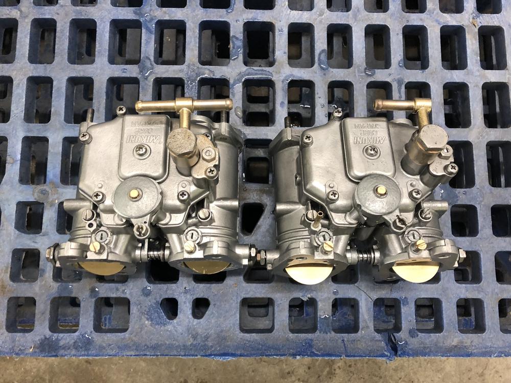

Impressive results for sure!   The mikuni's look great.

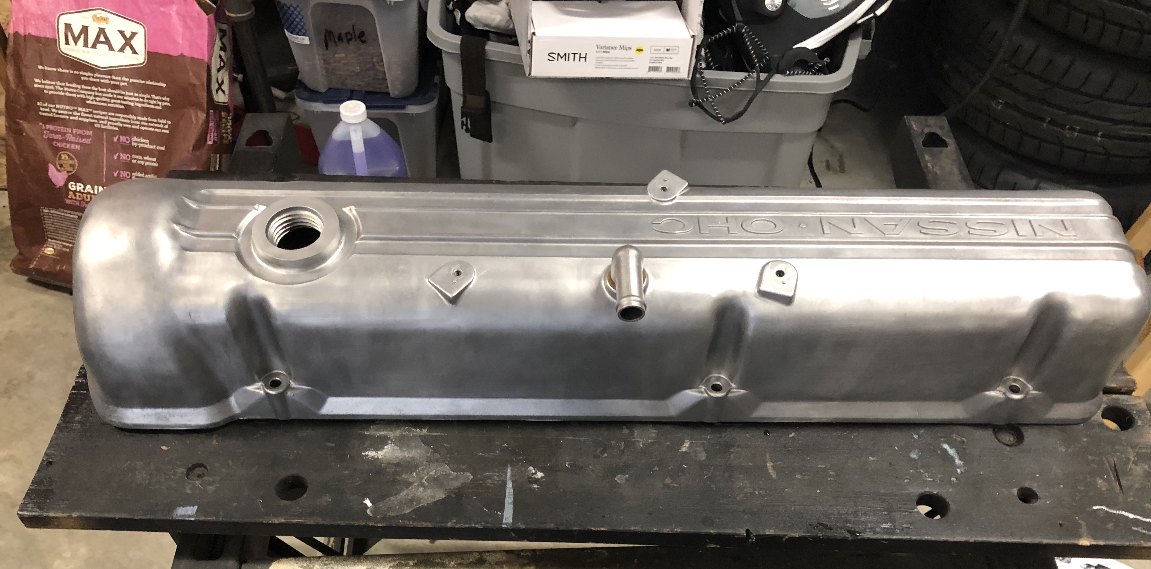

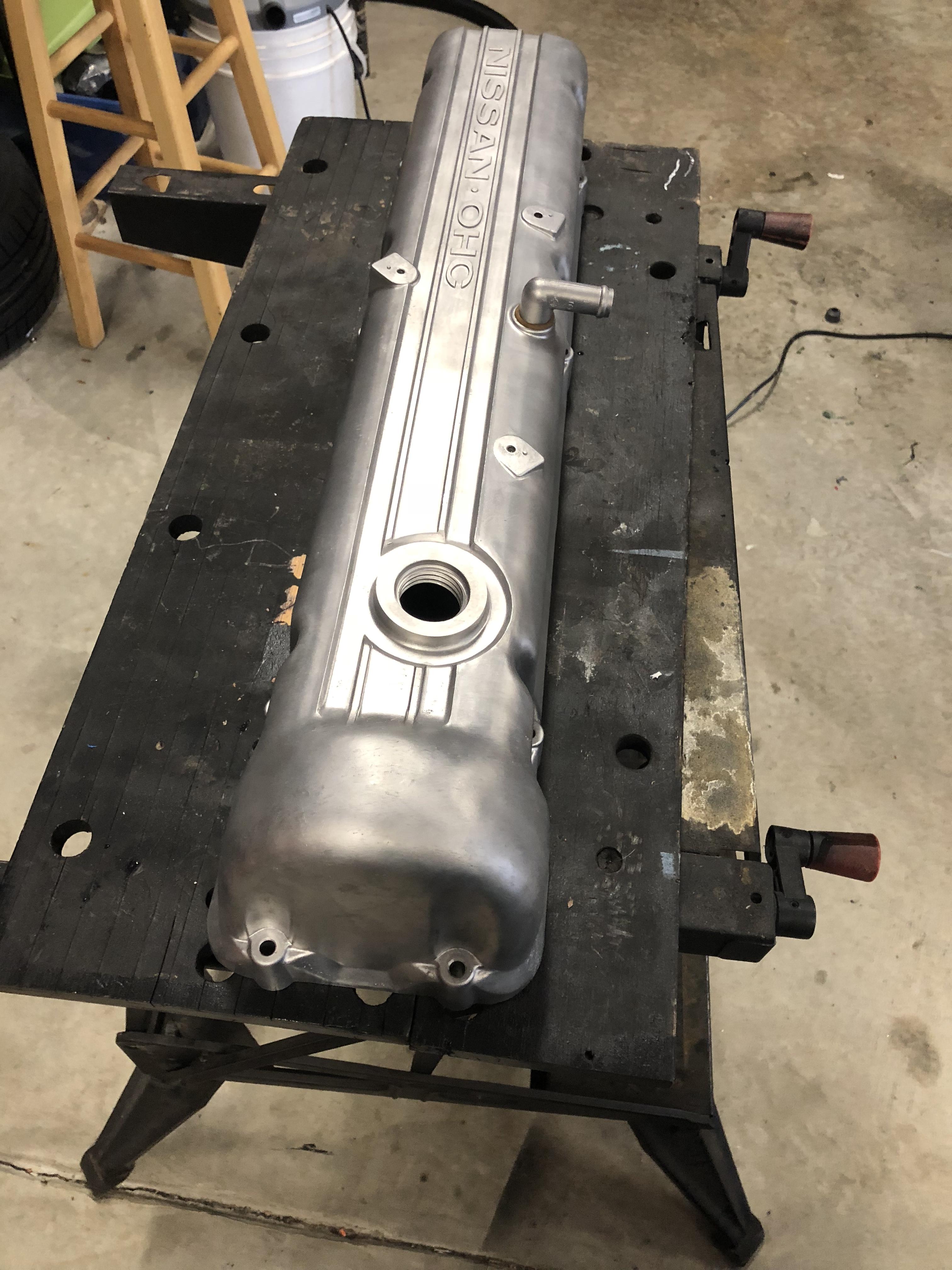

Include a pic of the valve cover after.

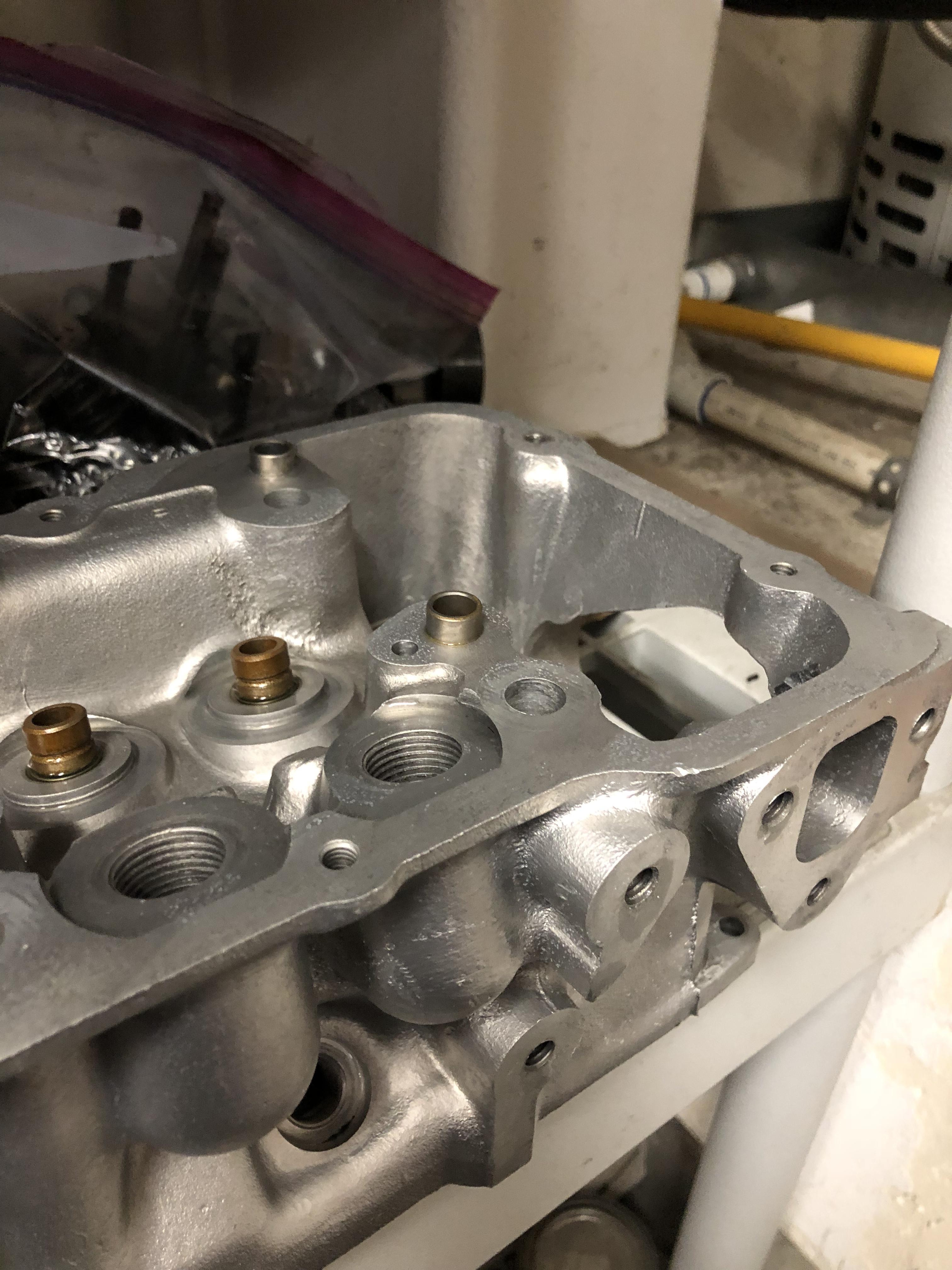

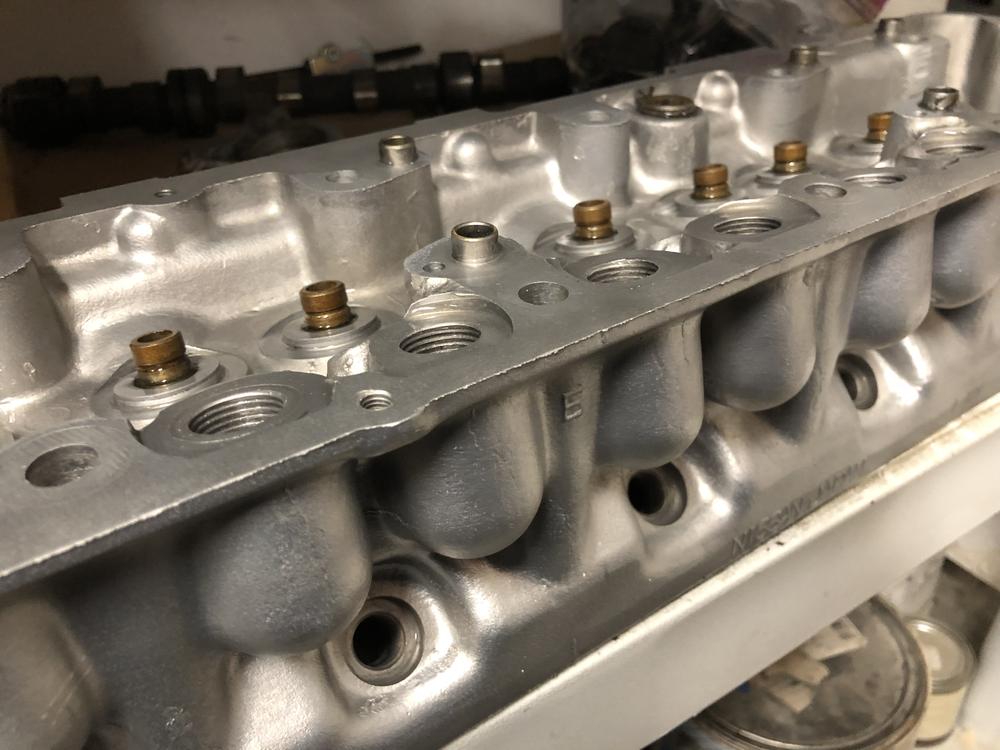

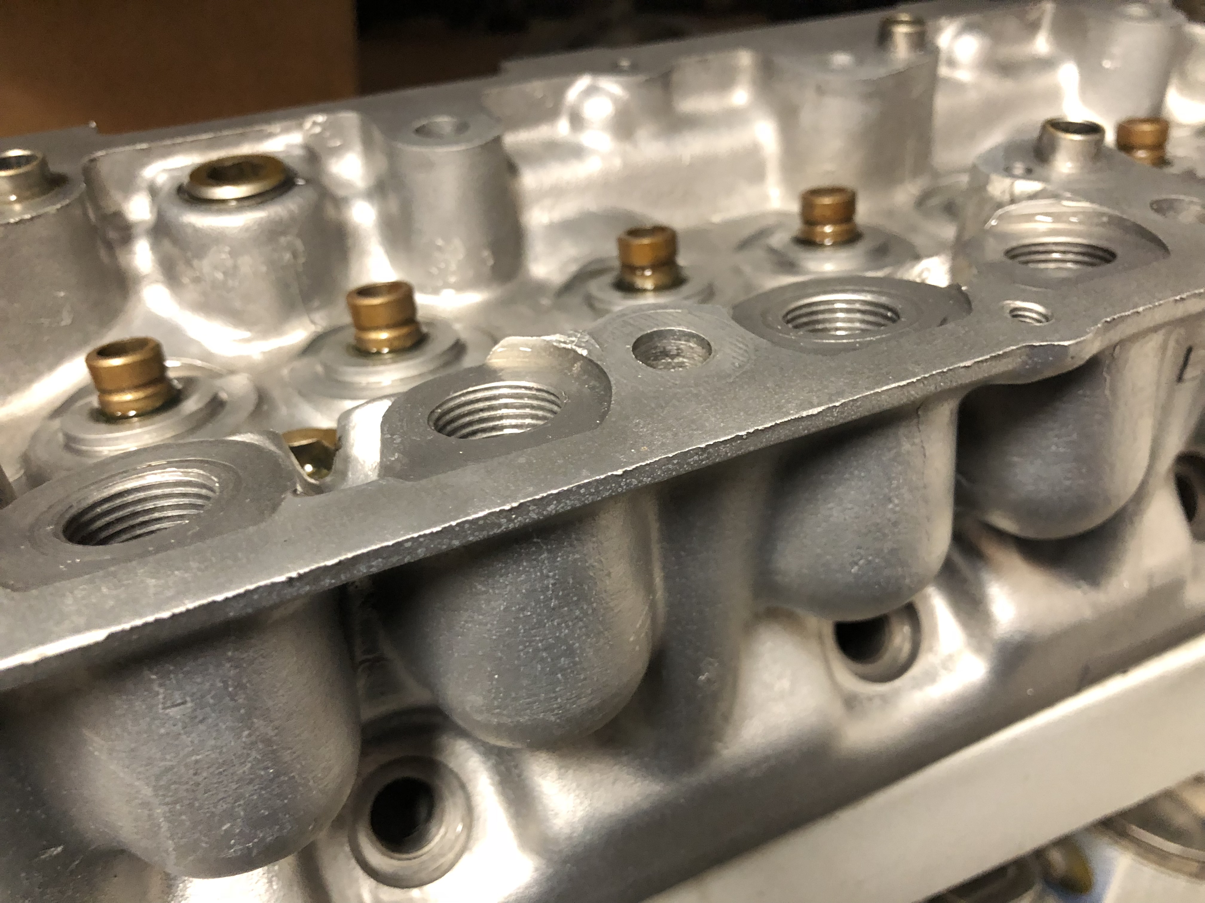

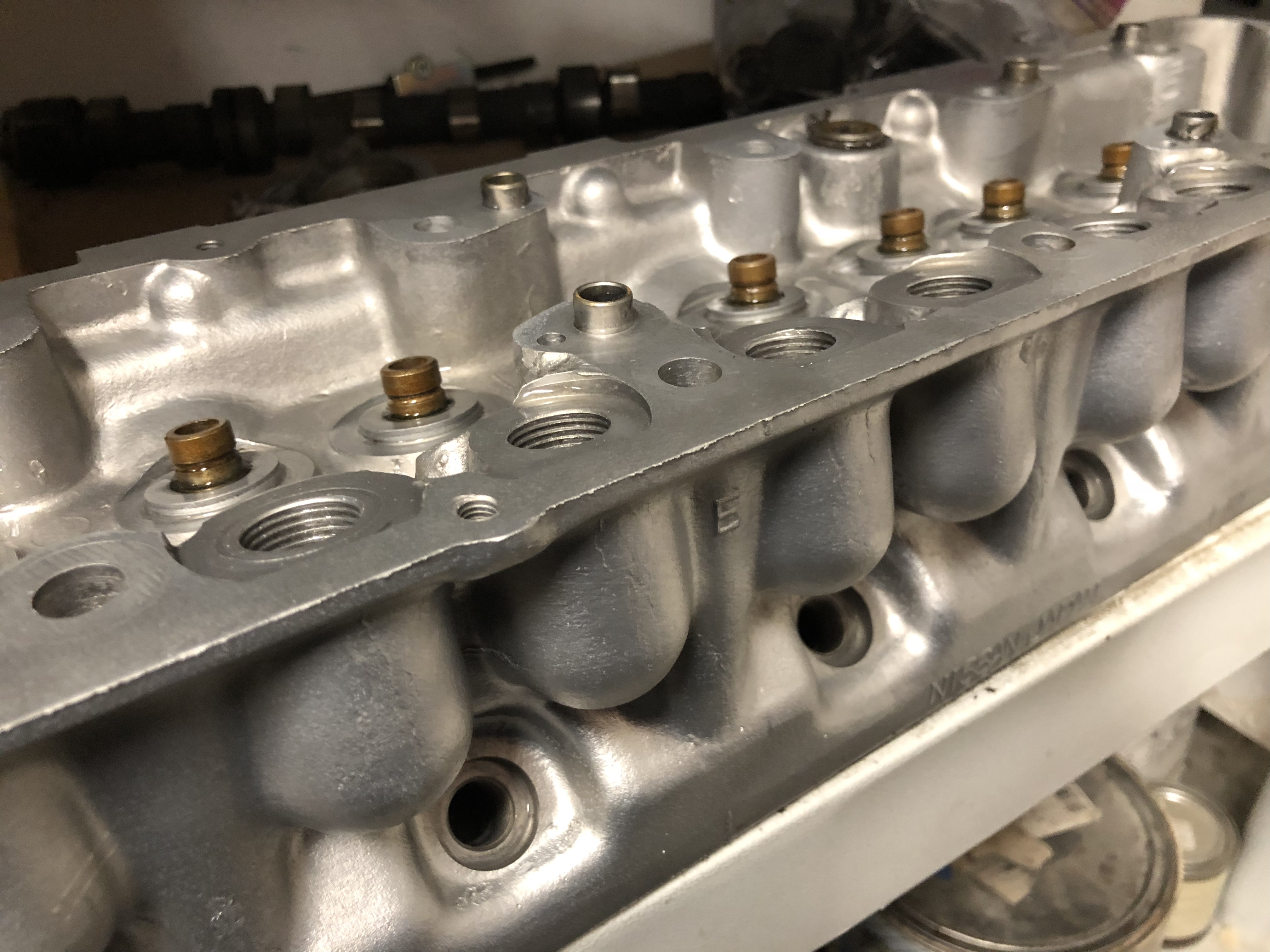

Not done with the cover yet. I will eventually do my head and my ford bronco oil pan and then my harada manifold.

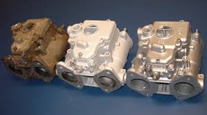

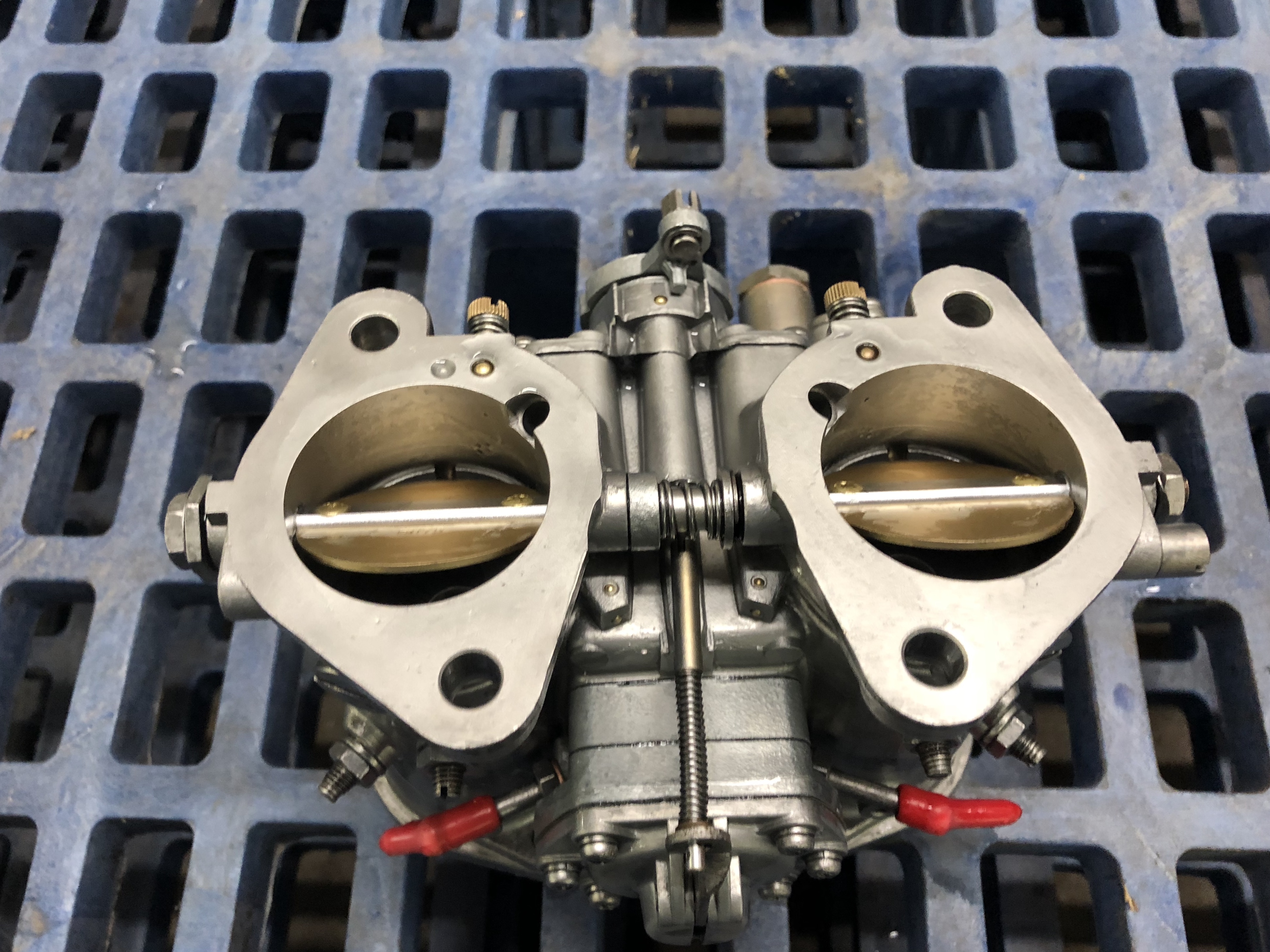

Very nice. Those results are fantastic.
So how do the results differ from straight up bead blasting? In other words... Would the parts have looked much different if you were using s standard bead blasting cabinet?
original, bead, vapour
Vapour peens and cools at same time.
I don’t think vapor affects the aluminum at all. I think it just picks the dirt out of crevices. It won’t pull off silicone or gaskets very easily. Doesn’t affect zinc. Doesn’t damage anything

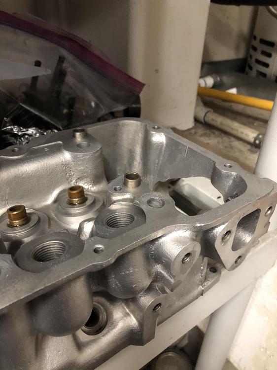

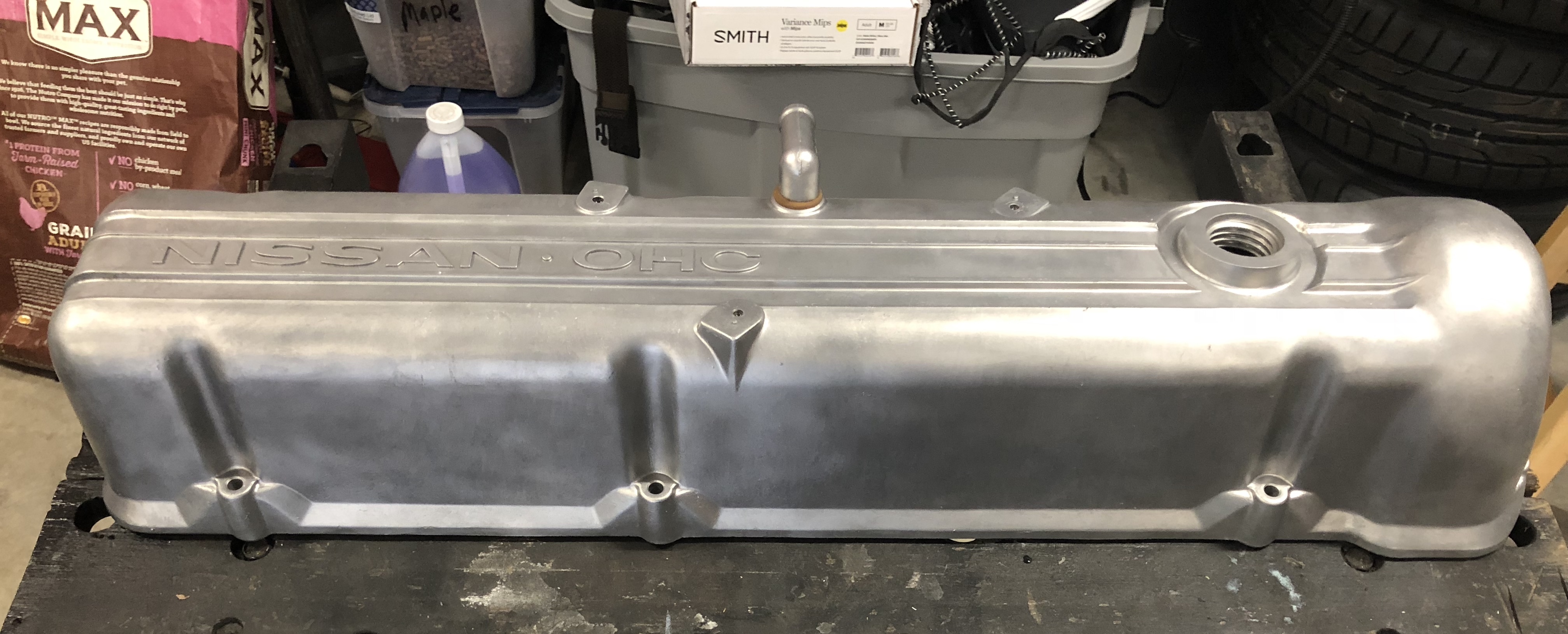

Today I tried way less glass and had the same results. This valve cover was rough. Looks pretty awesome now. Trying to get the appearce to be uniform is time consuming. I just gave up. I plan on doing 3 covers. One wrinkle red, wrinkle black and this one and decide which I like the best.
It it just barely big enough for this cover. The head will be tough to fit and get the ends done. Shouldn’t be that bad though.

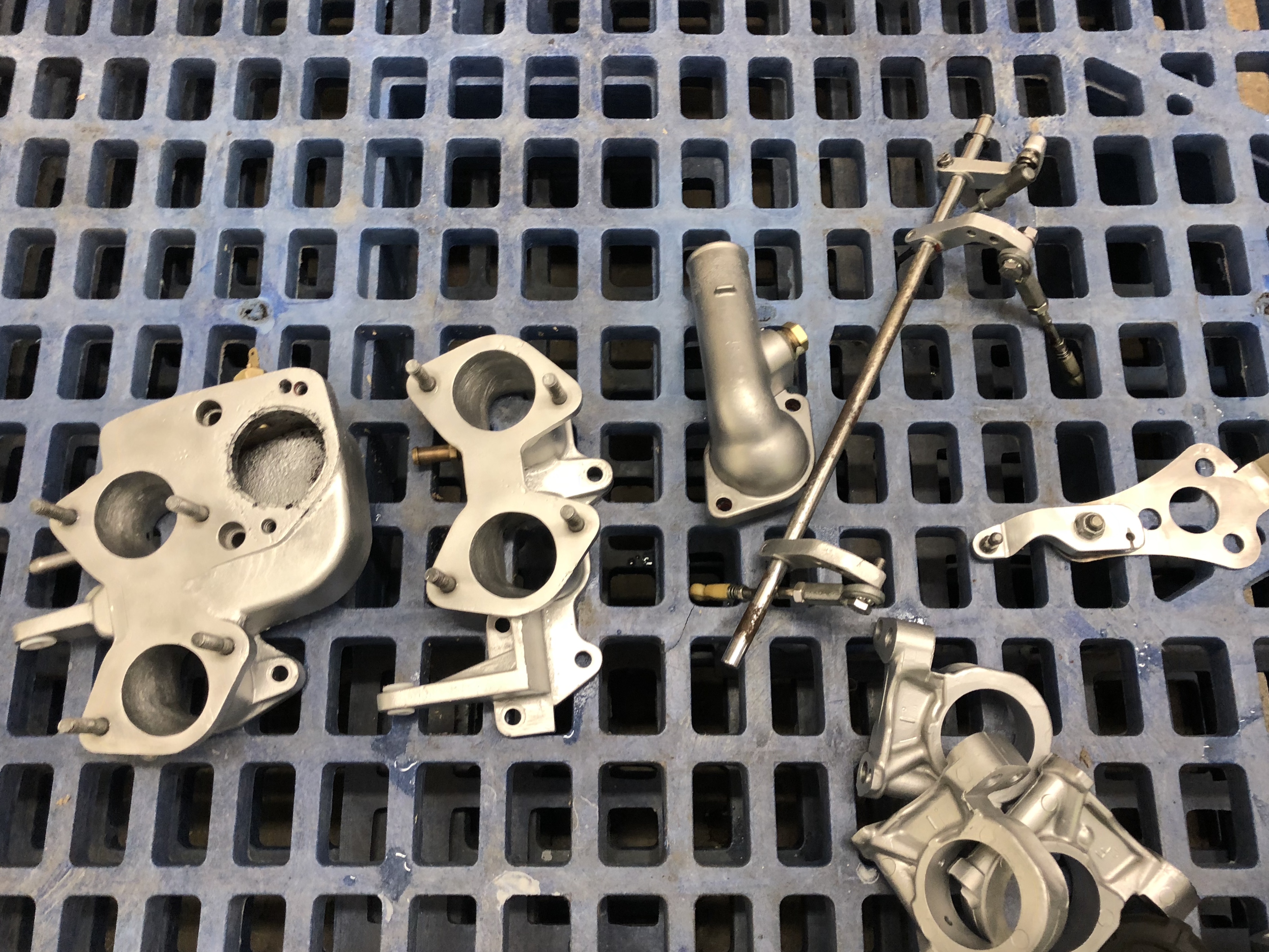

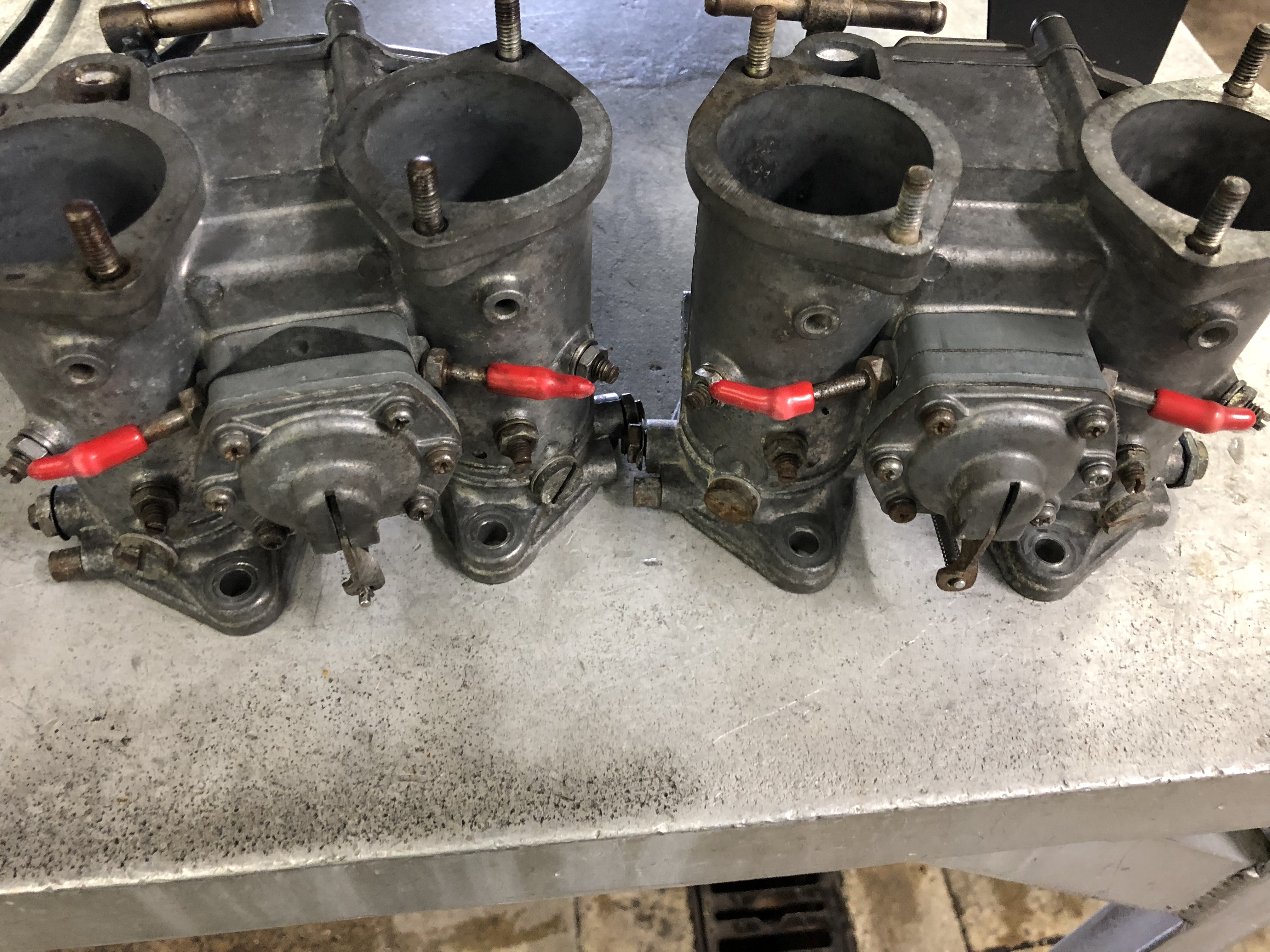

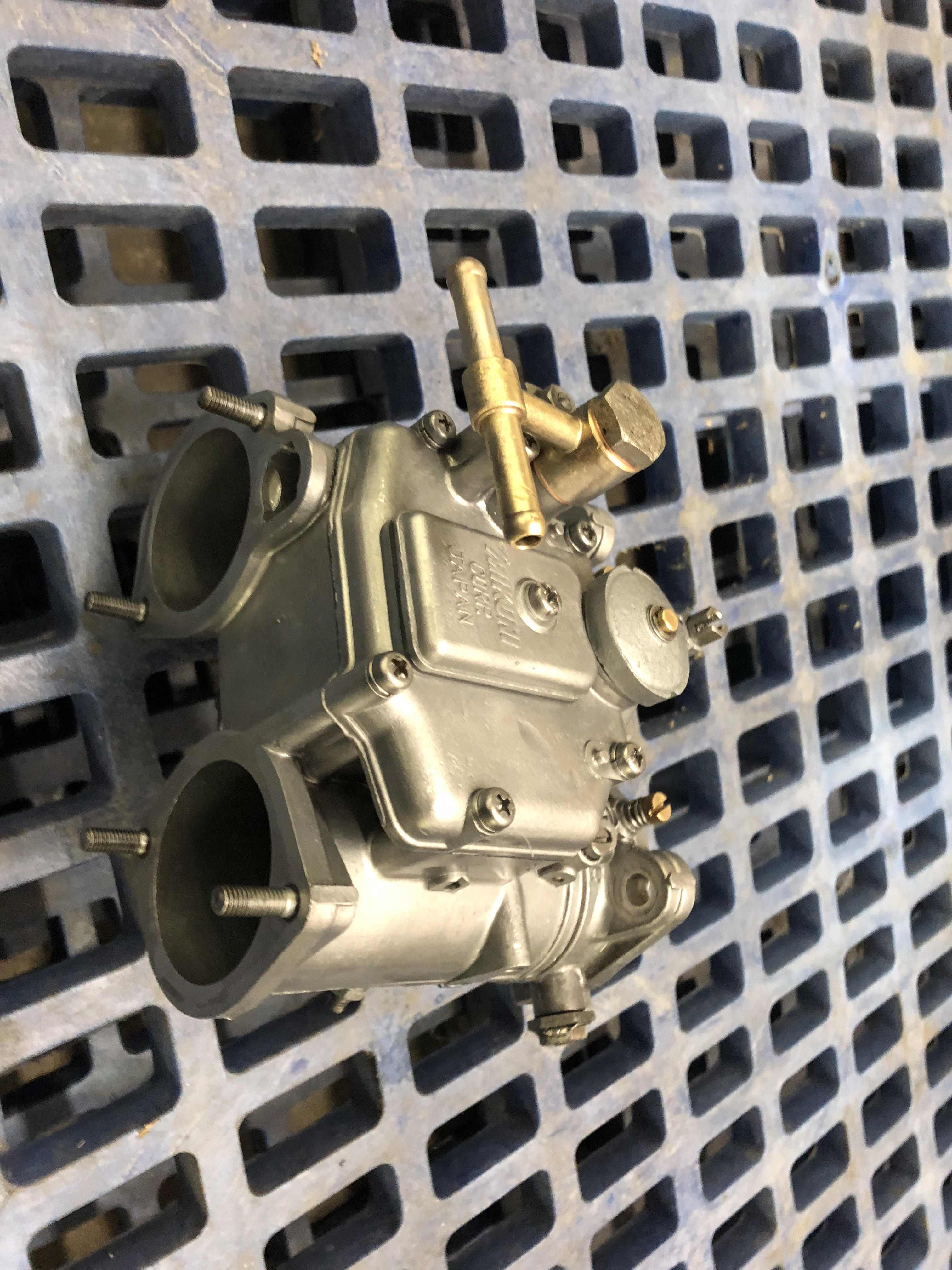

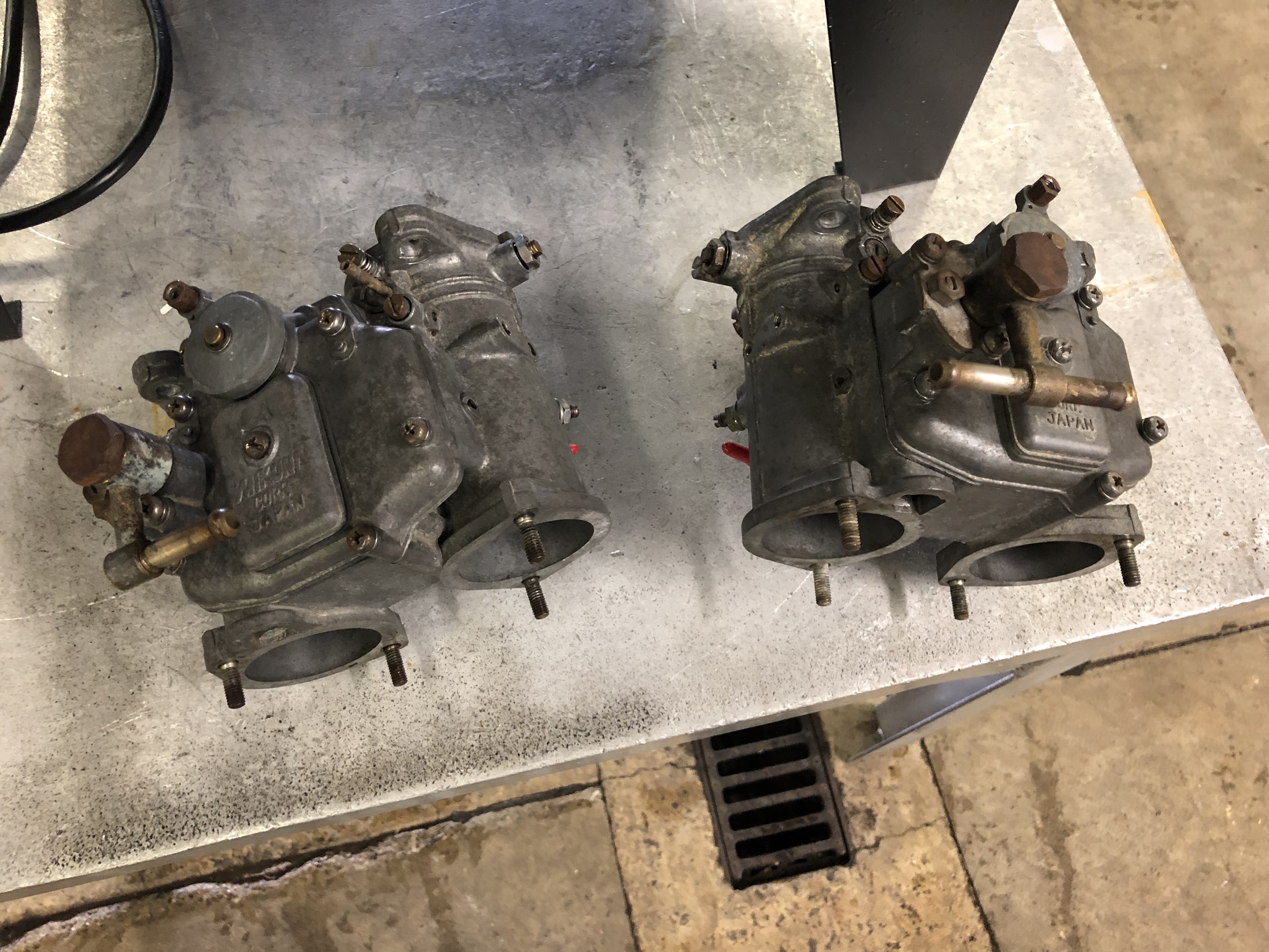

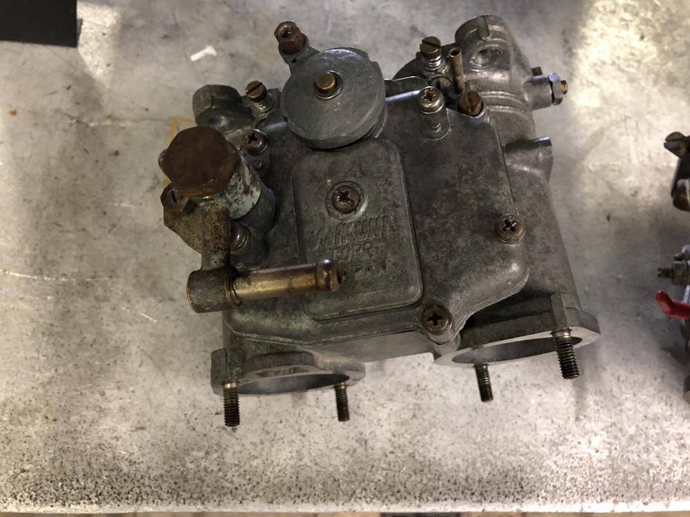

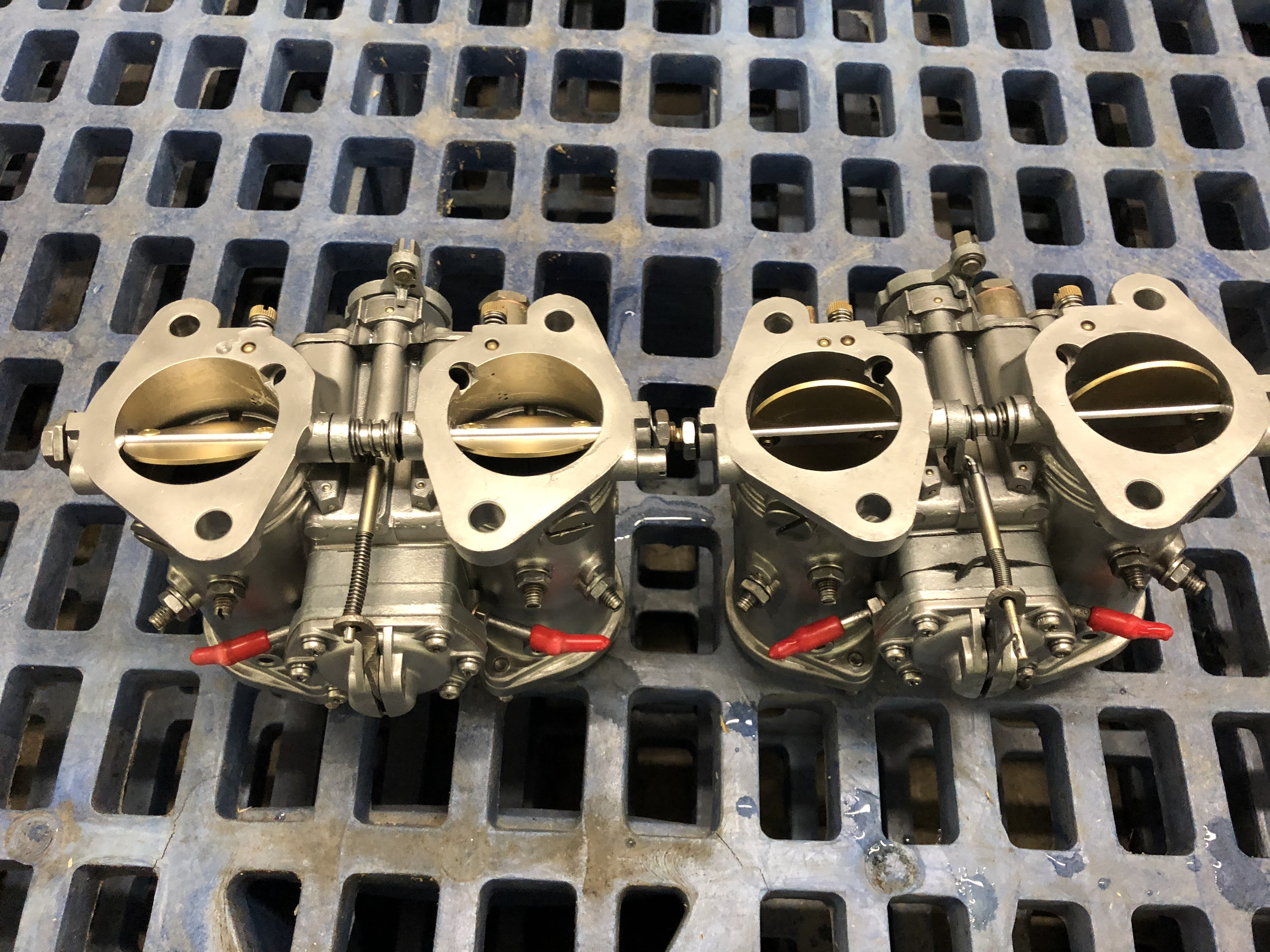

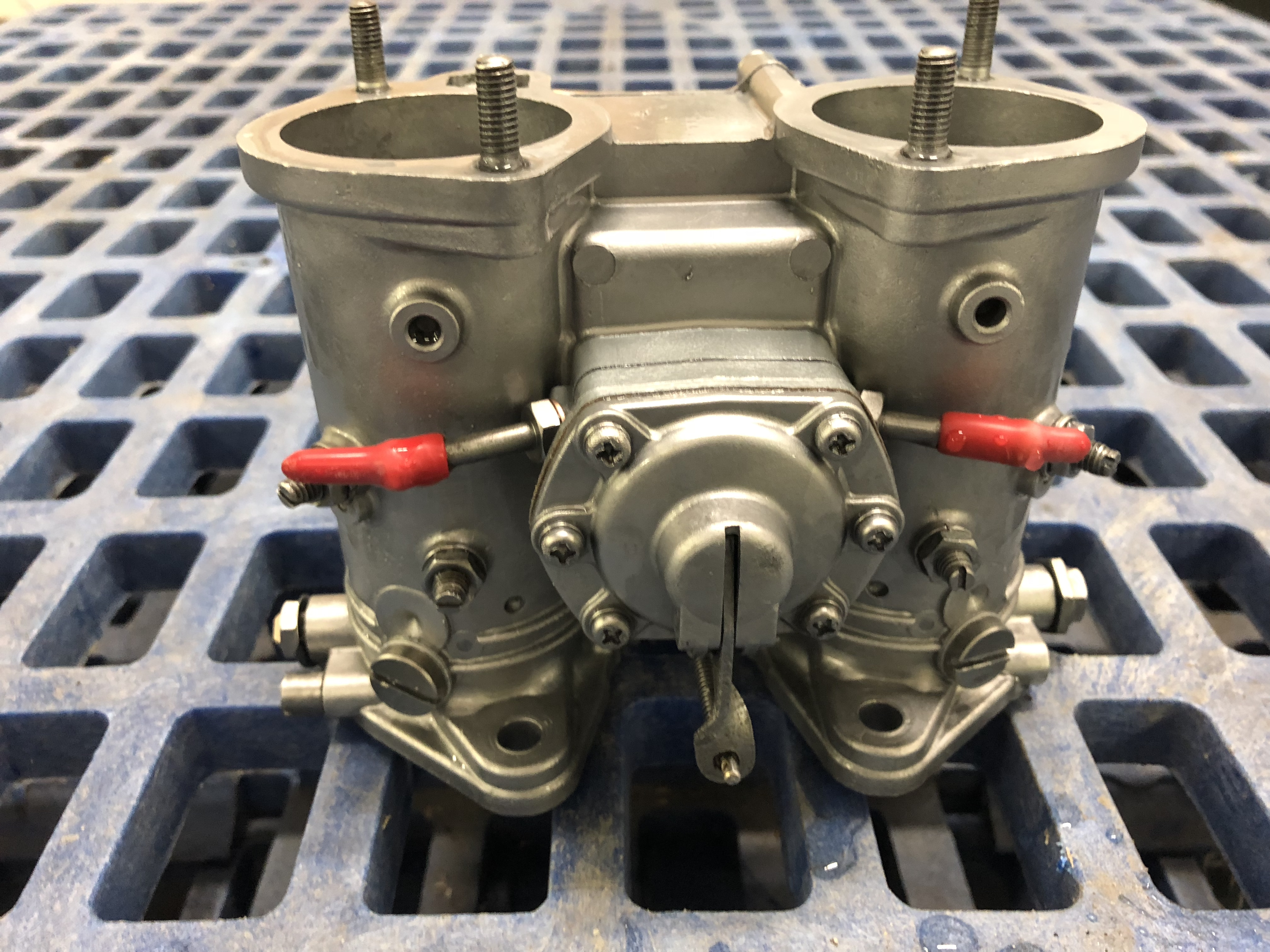

I got another set of rough 44s.  Strangely they were fully functional though.  They came out amazing.  Now off to have them rebuilt. I assume it gets everywhere and will need to be thoroughly cleaned and sonic bathed.
