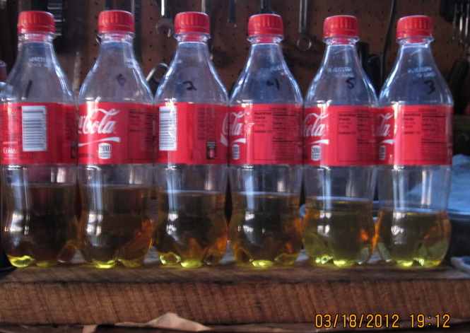

Your comments about injectors did make me remember how far off mine were on my car right after I bought it.  I drove it around like this and, who knows, might have even "wasted" money on a new AFM, assuming that the injectors were all good.  The new AFM "worked" for me but I still discovered that some of my injectors were clogged, later.
Short - maybe you have one or two clogged injectors.  They'll still click, they just own't squirt much.  I ran these for quite a while.  They're not urine samples.
