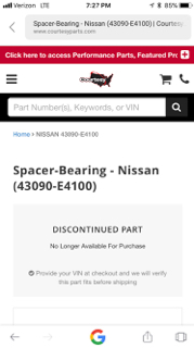

https://www.classiczcars.com/topic/59746-need-a-rear-bearing-spacer/
Motorsport wants $50 each plus shipping.
http://www.thezstore.com/page/TZS/PROD/classic01a/23-5031R
Can anyone beat that?
 Edit: they only have the B version, so I need to find out which one I need from the shop. Actually, I need to get all my parts back and go somewhere else.
