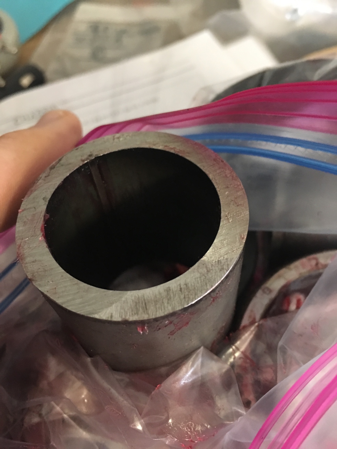

Is it a gouge or did he grind one face completely lop-sided?  Might be making more of it than it is.  The dimensions are out there, the two faces just need to be parallel and square to the cylinder.  The bearing races are rigid enough to live with a small gouge, I'd think.
John Coffey has posted a couple or times about just making one from a piece of steel pipe.
You could shorten up what you have, making it square and parallel, then shim it to proper size with a round shim.  It's a simple piece.
Are all three sizes NLA or just one?
MSA probably just takes the orders then has a local machinist make them on a piece basis.  Hence the high cost.  You can do what they do by yourself.  Take the old one and that chart from the FSM to an old-timey machinist and see what happens.

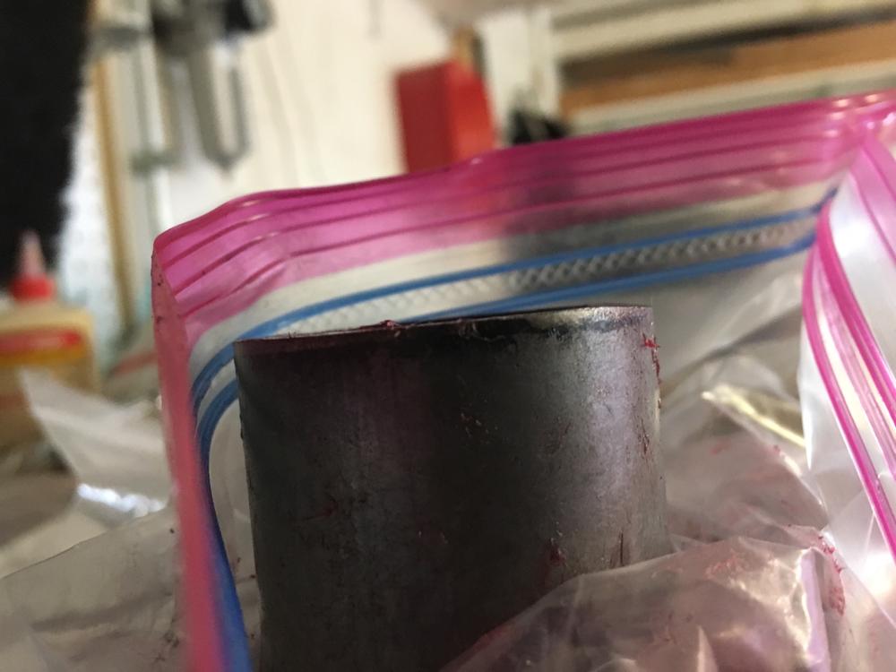

The end basically has been held against a grinder so it has a slice taken out of it that’s about .25-.5 mm deep and maybe 15-20 mm wide. It’s not the entire face that mates to the bearing but it’s not just a nick.
From what I can tell Motorsport is selling refurbished originals. They’re charging a core fee.
Edit: the reason the guy took a grinder to it is he felt that it was too long and the spindle wasn’t coming all the way through. He thinks the shoulder of the spindle should pass through the bearing so that the copper washer (which is an optional part) sits in the spindle rather than the bearing. I think the entire problem was started by the washer.

Update: all parts retrieved. I will asses them tonight and post a picture of the damage to the spacer. The hubs say B but I haven’t checked to see if the spacers match. Regardless I have one that is messed up.

Click through to Made-to-Order bushings.  Bushings > Drill Bushings > Made-to-Order > Your choice
Might be faster than MSA.  A bit cheaper.  And the exact size that you need.  Drill bushings are hard and durable, meant to resist deformation and wear.
Edit - the tolerance looks wide on the made-to-order bushings.  -0.4 to 0.4 mm.  0.8 range versus .06 range spec. in FSM.  Food for thought though.  They'd probably be in range, but there's a risk.  You could finesse them in with a whetstone. Those FSM specs. aren't well-defined anyway.

Normally I'd say not a big deal, the materials will handle a small imperfection.  But, considering the amount of force that the axle nut alone puts on the races and spacer assembly, and the loads during driving, a replacement seems in order.  The races are flexible, only at much higher loads than you'd see in your hand.  You could get abnormal wear on the balls.
Is there a B on it?  Sounds like zKars has you covered.
