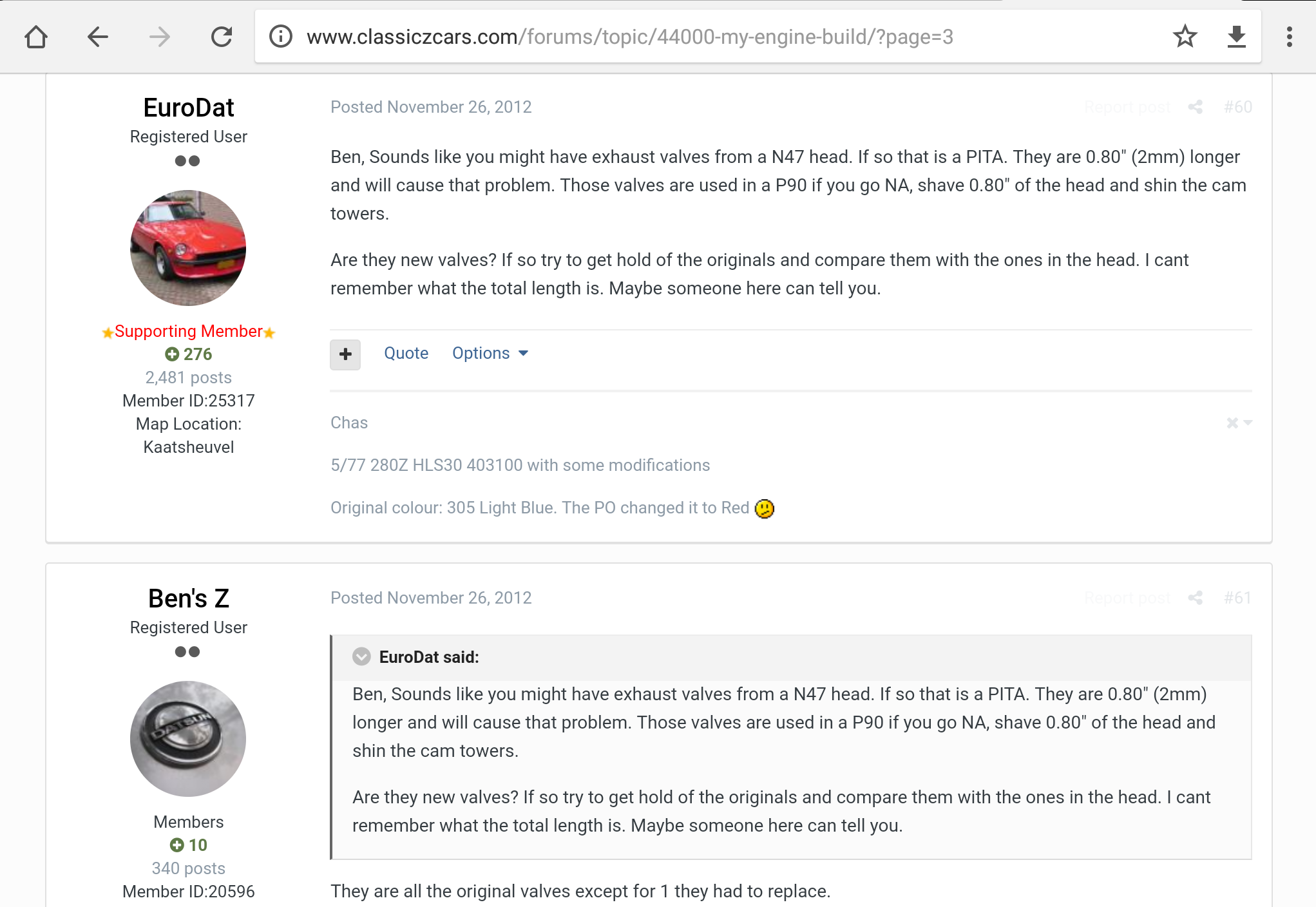

Now the real question. What valves did they us in this head when they fitted the L28 valves?
Normally when people do a head upgrade with a P79 or P90 (turbo head). They then shave 2mm of the head to raise the compression, add 2mm shimes to the cam towers to correct the valve timing and fit the valves out of a N42 or N47 head. Yes those valves have two mm longer stems.
If your head doesn't have shimes, I persume it has the valves for the P79/P90 heads. You would then need an adjustable timing gear to correct the valve timing.
I have the length of the valves written down somewhere. Ill dig it up and post it later.

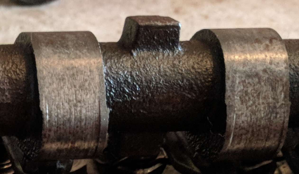

That head kind of looks like somebody's past experiment, that they tried to run and didn't get quite right.  There are many moving parts that have to work together.  But, I think that I can dissuade you (been waiting to use that word...) from entertaining the thought of putting that head on your engine, unless you want to spend quite a bit more money and time on it.
Look at the cam lobes.  The rocker arms are probably similar.  You might just have a collection of parts thrown together>  The bluing on the valve seats looks unrun, but there's no reason to put that camshaft on a head you're going to use.

Wow, that cma looks really bad.

I remeber having this discussion about the valves years ago. And a members machine shop mixed up the diferent L28 valves when they replaced a couple. If you use a general machine shop, YOU need to know a lot about these engines.
Here is a thread about the problems Ben was having. I admire Ben's resolve to finish it.
