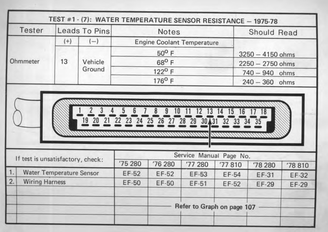

Have you checked the coolant temperature sensor circuit, at the ECU?  Or even at the sensor itself. Make sure that it is connected firmly.  It's in the thermostat housing.  Sounds like it might be disconnected.

I checked the sensors and they came out easily, they don't have a clip to the sensors. Also I'm posting a picture to make sure that I'm also doing this right and it's the right sensors.I checked that box looking one and the one after the white connector. All this is under the Raditor hose.ill post a second one from a farther distance to get a better look.20180402_133756.jpg
