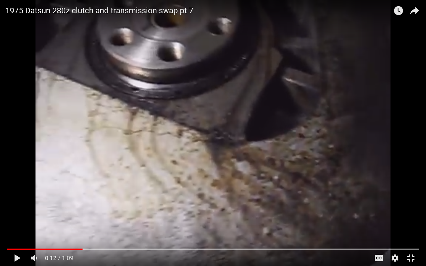

Side seal?
Which one are you referring to?
directly to the side of the round rear main is a parting line for the rear bearing cap. there is a rubber seal that can leak making the same problem as the rear main. You will see oil seeping out of it from the rear view of the crank case with the flywheel out of the way. In my case it was leaking more than the rear main.
