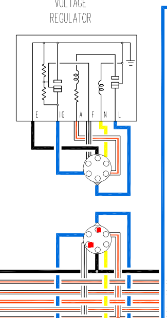

Sounds like the wire that you chose is not the actual L wire.  If I read the diagram right, the two wires I marked in red are the ones you want to jump, which looks like what atlanticz says.  Seems like you were there but undid it. 2-5 looks like the circuit is always powered.  Might drain your battery through the alternator windings.

Looks like my pins 2-5 jumper does indeed drain the battery while the motor is not running.  Will re-pin for 1-5 again and give that a try.

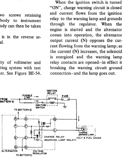

Bruce,  this is the circuit I am looking at in the 77 shop manual (BE41) for the charge lamp problem ........
