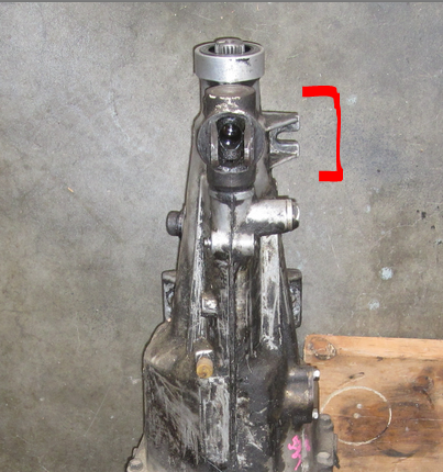

43 minutes ago, Dave WM said:
look at the tail shaft of the trans near the output. there are either 1 or two mounting points for hanging the exhaust on.
Here is a 1983 5 speed.  Only one bracket for the exhaust system hanger.  Earlier models had one on each side.

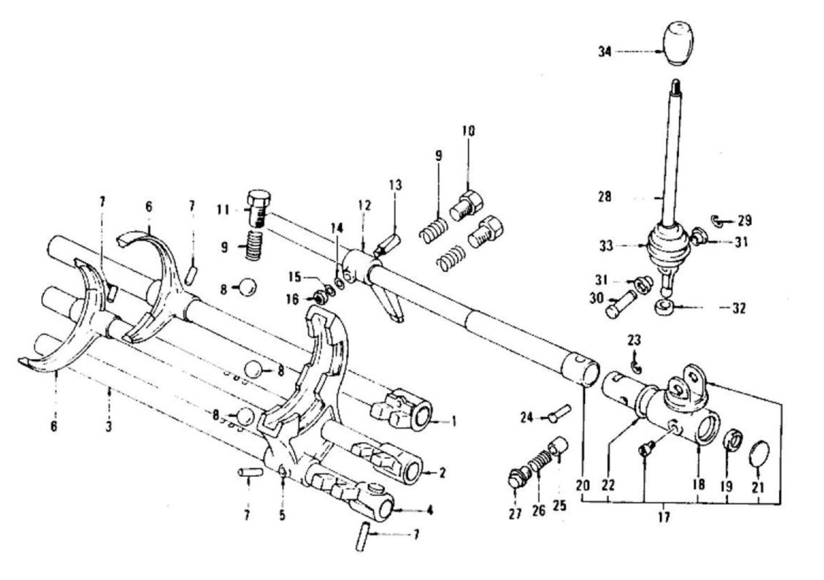

- Detents fitted in reverse in the 5th hub. Early manuals show them in reverse which is wrong. Later 300ZX with FS5W71C has them shown correctly. I have corrected a version for the 77 manual. Ill post it in the download section went Im on my PC.
- Weakened spring in the ball check for the 5th selector. All the springs are the same, so it is easy to check the condition of a poor spring. See pos#9 in drawing of selectors.
