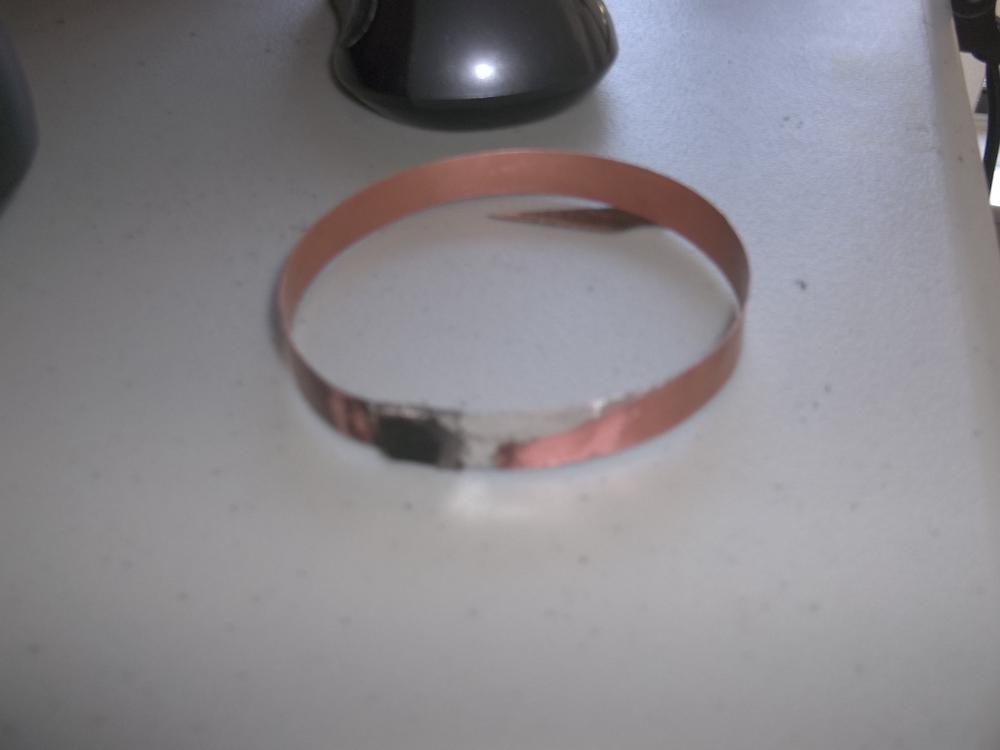

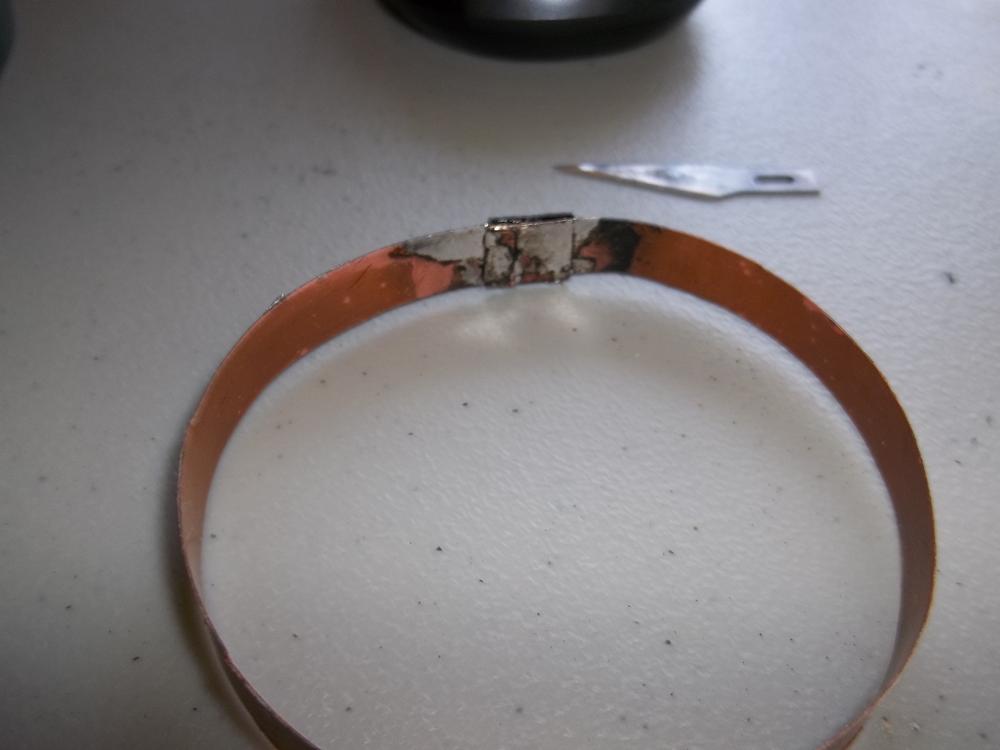

I cut about 1/4" wide strip of some very thin copper sheet, used about 3/4" piece to form a collar then looped it around and adjusted to make the correct diameter hoop. reverse bend after inserting thru the collar, and soldered it up. I did have to dig out a very small section of the foam maybe 1/16" about 3/8 long to allow the collar to fit nicely.
update, installing the horn pad resulted in breaking the insulator. up side is you can still buy them so at least I will have a new one for it. I don't know if the reinforcement is causing it to be too tight, perhaps the zip tie is the way to go after all. The design of the insulator seems to rely on 3 wires around the perimeter that I presume snap into place on a thin track inside the hub. Perhaps too much downward force is required to displace the wire, resulting it the break.

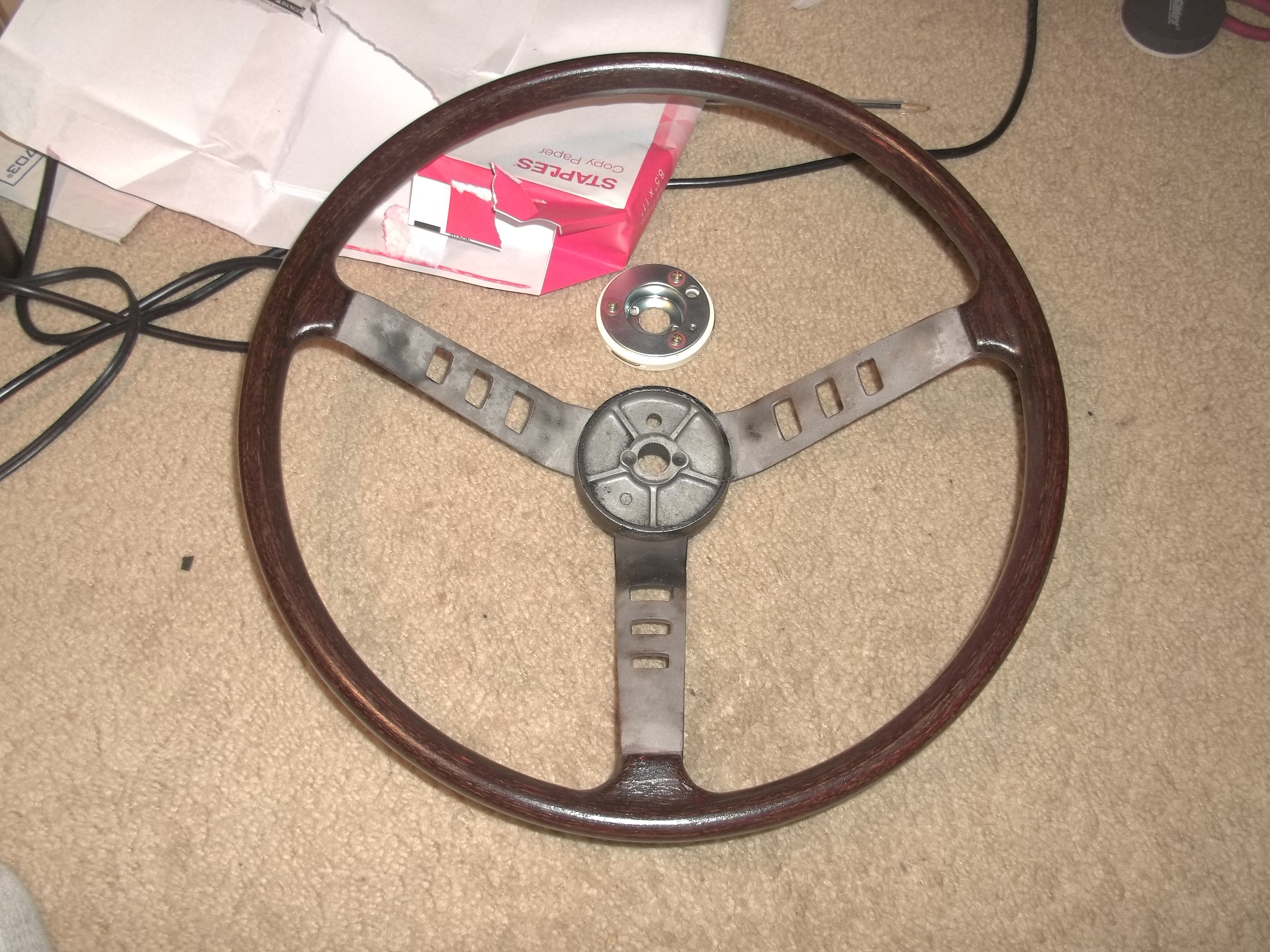

got a HF sand blaster and some 70 grit alum oxide to work on the steering wheel spokes. You can see the new insulter as well, with it and the after market horn button you can hit the biggest pot holes and not worry about the button popping off, it hold on REAL tight.
