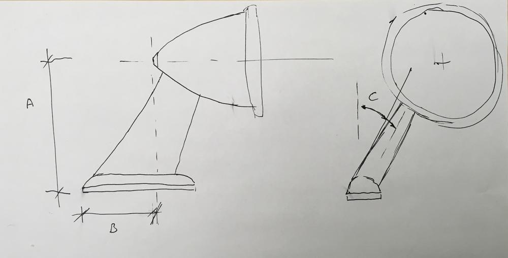

I’m looking for some dimensions of the long arm original JDM fender mirror.
Planning to buy a cheap set (https://zcardepot.com/mirror-bullet-style-black-240z-260z-280z-70-78.html?gclid=CjwKCAjw2dvWBRBvEiwADllhn0PO9n9E9yaRQdEEbrvl-4P9_Ckc5zkTip-ZyPXSaW-JEToJ8ncwhxoCuZkQAvD_BwE)
and rebuild with longer arms. I will model the parts in fusion 360 then 3d print the arm sections. Also will look to add a spring mechanism at the base.
looking for height A, offset B and side offset angle C.
