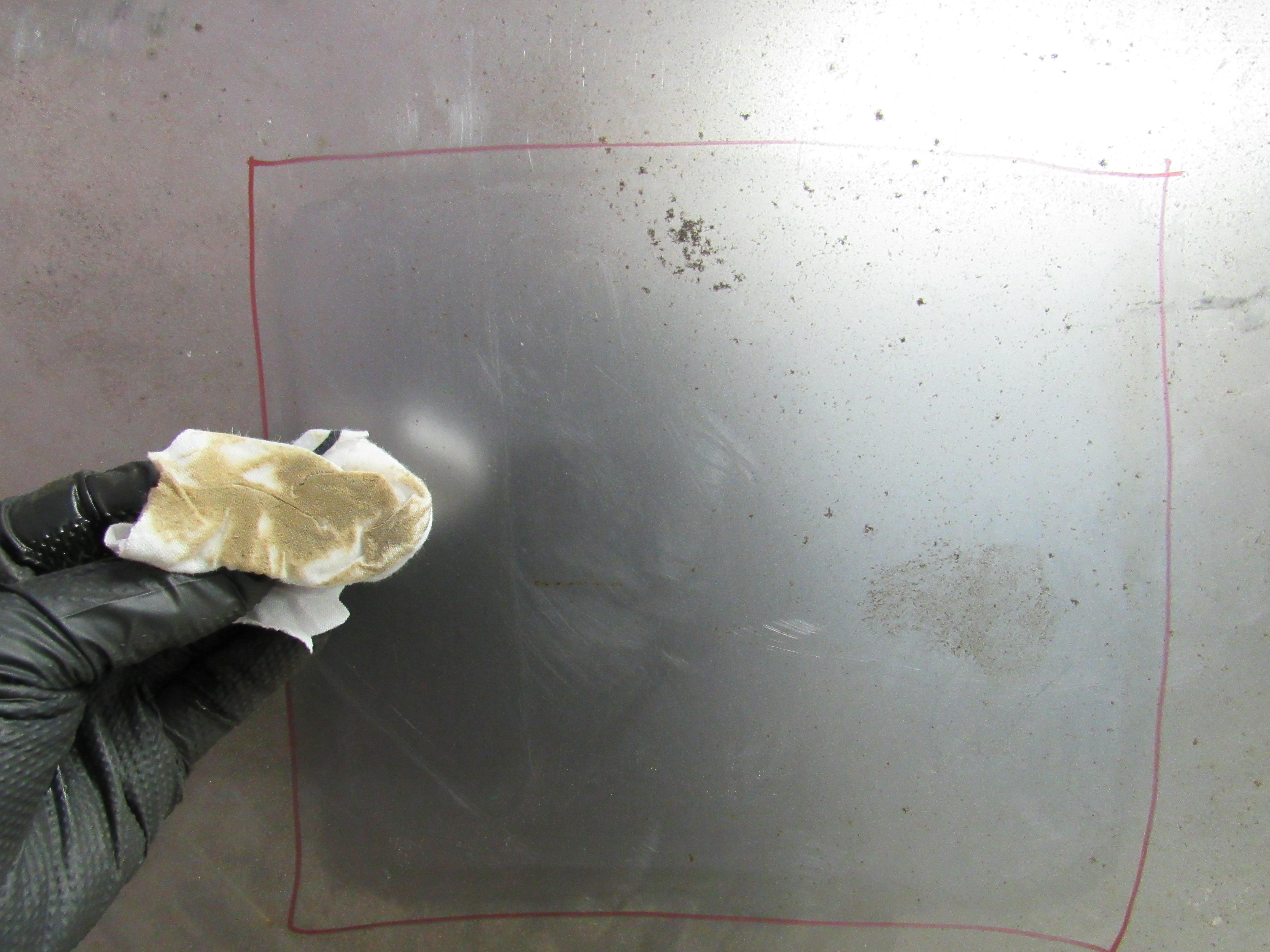

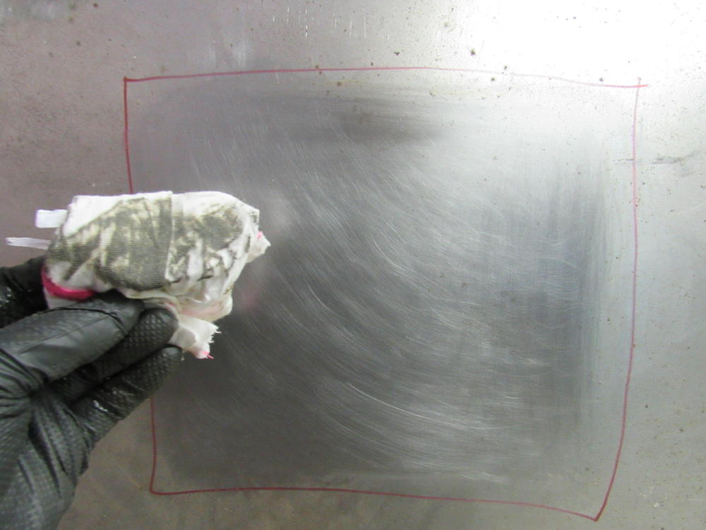

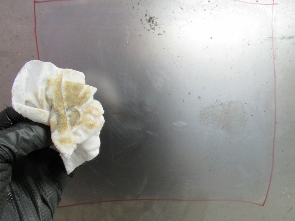

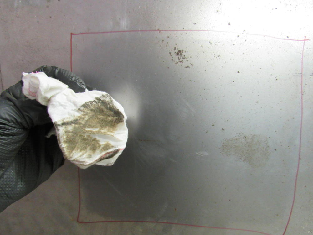

These pics are part of a long term project I'm playing with but they illustrate really clearly how much crap is on metal and why it is so easy to have problems with primer and paint.  This a sheet of 20ga metal straight from the warehouse,  the same square of metal was cleaned  3 times with that same cleaner until the cloth was coming away clean before moving on to the next cleaner, these pics are just the 1st wipe of 3.  The cleaner used is listed under the pic.
IMG_1276.JPGW&G remover
Water based cleaner,
IMG_1278.JPGMethyl Hydrate
IMG_1281.JPGSanded with 80 grit then W&G remover
IMG_1283.JPGWater based cleaner
IMG_1284.JPGMethyl Hydrate
