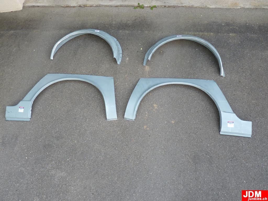

This photo may help you understand the details for the Tabco rear-quarter patch panels.  Unfortunately, it doesn't answer your specific question, because the door jamb edge can't be seen on either panel.  Looks like they may be difficult to integrate properly unless you also replace the outer wheel housings (also shown in the photo) so as to get a decent bonding/sealing surface around the lip.  The four pieces will probably cost Cdn $800 - $1000 after you've paid for shipping, tax, duties, etc.

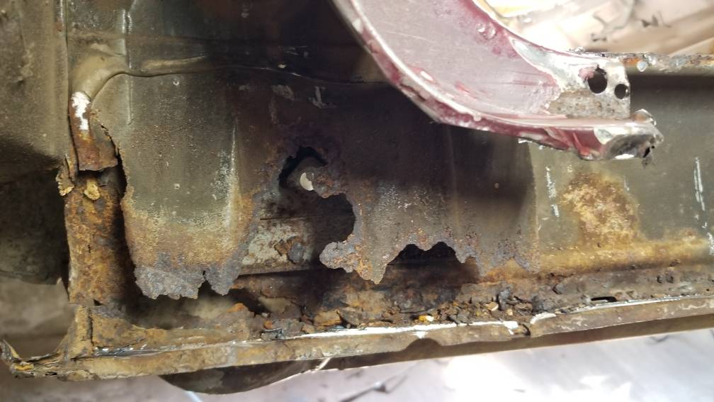

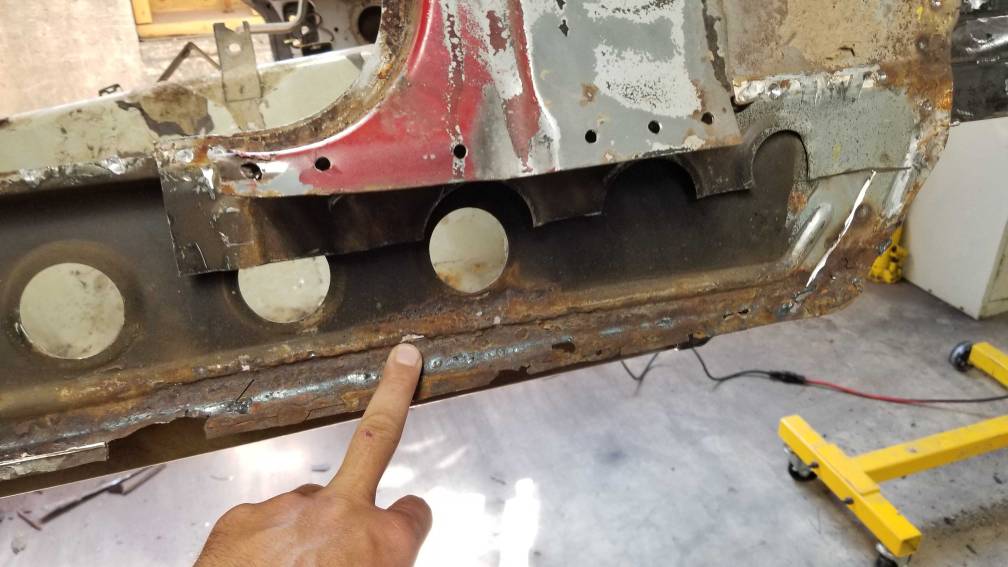

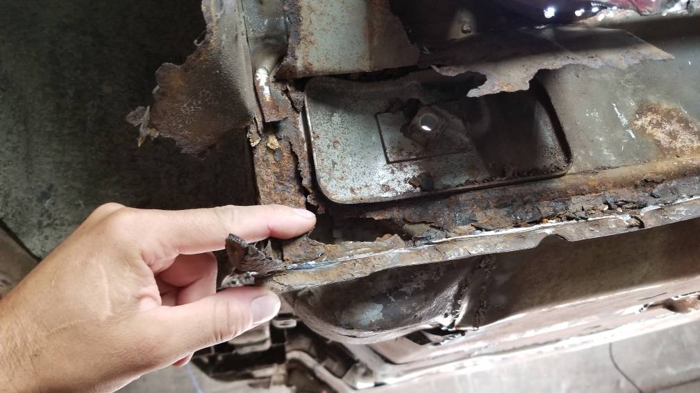

Been awhile since I've posted about the "rust hole" I've finished the front frame rebuild and re attached the inner fenders Nad bow I move back onto the rockers and completing the floors. Which brings me to this, inner rocker around what I assume is the seatbelt bracket is toast but only. On the bottom, should I just cut off the rot on the bottom in the picture and rebuild with some hand made pieces. It appears there's about three layers total here. Inner, outer and then dog leg. Front is a similar situation. It's almost overwhelming but that's cuz I'm new i guess ha. 20180827_141633.jpeg20180827_141729.jpeg1535404947330.jpeg

Kudos for three of the best pictures I've seen that show the challenge of repairing the Z dogleg.  This seems to be the single most important and consistent repair area for a Z and yet no  one manufactures a repair panel kit to address the problem.  If these were Alfas or Porsches, someone would be making the kit.  Disepsyon is a very talented guy, but he's not interested in making 100+ repair kits.  We really need someone like MSA or ZCar Depot to step up here.
I spoke with dispeyon a while back. Guys got talent for sure. In terms of the middle piece at the front that I've cut off I'm just gunna form a sheet metal patch minus the holes. The challenge I have in my mind is recreation of that lower sill/pinch weld area. Part of me wants to forgo the triple deal and just use a thicker guage under the seatbelt bolt hole and then tie the already heavier guage tabco rockers into er. Either way, I think it will be stronger. I generally don't make things less than before ha
