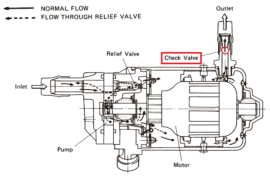

It might have just been leaking through the pump, backward.  There's supposed to be a check valve that would not allow that, but, as I said, I always confirm.
If you posted a picture or told what kind of pump it was we could give more suggestions.
