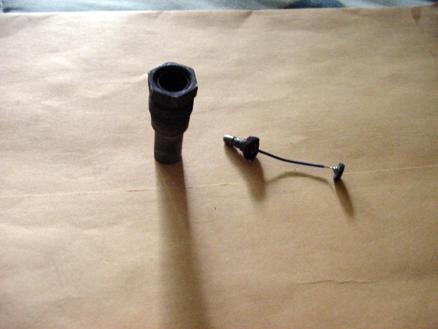

Would you believe the connection pin for the coolant sensor (for the gauge) pulled out!?
I had to replace the bullet connector and thus the whole wire, and while I was pulling out the slack, the thing suddenly got loose, so I kept pulling and there was the end!  FYI, the pin has a wire that goes through the sensor body, to the base of the sensor, where there's a little washer-like thing that probably generates the resistance for he gauge.  The sensor is hollow.   It's not leaking coolant.
Would I believe it? Absolutely.  Haha!
The sensor shell is what they call a "thermal well". It's essentially a dry cavity that is inserted into whatever fluid you are trying to measure. The well keeps the sensor segregated from the fluid. That sensor actually makes it's seal at an angled face on the body about halfway down the shank. The threads are on the dry side.

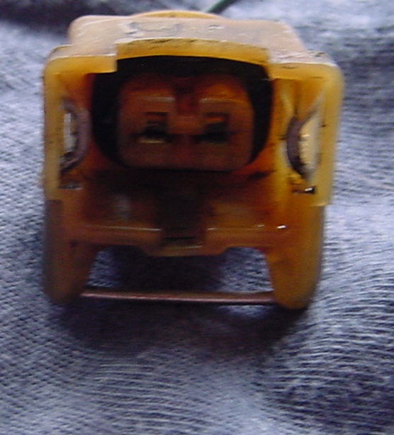

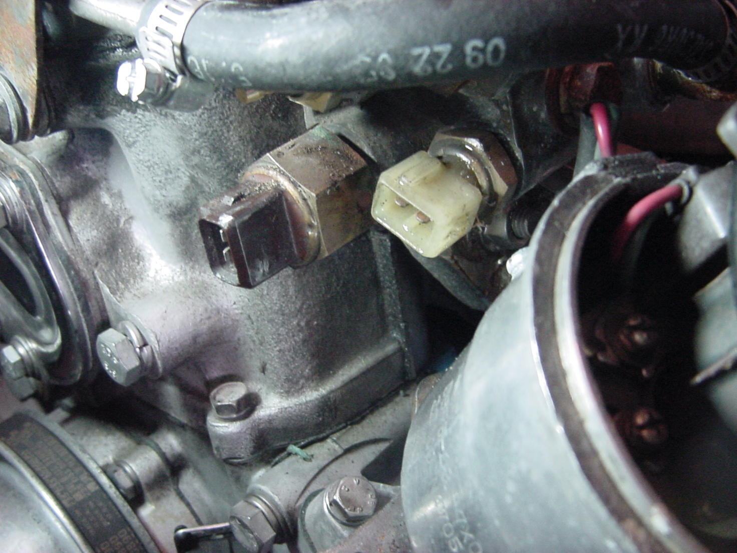

I just took a photo of mine.  It has the groove centered on the old connector, as you see here. So I will try to make  an off-center groove on the connector I just wired on, and if not successful, I  will file off (what's left of) the old off-center tab.  But in the long run, I think I will see if I can get the correct sensor & connector, just for a little piece-of-mid.  Maybe someone can identify a source for the correct sensor & connector.)
It's no wonder the thing was a PITA to get off, and the other slipped off easily, after pressing the retaining clip.
The second photo is of the sensor itself.  I'm not sure it it's the original sensor, because I replaced several including the thermotime switch  many years ago.
