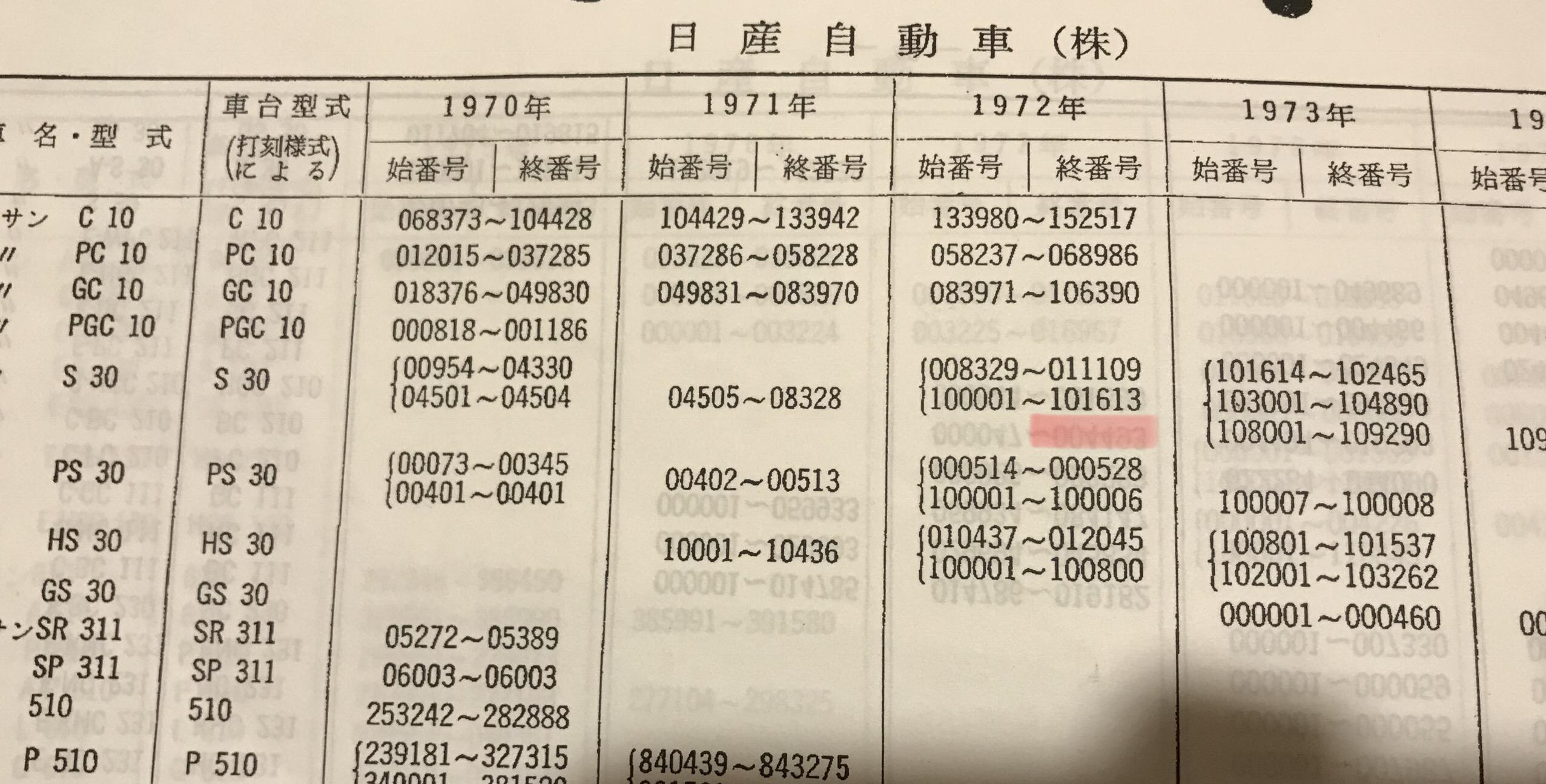

Hi scotta , I do not know I will be able to answer your questions, but here are some pictures what I have.
Your car looks like late 1972 built, as we can see the last chassis number for 1972 is S30-101613 , your car S30-100698 could be built in September or October .
Unfortunately The service bulletin Sep 1972 ( guide for the changes , this time created new chassis number starting from S30- 100001) does not have a wiring diagram.

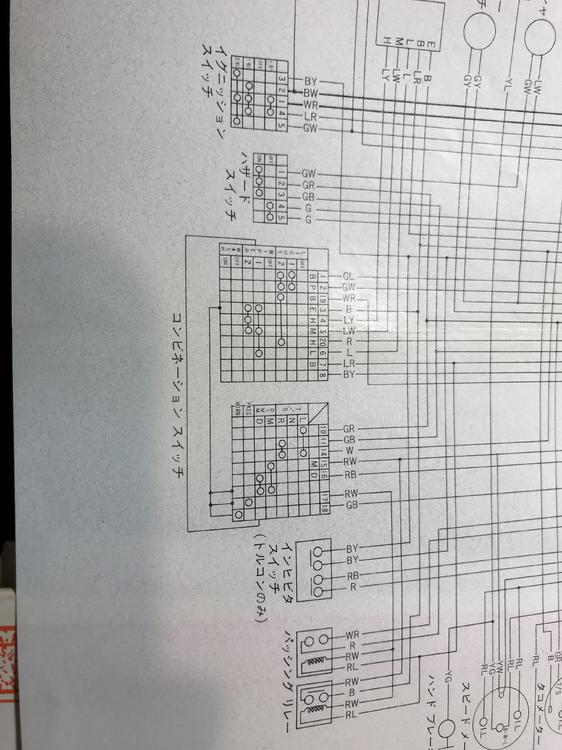

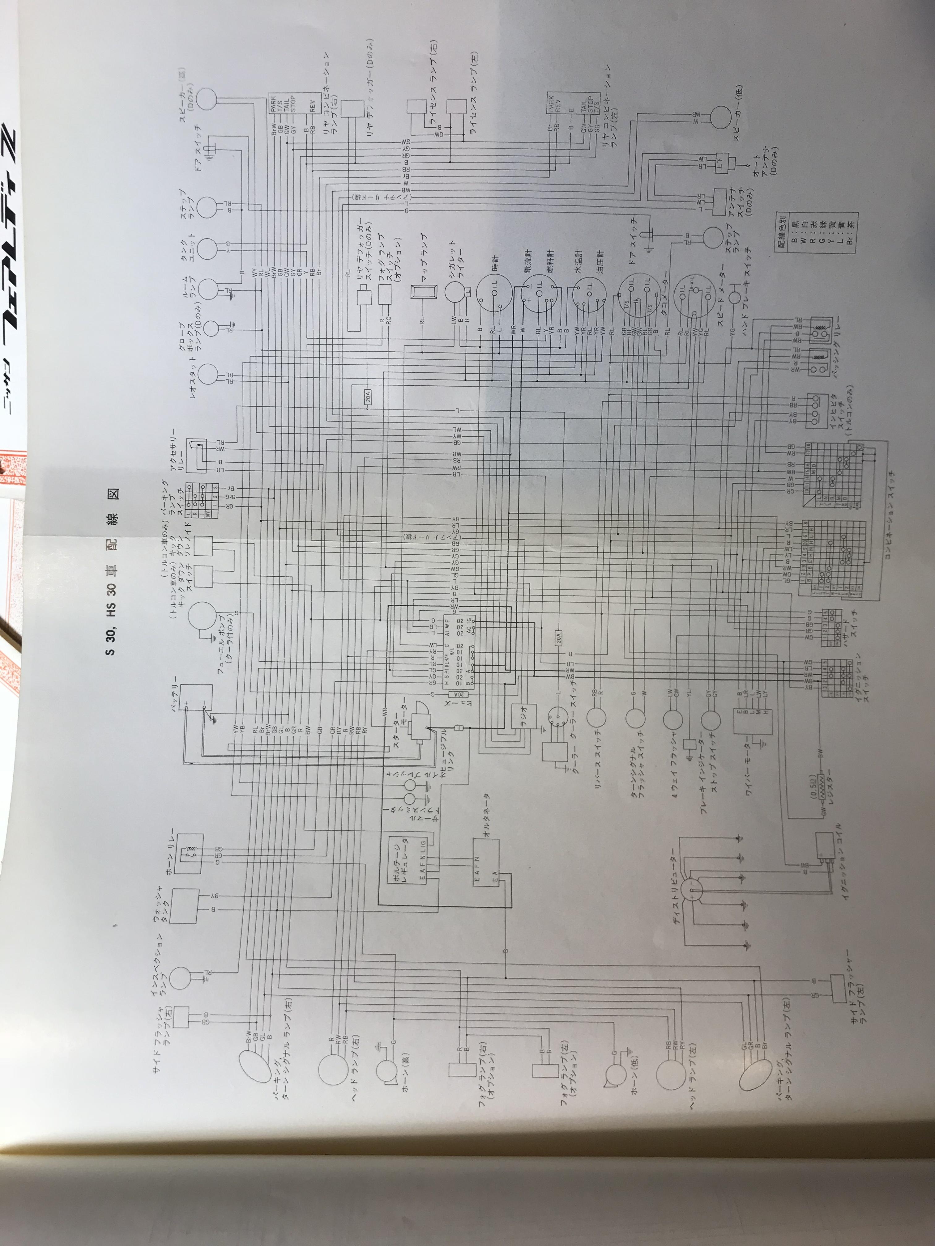

But can we use this, a diagram for Oct 1971 ?  Because the headlight switch and the turn signal switch are basically the same up to Sep 1973 as well as the flasher units and the flasher switch.
However, harness connectors had a big change at Sep 1972, they went 10 pins for the dash harness which connects to the body and engine harness.
Sorry for poor quality of the pictures,
hope this helps.
Kats
Edited by kats
There's a "flash-to-pass" circuit in that diagram.  The Swiss 260Z we had in the shop had that feature and I've heard that the Fairlady's did too.  Check that circuitry and it's associated relay.  The USA models only have the HI/LOW beam selector (switch) associated with the turn signal lever.  Maybe something is mis-wired so the turn signal switch is setting the flash-to-pass relay.

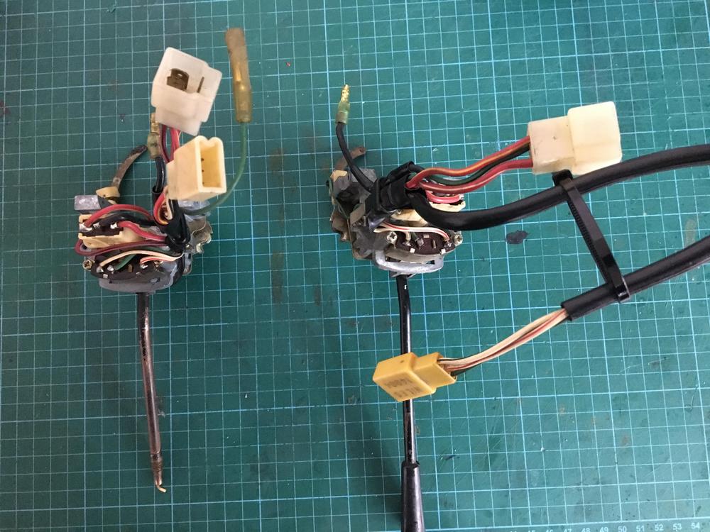

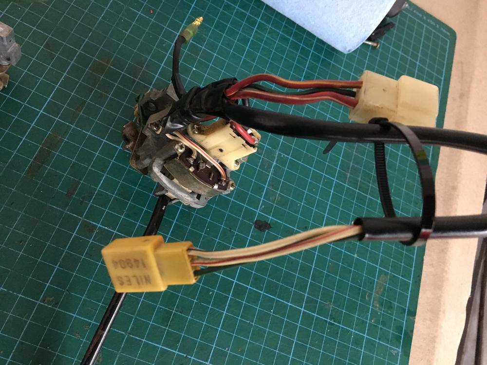

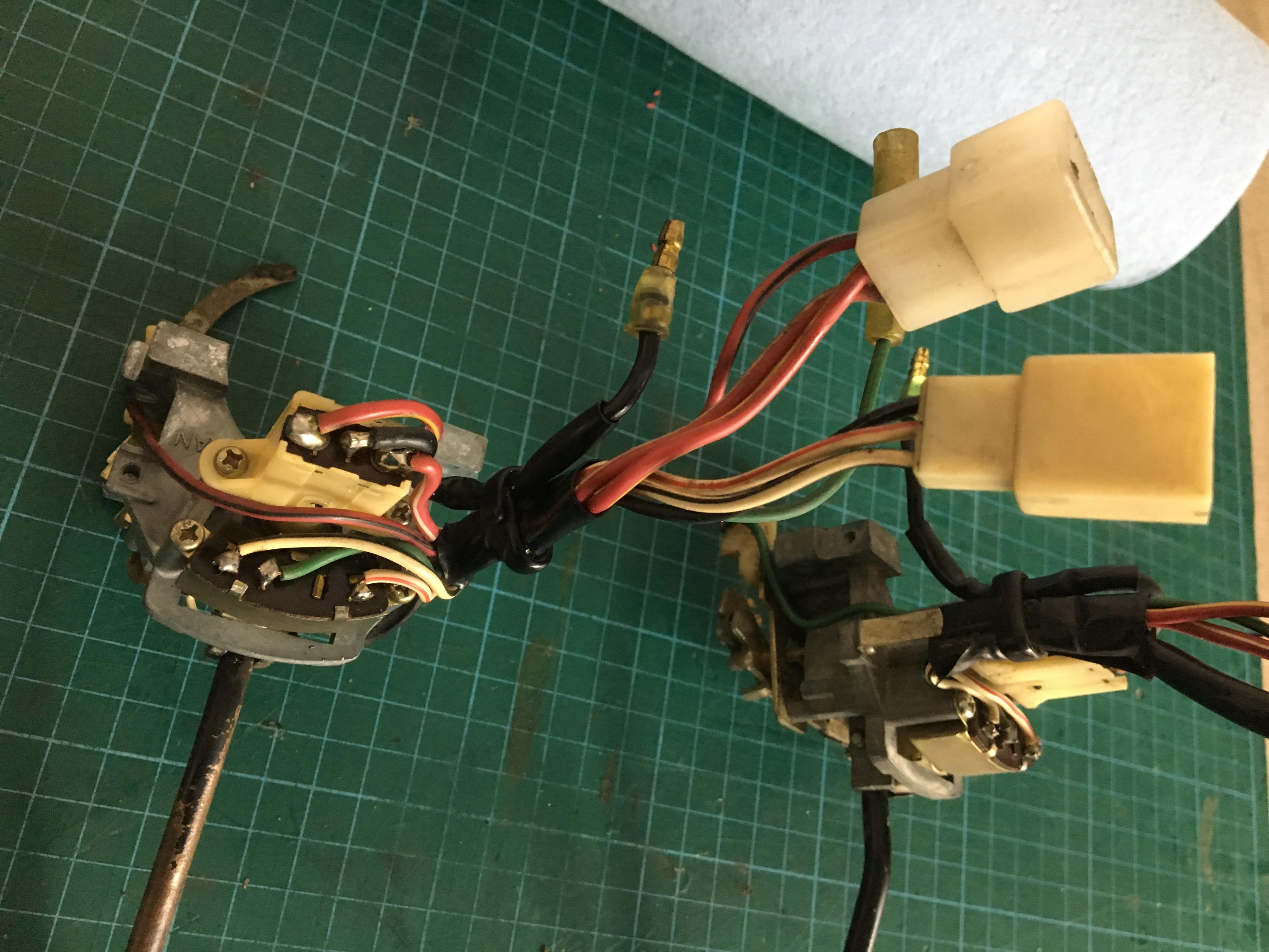

Problem solved. Thanks to the wiring diagram and the 'flash to pass' circuit nudge.(Thx Kats & cgsheen1)
Turns out the previous owner had installed a 1973 US turn signal (he was using that as a parts car), and just plugged it in.
Turns out the wiring is different between the US 240z and JDM Fairlady Z.
Attached for reference is JDM version on left, US version on right. Note the turn signal plugs left and right wires are the same but the flash to pass wire is on the JDM one.
A clean up of the JDM version, rebuild the switches and reinstalled and all working now.
