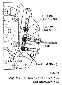

This should help you out
This is for a four speed, but it is the same layout for the five speed transmission. Fifth is on the reverse fork rod.

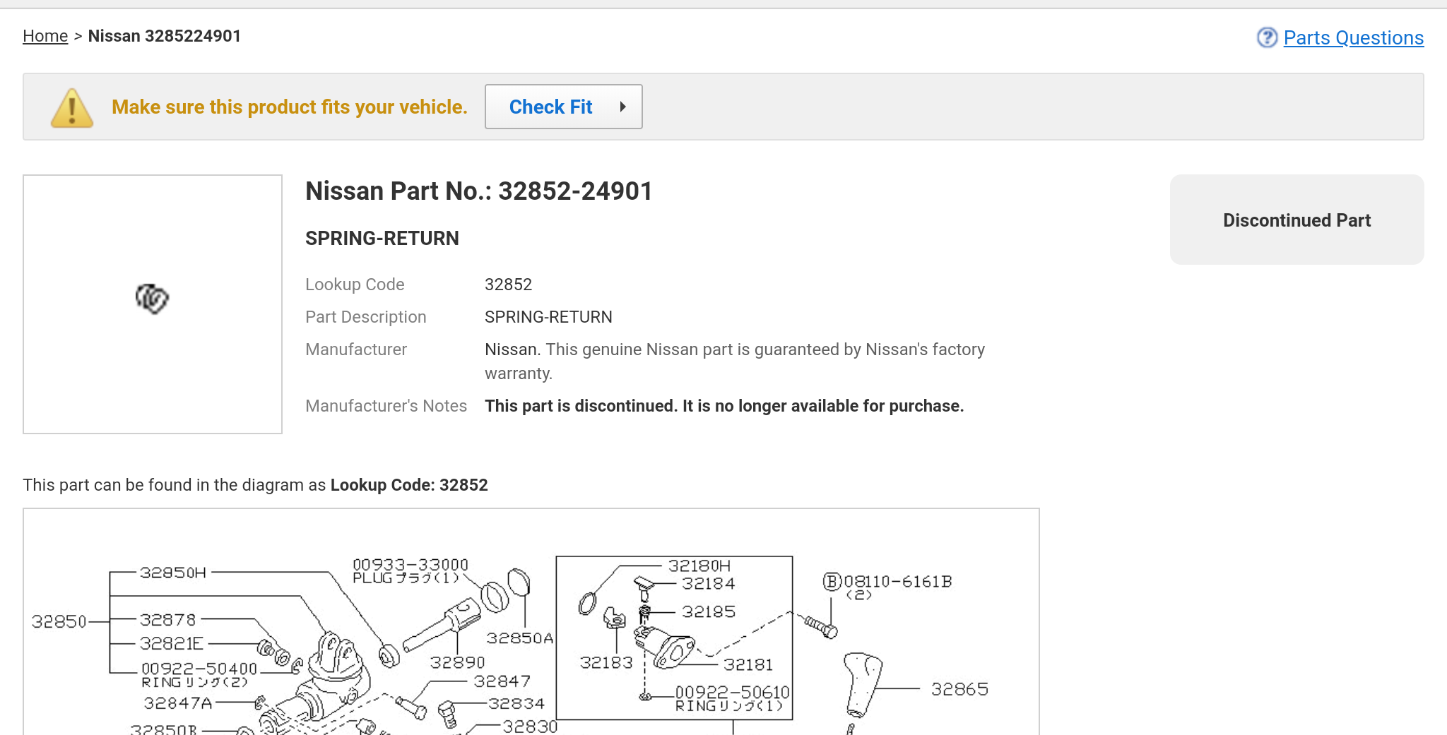

Courtesy nissan list them now as NLA.

I just google the parts again to see it they can be purchased anywhere. The original part are NLA. Looks like its time to hunt for and alternative supply.

Thanks for great picture! Perfect. My issue was similar. It would pop out of third when I lifted to brake at 7400rpm.
My planned solution - put a ball bearing on top of the spring and use washers to position the bolt. Too much tension and you can't get it in gear. Too little and it pops out. A Goldilocks situation.....
