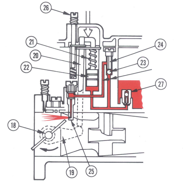

I don't think my OER's are setup like that; what Carbs is that diagram from?

Accelerator Jet Notes:
1. Since the accelerator jet outlet (25)  is below the fuel level in the carb (27 area), fuel can siphon  out when the weight (24) and ball (23) do not seat.  This usually happens when the engine is running (vibrating) and jiggles the ball and weight.
2. At WOT, the air flow in the throat  can pull a steady stream of fuel from the accelerator circuit.  This extra fuel will add  to the fuel from the main system to enrich the top end.
You are correct, sir.
Checked and everything is seating properly.
