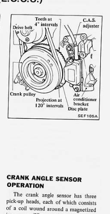

Looks like a 1981 turbo engine damper.  Might even be an L28 in that 240Z.  The wheel is there but where's the sensor?  See picture.
Nissan used the crankshaft mounted wheel for one model year then went to a distributor based system.  But there are a few aftermarket systems out there.

I didn't realize that the turbo had come with a crank angle sensor, interesting.  Still doesn't explain why it's on a 1973 240Z with "one owner 1973 Datsun 240 Z with the original six cylinder factory four-speed, 66,212 original miles"   ?
Probably just swapped an 81 turbo damper on to his L24.  They'll interchange.
