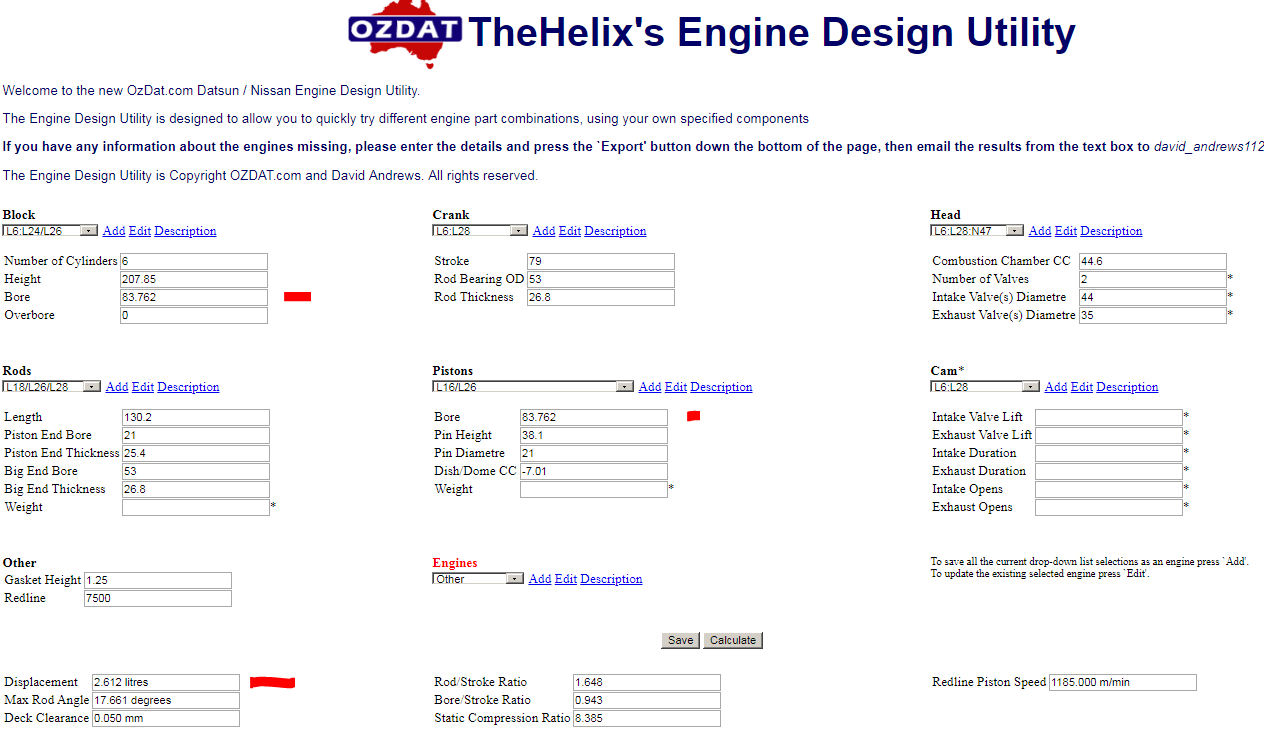

You should be able to measure bore and stroke from the bottom.  Might take some ingenuity, but the pistons are right there and you can turn the crankshaft.
Maybe that engine sticker is old and they didn't remove it.  I don't think that you can get to 3.0 liters with just a 0.762 mm overbore.  Which is what the sticker says, .030" = 0.762 mm.  And I'm not sure that you can bore the L24 up to the 89 mm you need just to get to 2.9 liters.

If the stroke is stock L24 then you have a 2.4 liter engine.  Not stroked, not 3.0.  Not sure who Darcy is or why they are telling you it's a "stroker".

If the L24 is a stroker then the cankshaft will have a "V07" on one of the counter weights. Also the block normally has to be clearanced for the bid end rod bolts to clear. It probably won't be a 3.0 stroker unless they punched a big hole in it! I, like Zed head, don't know if you can punch an L24 that large. Most people start with L28 blocks to make stroker motors...

Strokers in Z motors are normally both increased bore and increased stroke. Almost everything above 2.9L is a stroker of some form. Cliff is just stirring the pot some. There are many variations on the Z stroker motor...

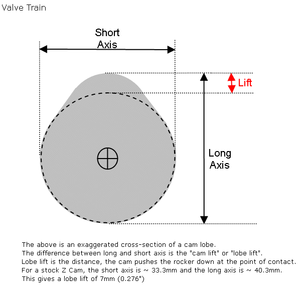

Hey again z peeps! Any thoughts on identifying a cam that's in an engine? Like is there a way for a regular dude to measure it. I been reading about the n42 head on an l24 with flat tops and while everything sounds awesome with nearly 10:1 Compression I hear about issues with detonation and having to run low advance. I'm just curious if since this engine has a different cam with a bit of overlap to help the issue. I sold that stage 4 its not for me plus I needed a bunch of other parts to go with it including springs pads etc. Any thoughts on cam measurement
