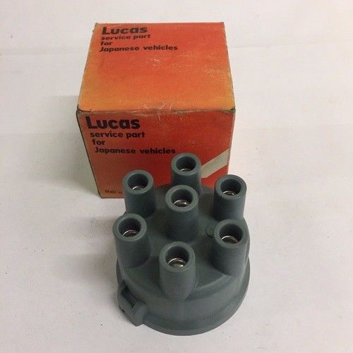

So the color of the distributor cap has been discussed ad-nausium for years.  I say black but there is strong evidence for green.  What is important to me is the brass contacts.  They don't wear out as fast.

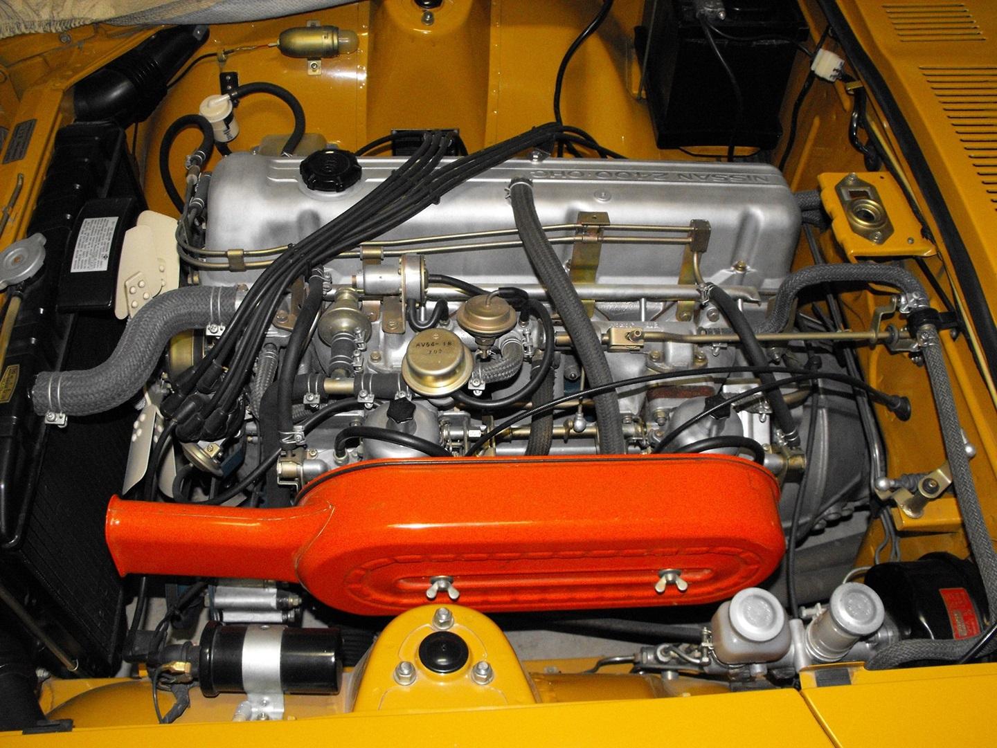

Here is an unrestored engine compartment:
AllintheFamilyUnrestored240Z201511291123-2.thumb.jpg.9bcce640e474adb66d166ed86c4c1177.jpgAllintheFamilyUnrestored240Z201511291123-4.thumb.jpg.d04d36e6003e11637535c68359be86fb.jpg
Wow! That's gorgeous! Thank you for the info. I'll forward the engine bay picture to Rod for reference.
Got it! I'll ask Rod about the contact surfaces to see if they are brass or aluminum.
