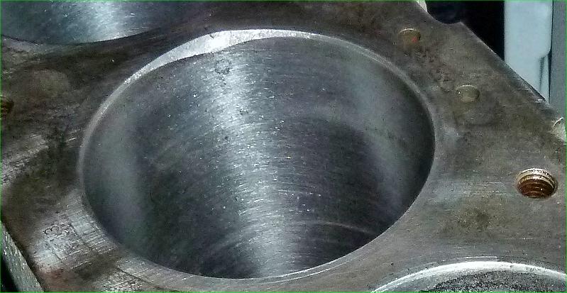

1 mm over would be about .020" per side.  The L26 bores are notched for their bigger valves from the factory, apparently.  Seems like you'd need to do some clearancing.
Here's a Hybridz thread on a similar issue to yours.  @madkaw has done some notching.
http://forums.hybridz.org/topic/70734-notchingbevelingbutterfly-l24-block-for-valve-clearance/
2nd that. It's easy with a die grinder and sanding flapper wheel.

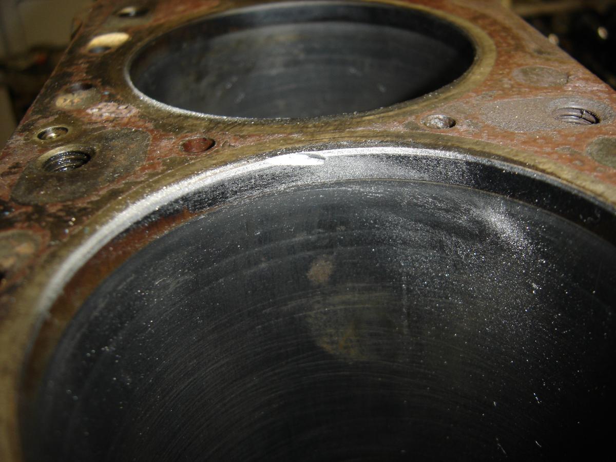

I put my head on the block, chucked the intake valves onto my drill and eased them down into the bores. That scratched enough to know how far I had to grind back. Sorry I don't know the size to tell you for setting N42 on a 1mm over 2.4 block. You might find out reading a bunch of bulls**t but I'd feel better doing your set up "hands on". Not going by internet "alternative facts". LOL
After more reading I found some posts saying a .040 overbore will clear the ex. valve.
They were referring to the L26 head mostly, but the N42 has the same size valve. However the N42 has the larger intake.
Not sure about that clearance.
I do have a shaved L26 E88, so I will just use that head. Wont  be able to tell the difference anyway I guess.
This is going to be put back together as a numbers matching block for resale value when I sell it.
Hopefully I will not have to do that for sometime yet. Age, it gets harder to get in and out of the car every year.
I have heard the 1mm oversize is not a problem with the 35mm exhaust valve, but I would still do what Siteunseen mentioned and test it for myself.
Notching is not hard to do and on a 1mm oversize it would be minimal.

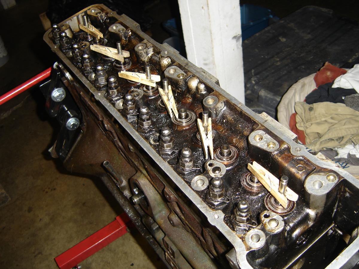

I used a simpleton way to test. Put the head on a bare block and dropped the valve's. If they didn't fall though I'd remove a little more until they dropped free from the head to the bottom of the bore. I held each valve up with clothes pins. LOL
