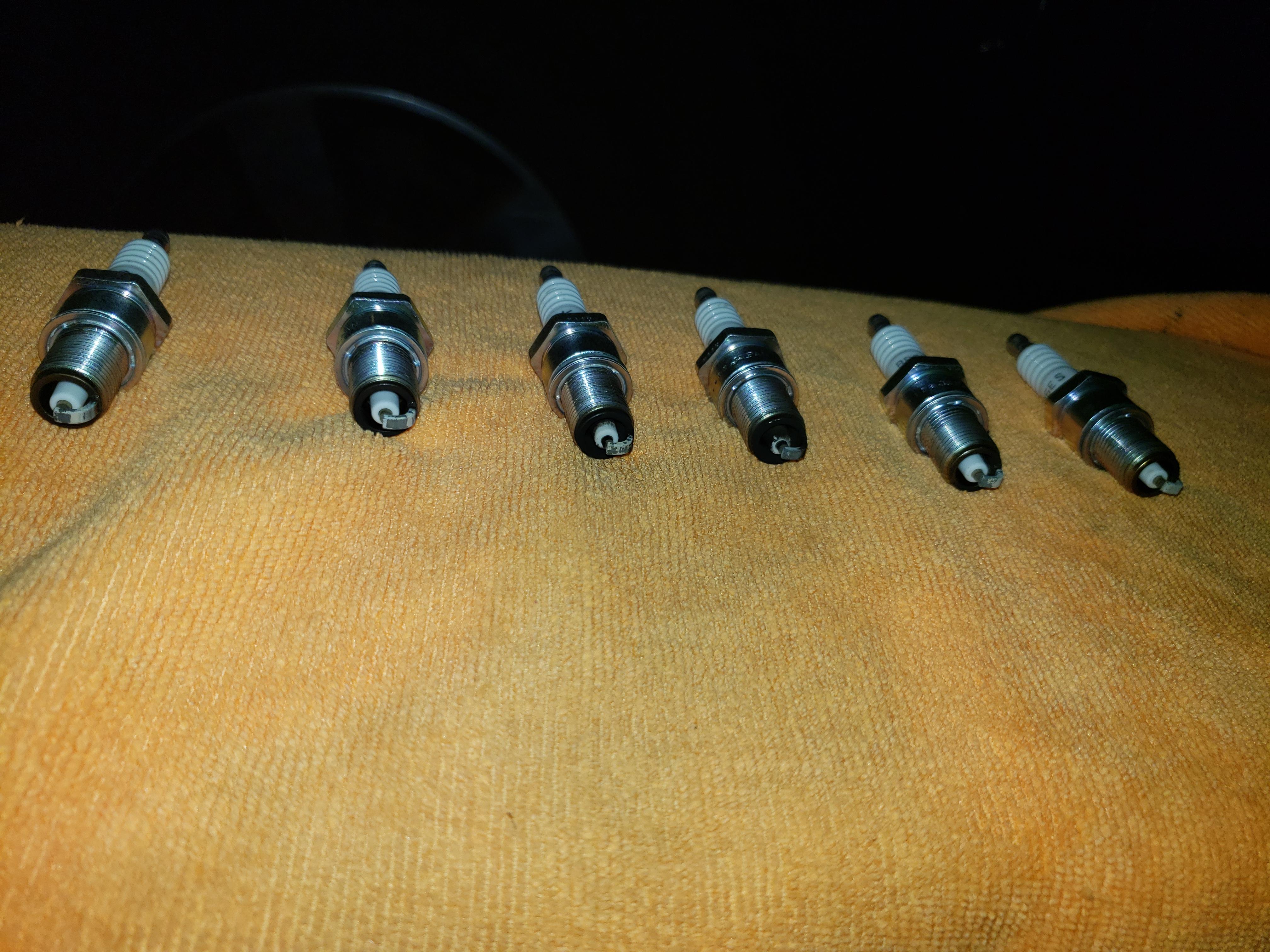

Zed Head Posted September 29, 2018 Share #163 Posted September 29, 2018 I started a new thread on just the unusual pattern of fouling. Somebody might have seen it before. It's weird. 1 Link to comment https://www.classiczcars.com/topic/60072-misfiring-while-cruising/?page=14#findComment-558480 Share on other sites More sharing options...

Johnny wick Posted September 30, 2018 Share #168 Posted September 30, 2018 On 9/29/2018 at 8:43 AM, Mark Maras said: Ok, If you've completed all the tests and found everything looking good put it back together with good (or new) plugs and take it for a run and then let it idle. I'm hoping that you've improved the connections while doing the tests. Let us know. Did a 7 min run some 10 to 20 seconds stops. These were the results. Still have not left it idling. 1 2 3 4 5 6 spark plug order Link to comment https://www.classiczcars.com/topic/60072-misfiring-while-cruising/?page=14#findComment-558558 Share on other sites More sharing options...
