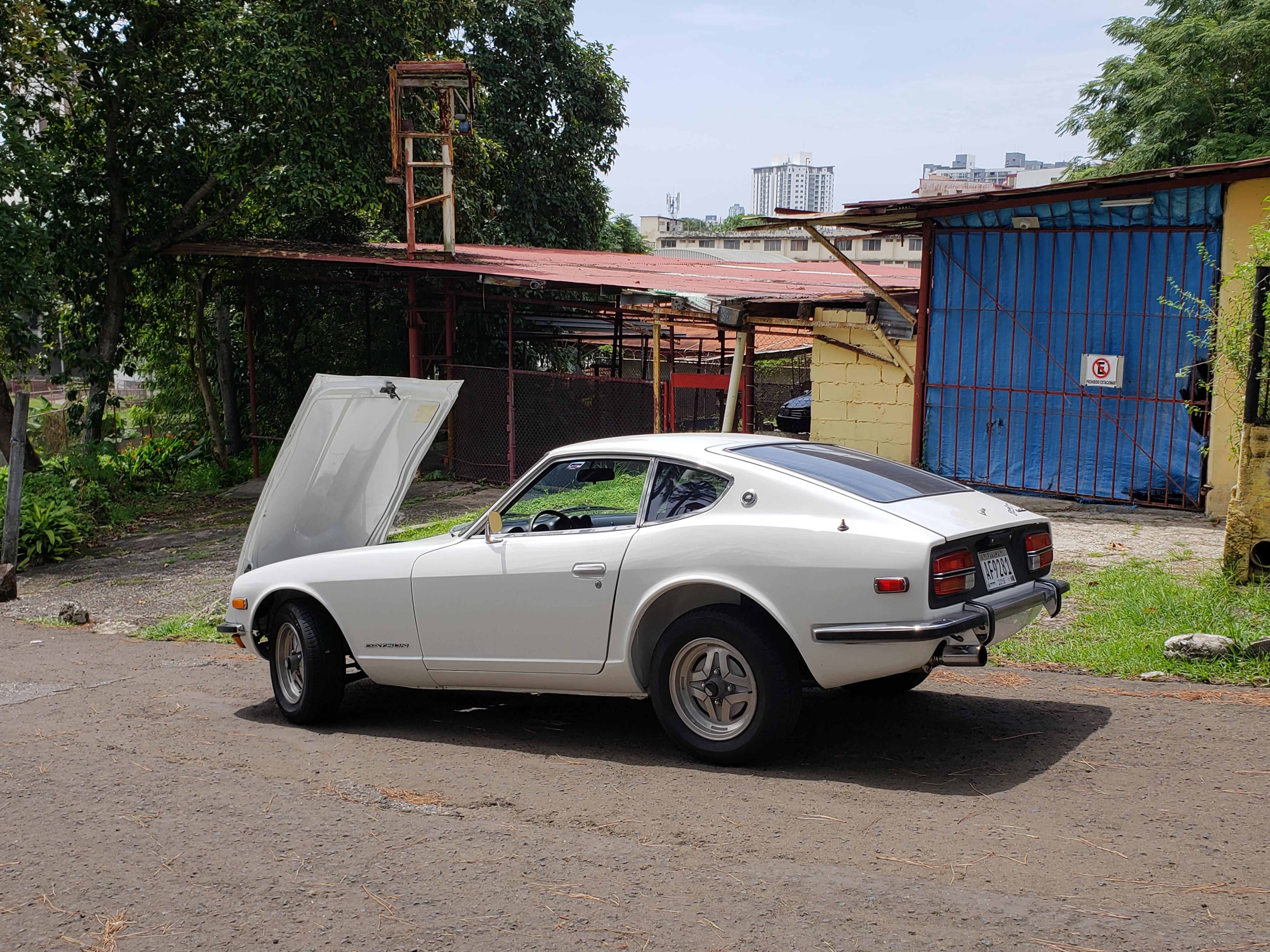

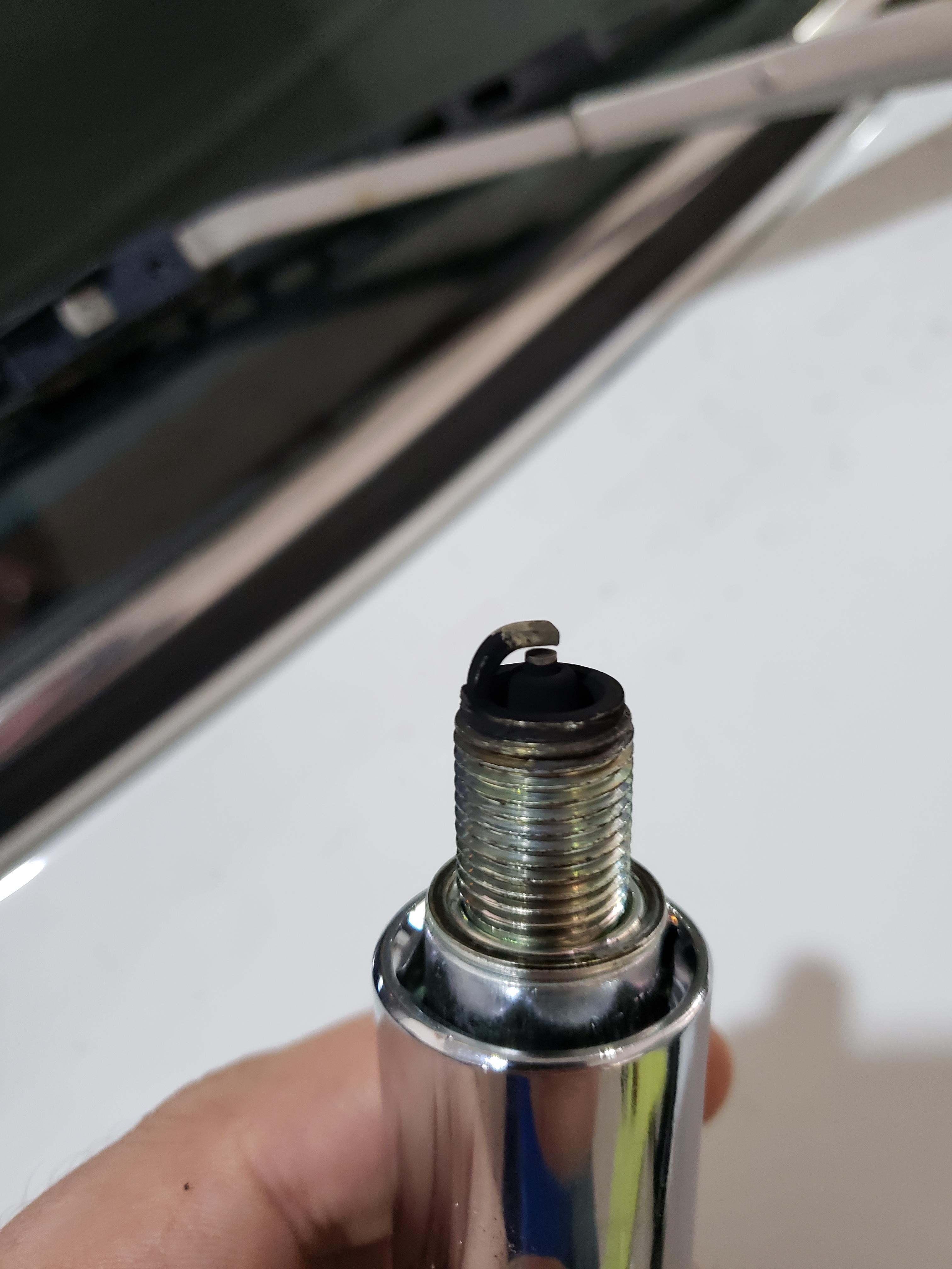

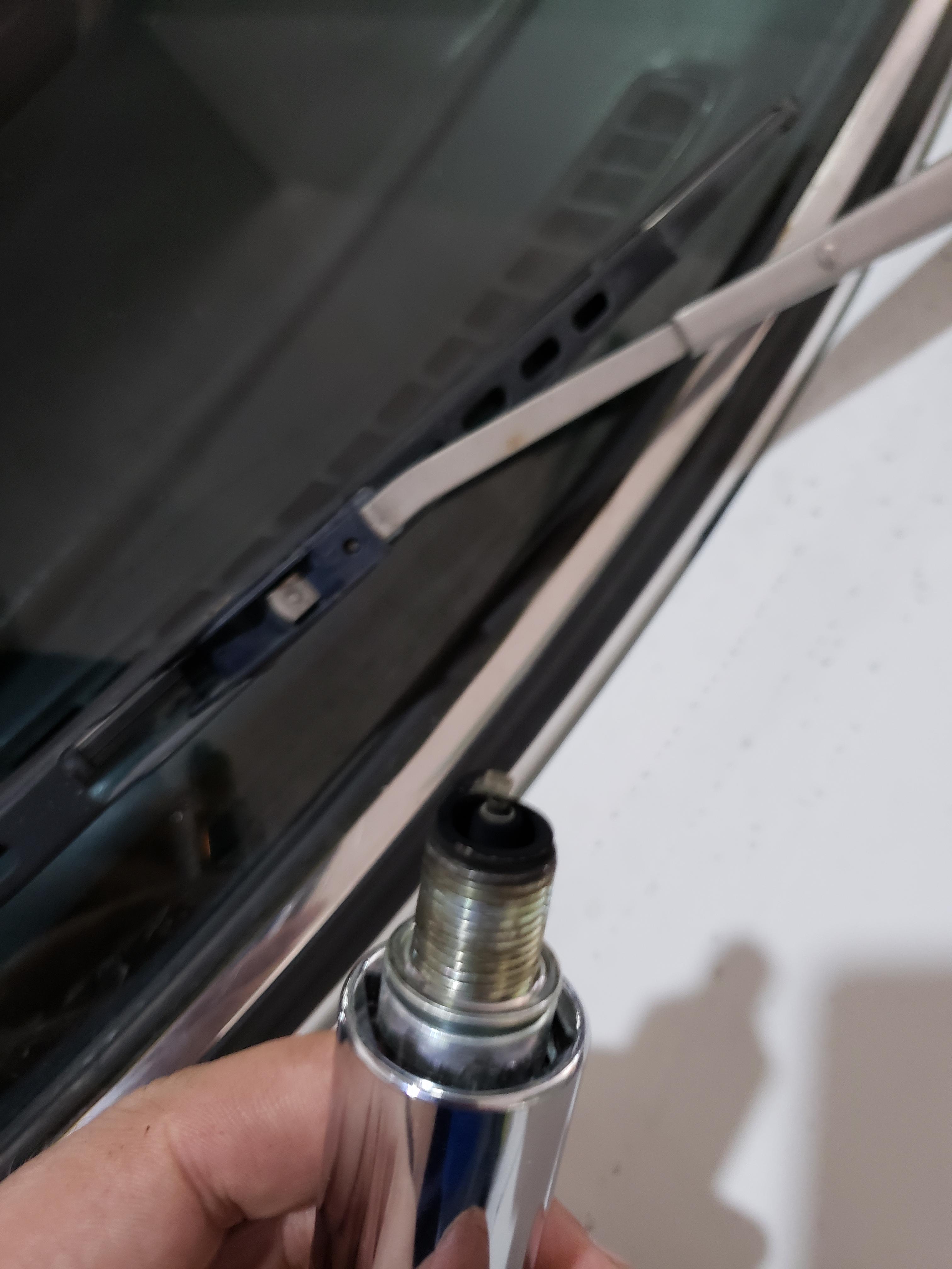

Drove my car on light sunday traffic. Parked and let the engine run at idle for 10 mins with the hood opened. Step on the car and started accelerating. Car misfired a couple of times so when i got home i pulled plugs 3 and 4 and found them black. Is this normal? This is what happens when the car is sitting on traffic at idle.
Mark,
I already did the cylinder compression test and as shown the results were fine. The distributor is set to 14 degrees btdc. What else should i check. Maybe the black fouling on spark plug 4 and 4  is attributable to the camshaft as its not the stock camshaft but a Schneider 274f. Where else shall i check?
