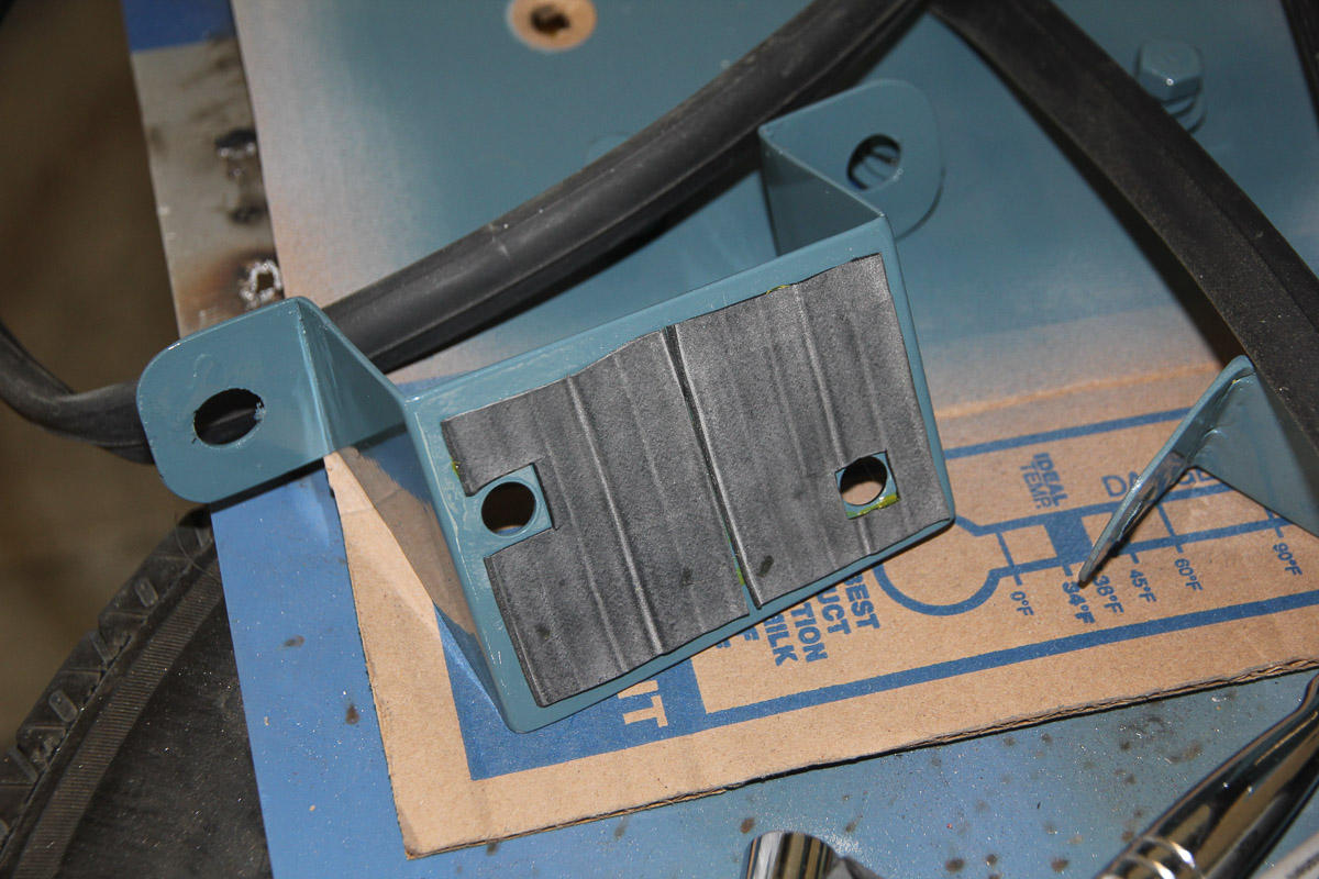

I didn't want that metal on my paint either so I went to Lowes and bought something similar to these. The rear bumper side mounts and the front bumper sides are all I remember needing the rubber.

I made my own brackets for front and rear, so spacers weren't necessary. But like siteunseen, I didn't want anything rubbing directly on the paint, so I cut up a bike tire tube and used that on the rear on the bracket and side mounts.

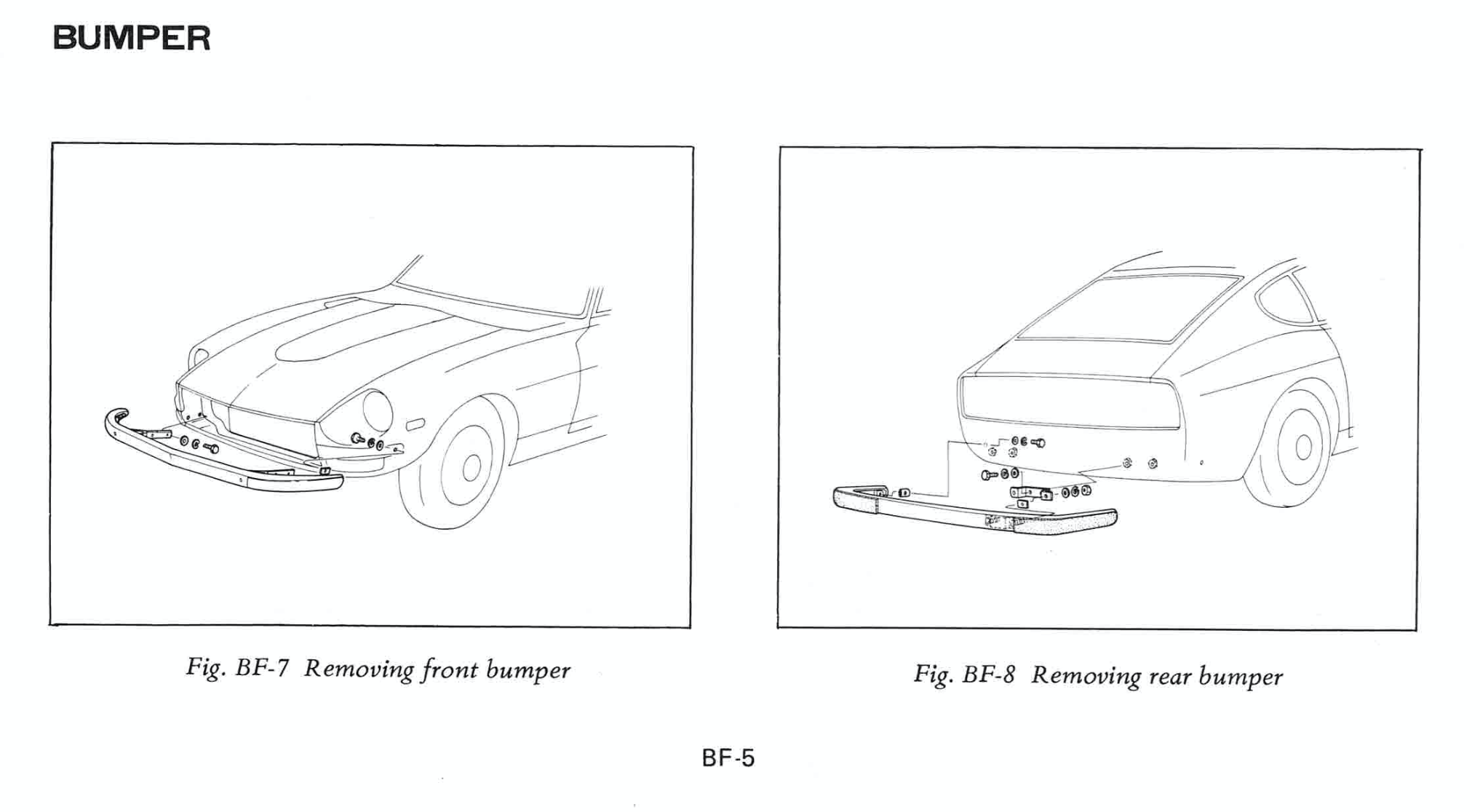

After reading your post SteveJ, I beginning to think that special brackets are needed for the 78 280 conversion.
You'll need brackets like this for the front: https://zcardepot.com/products/front-bumper-conversion-bracket-set-ss-280z-to-240z
For the rear: https://zcardepot.com/collections/exterior/products/rear-bumper-bracket-conversion-280z-to-240z?_pos=1&_sid=2131235fb&_ss=r
You'll probably also need to drop the tank to remove the stock bumper mounts.
