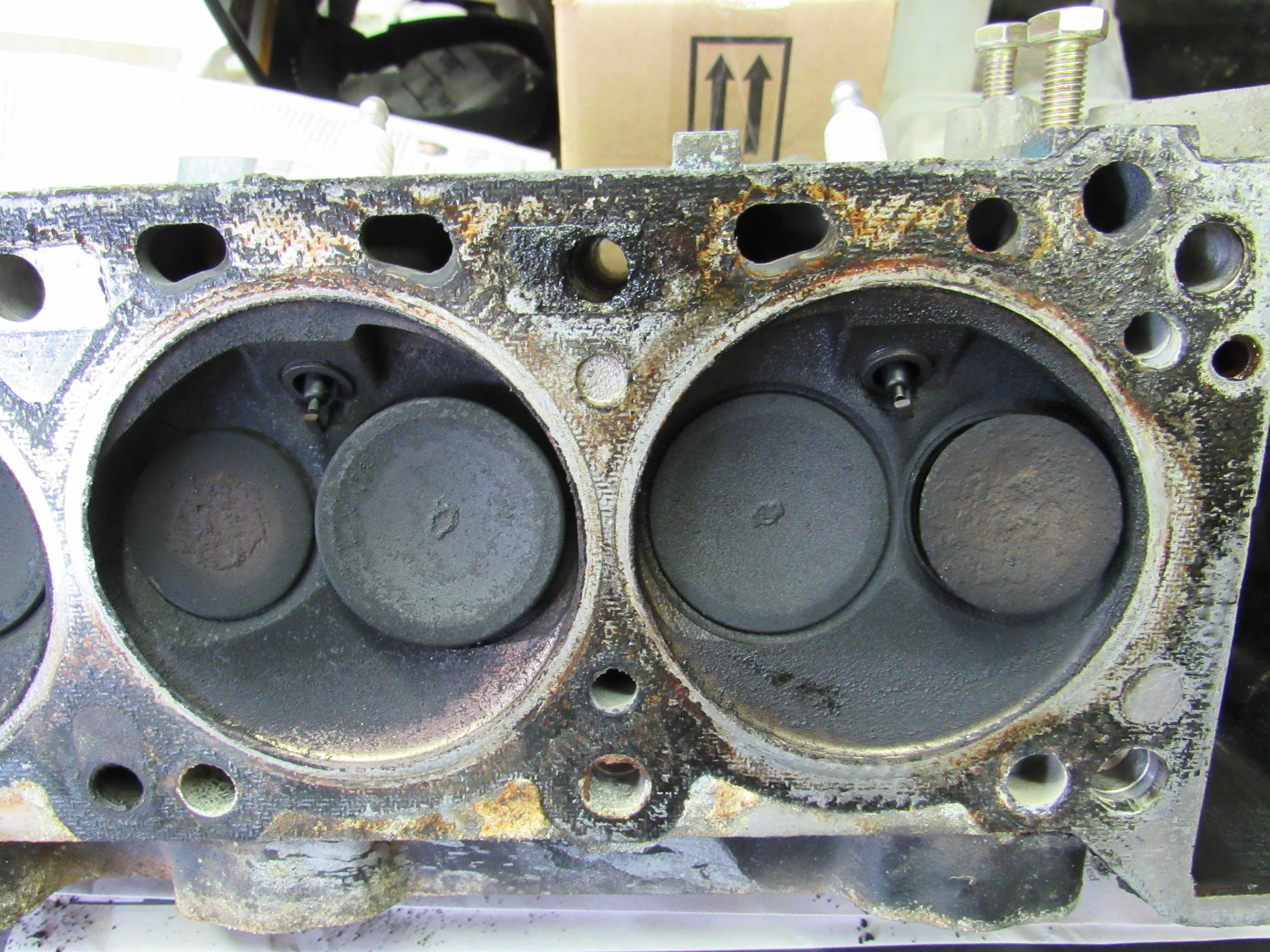

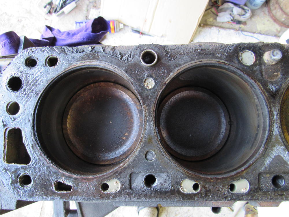

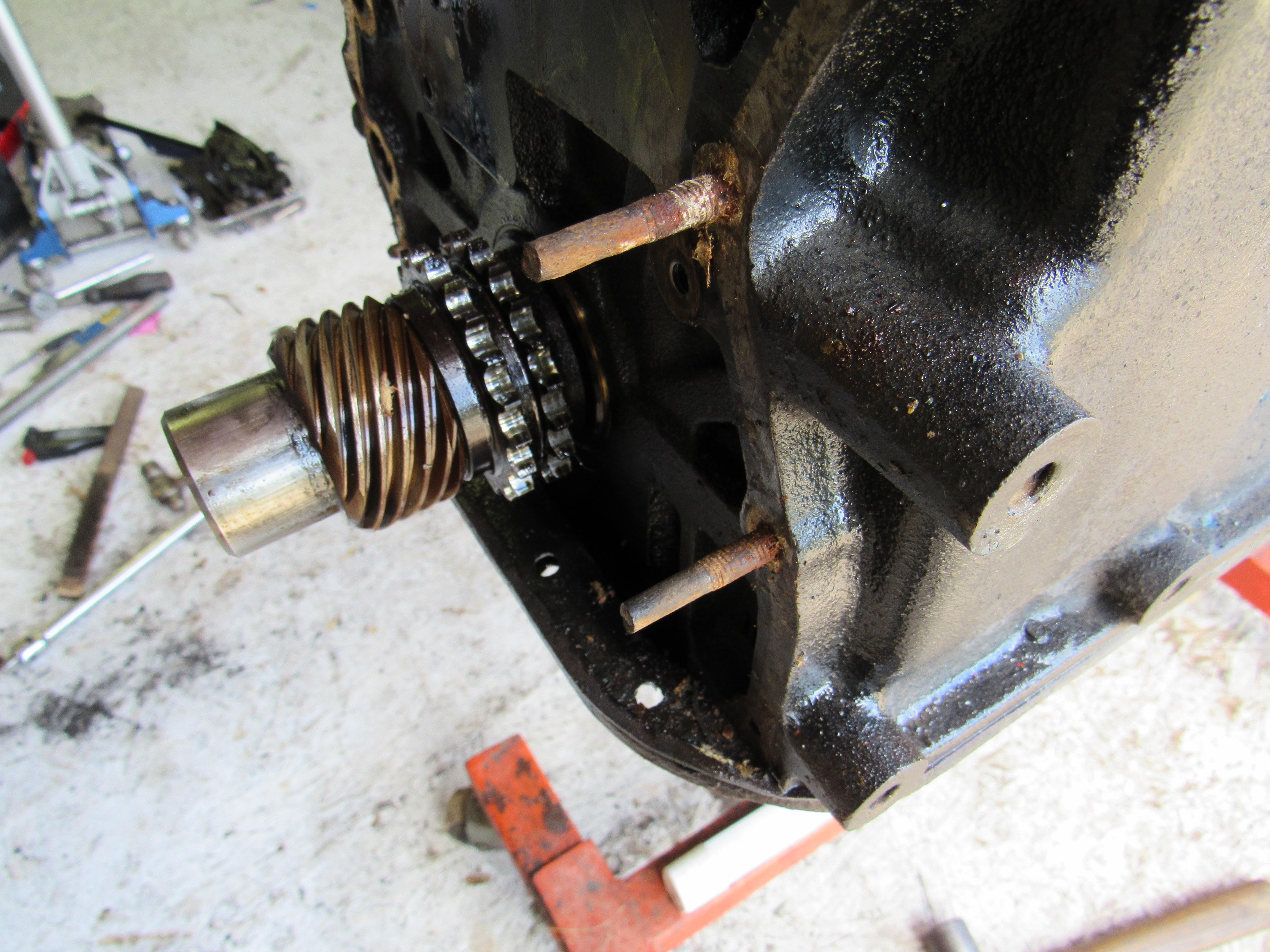

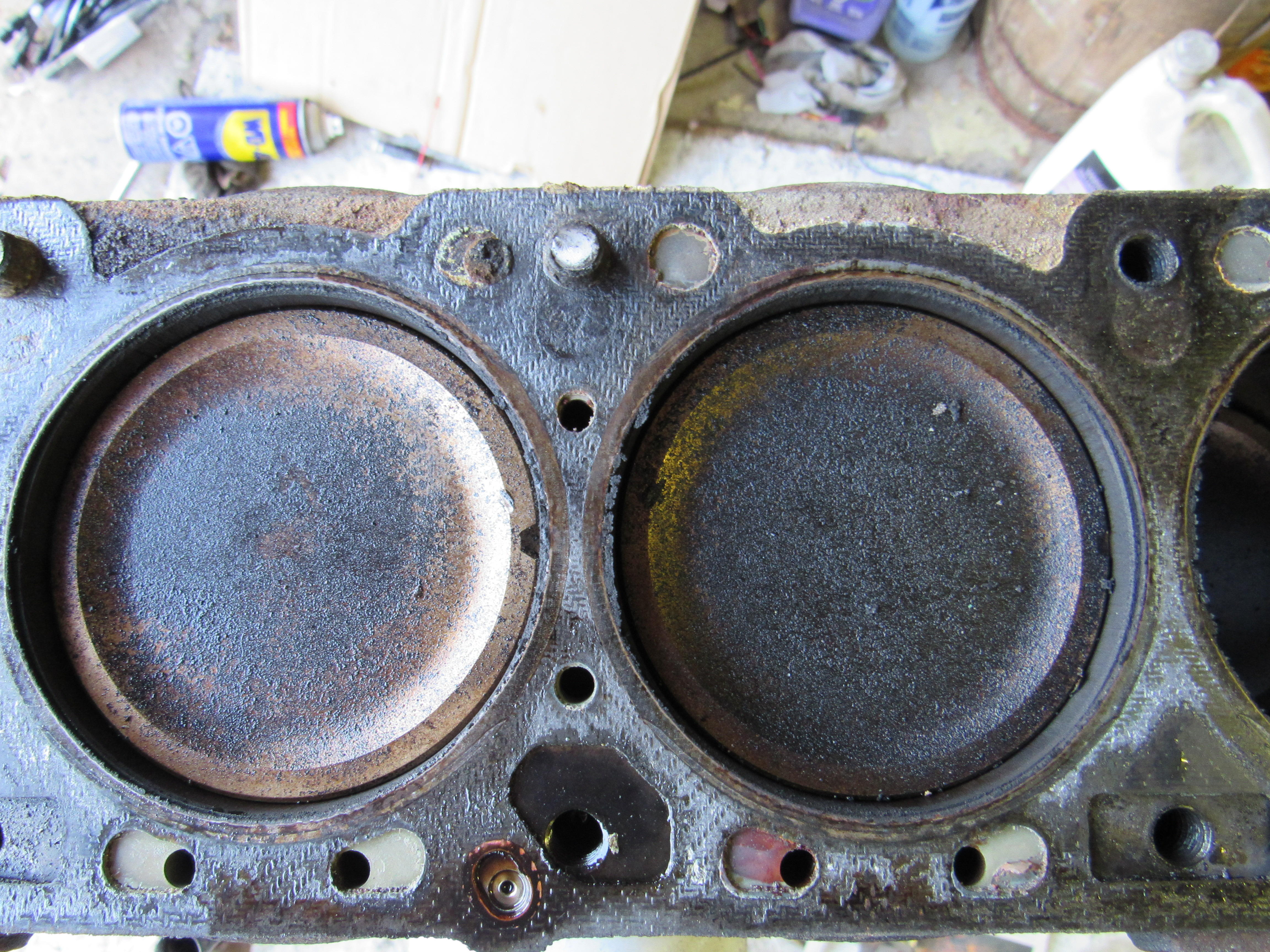

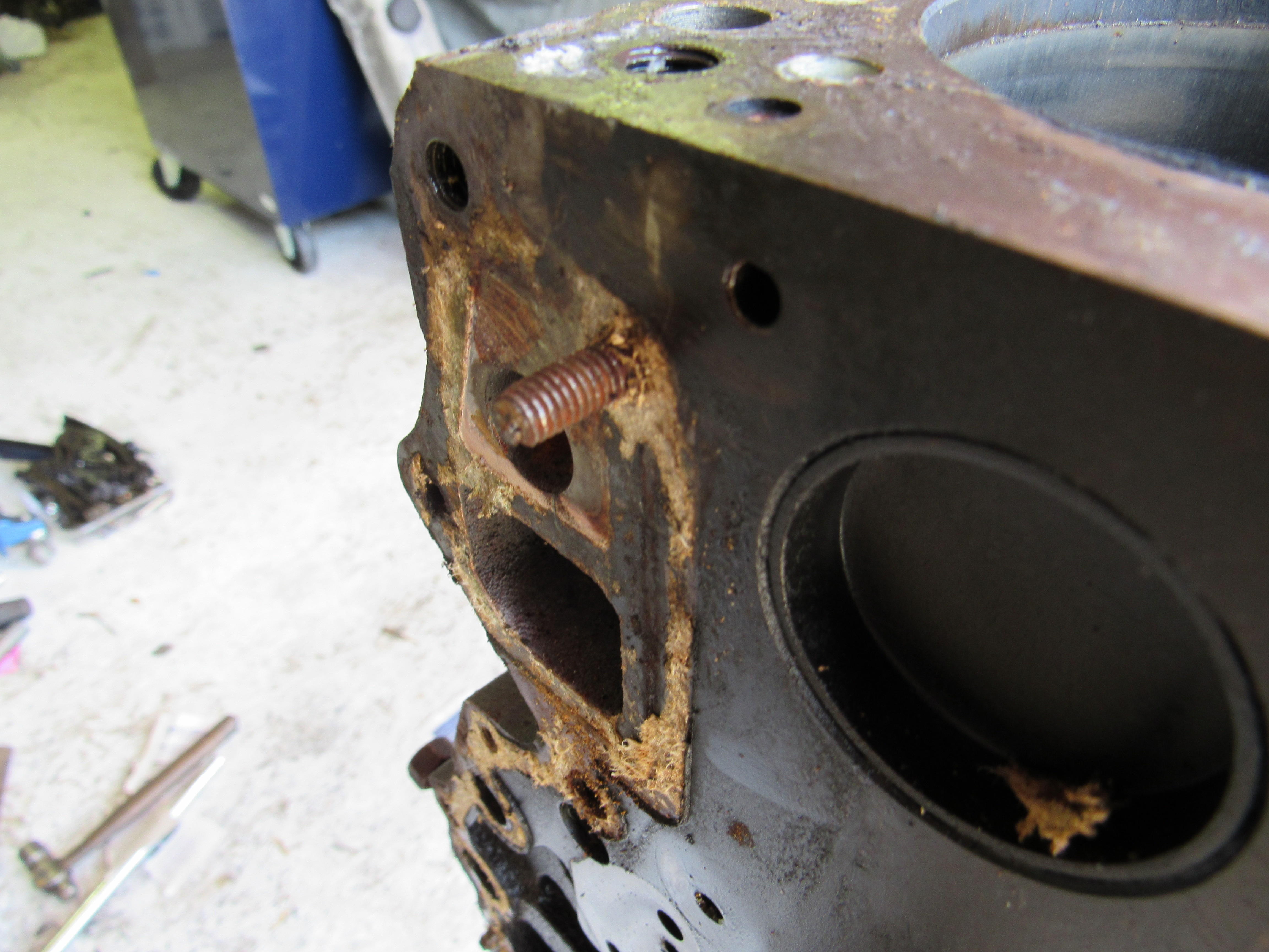

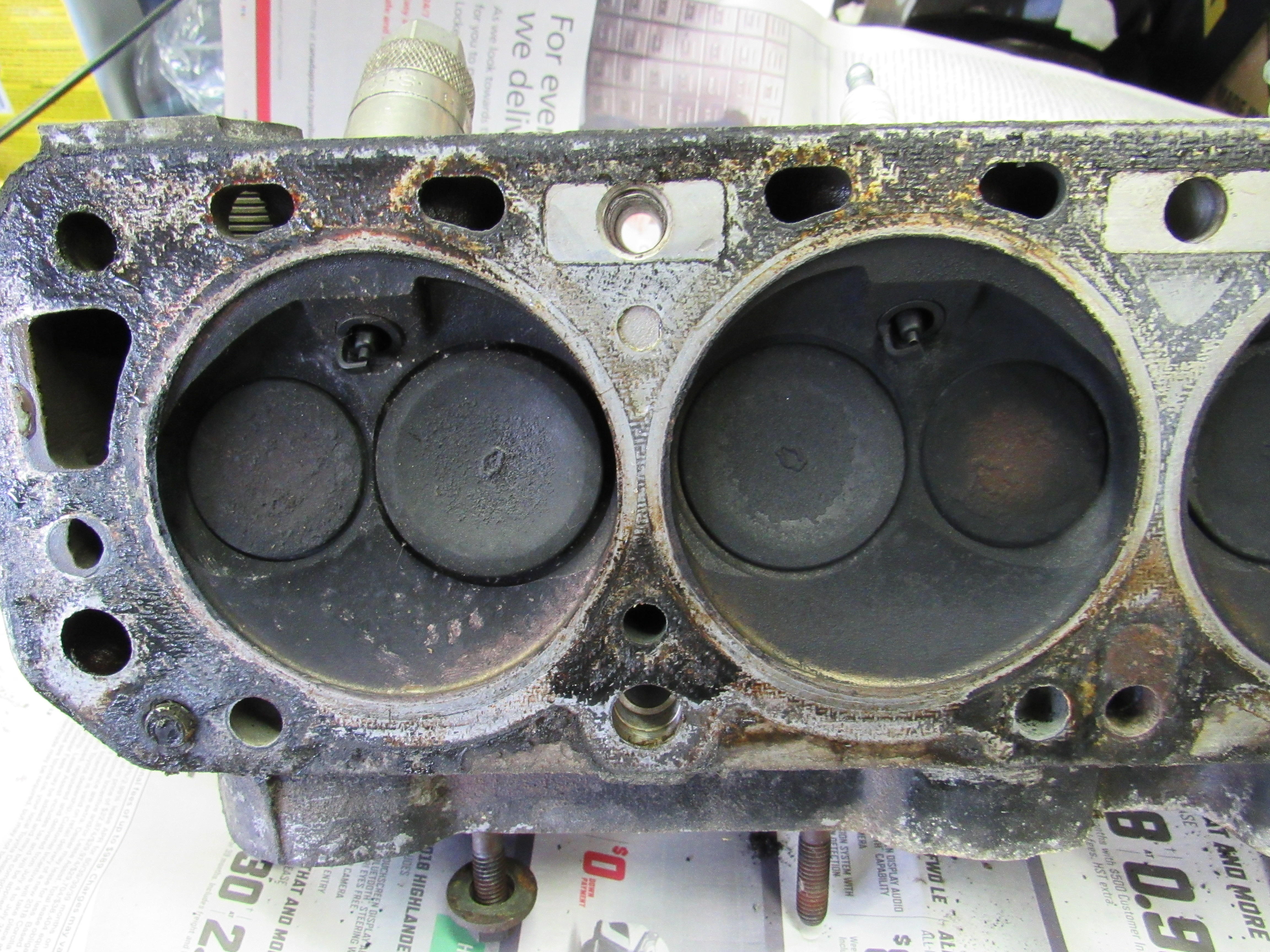

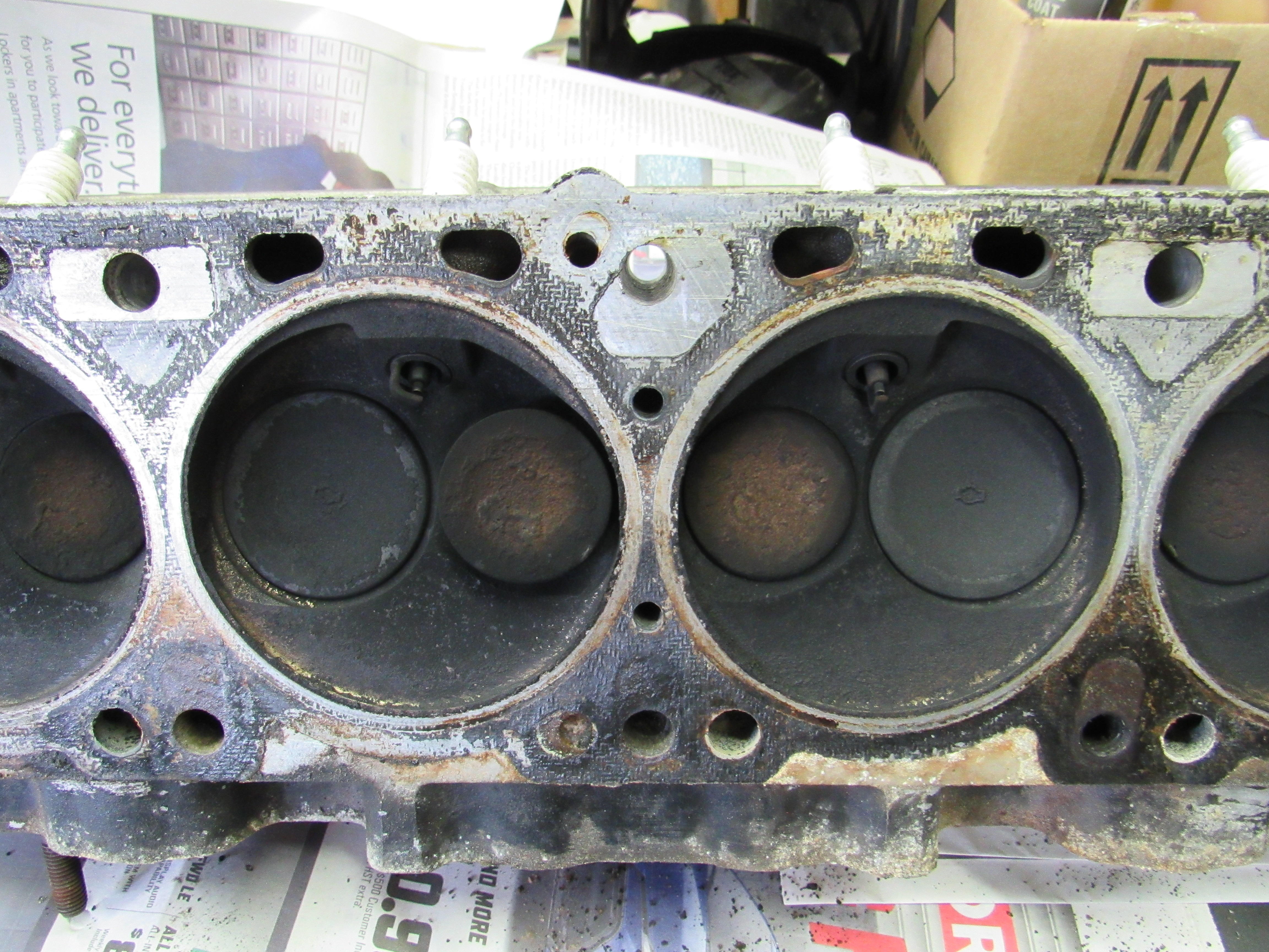

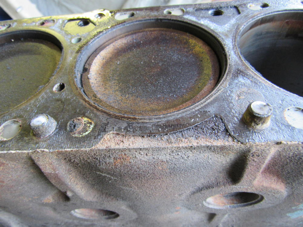

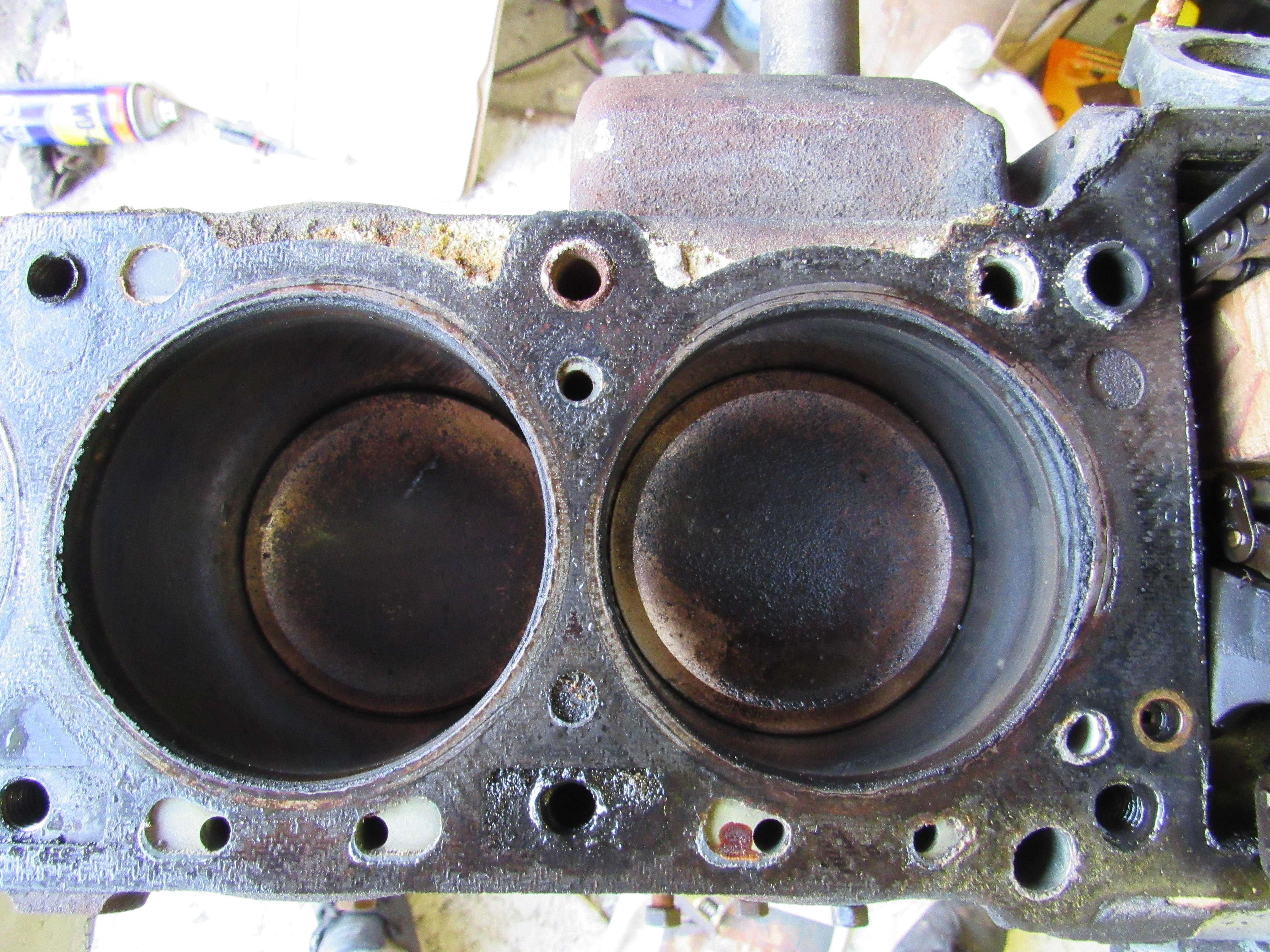

All right, I got the head off the engine today, pistons look very clean for over a 100k miles, valves are pretty caked with carbon. I have never had a head bolt break on me before and two head bolts broke on this engine, one on either side of #4 cylinder,  also there there are four other bolts that broke, 2 in the timing cover and 2 in the front of the block.  There is about 7-8 other bolts that have broken of on the body so far, never had such bad luck. I did sit for 20 something years.
pics go from front to back on the block and the head, last pic in the broken studs. Should I attempt to weld nuts on to the stubs of the head bolts or should I just take the block to and engine builder or someone who does this all the time?
PB Blaster, Vise grips, taps from a dead blow hammer and small propane torch worked for me on the head bolts. It's worth a try but if you're going to take the block in for boring or decking, then I would share the fun and let them do it.  They have proper equipment and it's no big deal for them.
Take off the headgasket and see what shape the stub is in.  I did almost exactly what gwri8 described on my one broken bolt.
The problem with letting a shop do it is that they sometimes charge by the hour.  And it can take a while to get them out.  I'd clean up the interface and see if any rust breaker can get in there.  The shots with a hammer help break up the bond.  I didn't tap mine I gave it some good hard knocks.  It came out eventually.  But I had more to work with.

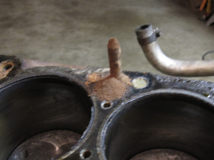

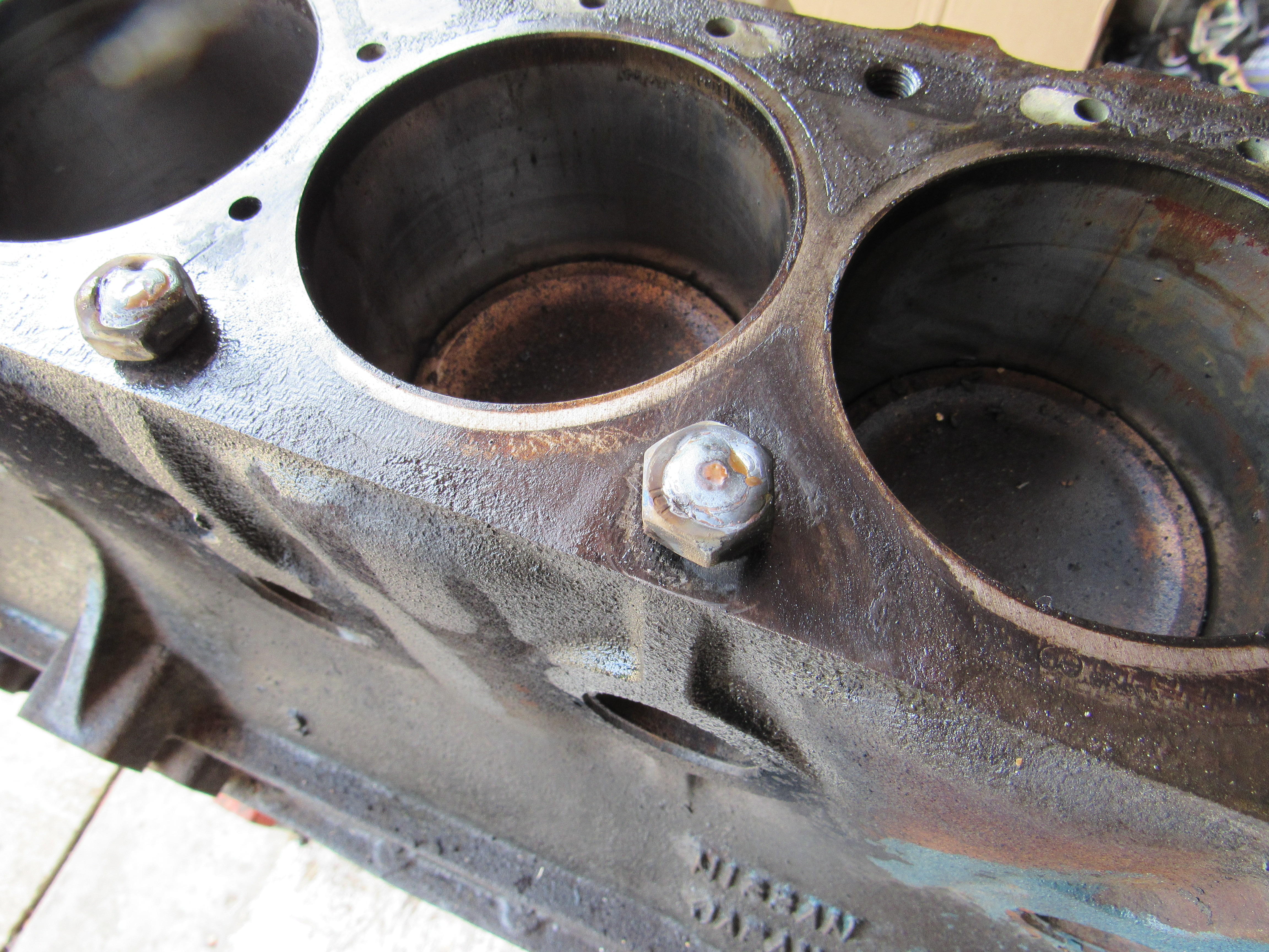

First pic is the 2 broken bolts I knew about, second pic is another one I discovered when I removed the timing cover, last pic is just letting the block cool down before removing the broken head bolts. I pulled out the Oxy Acetylene torch and got them all cherry red, they all came out easily after that.
So you heated the bolt cherry red or the surrounding metal? I would have thought when the bolts were that red they would be too soft to turn out. Did you let the dull down any first or just turned them out red? Did you use any oil on them while hot, I assume no? I need to get an Oxy/Acet bottle setup...bottle envy. :blush:
LOL I like that.  With the  M6x1 bolts I just put the flame on them from the side and got them glowing and quenched them with WD40, and did that a couple of times then did a double nut on each one and they came right out.  The head bolts I dropped the pistons as low as possible and slowly heated a six inch area around the bolts then after a minute put the flame right on the bolt until red then WD40 and repeat.  Welded on the nuts let it cool right down and they came out with no effort,  I was concerned about the thermal expansion of cast iron vs the steel bolt so went slow with heat.  That is a complicated area with water jackets (air gaps in this case) on either side of the head bolts and a steel cylinder sleeve on the inside.
