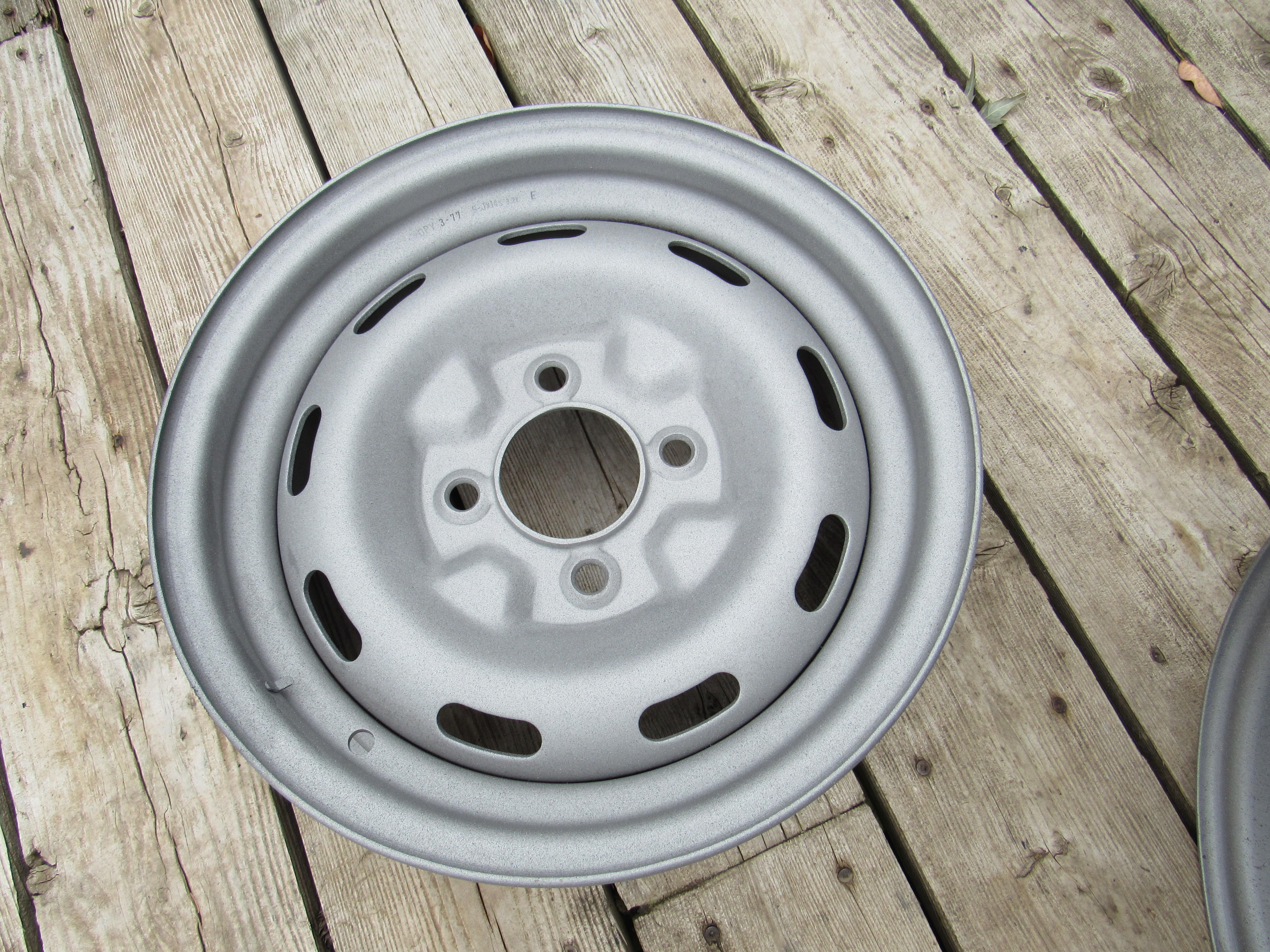

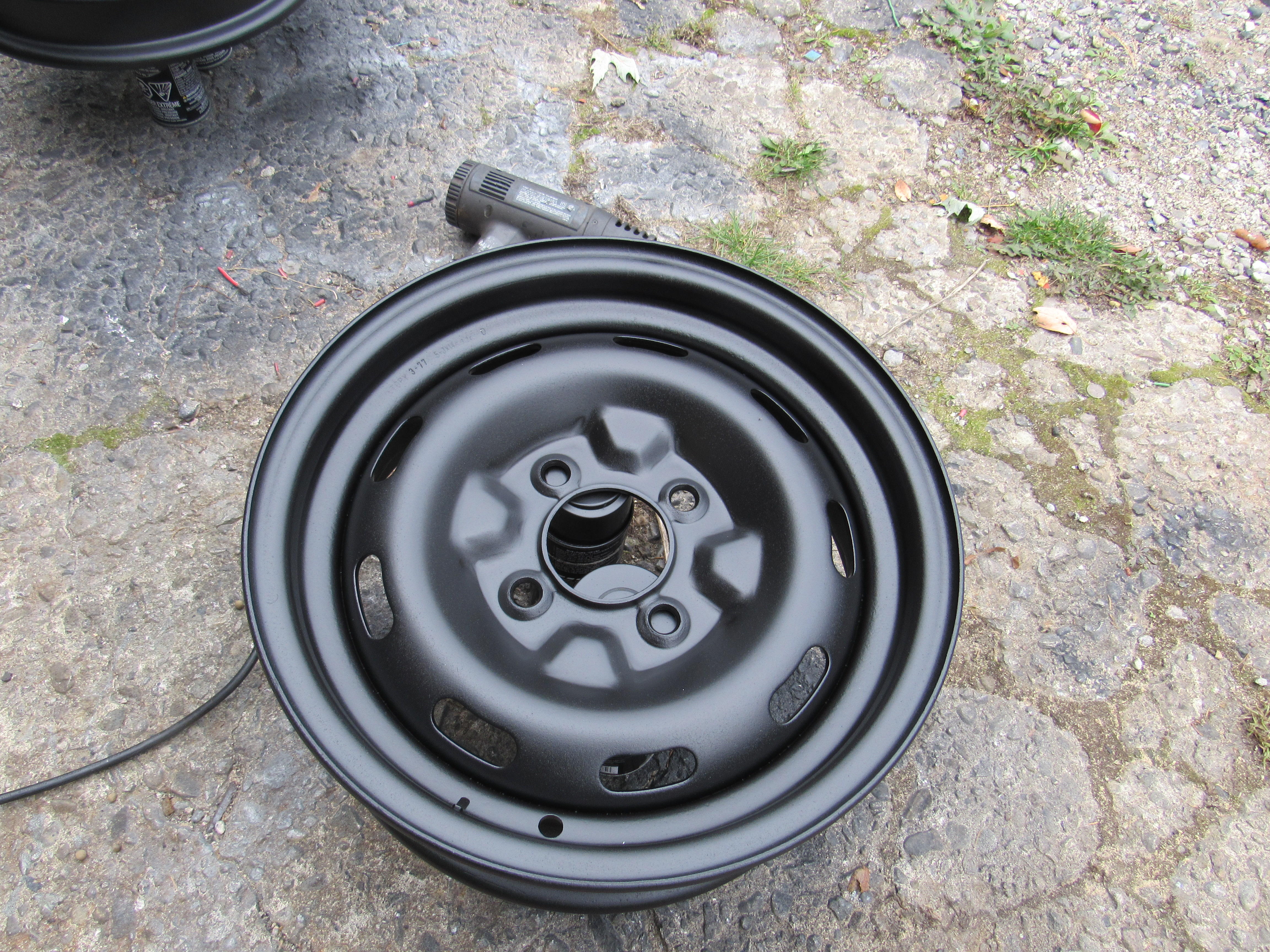

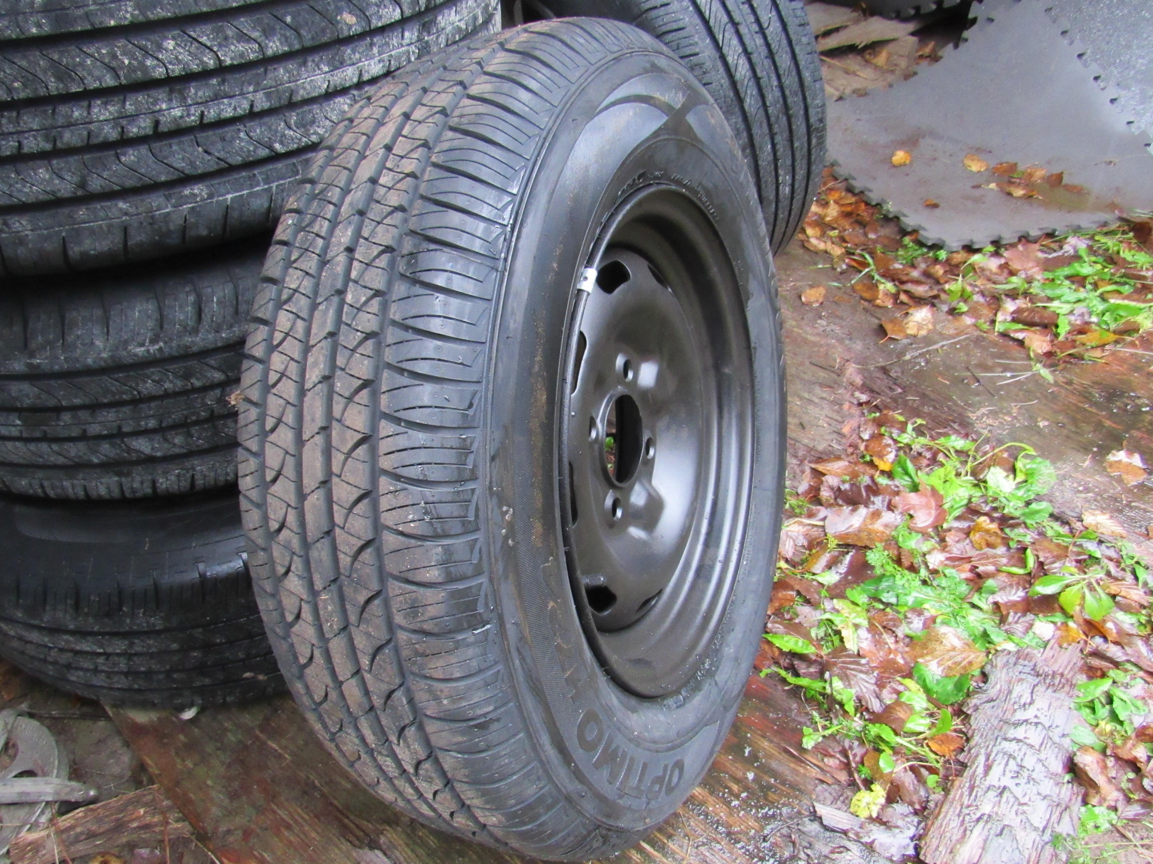

Just got the wheels back from the sand blasters,  not easy finding a 14" stock looking tire with a modern tread design and quiet on the hwy.    I settled on a set of P195/70 R14 Hankook Optimo, they seem to fit the bill.

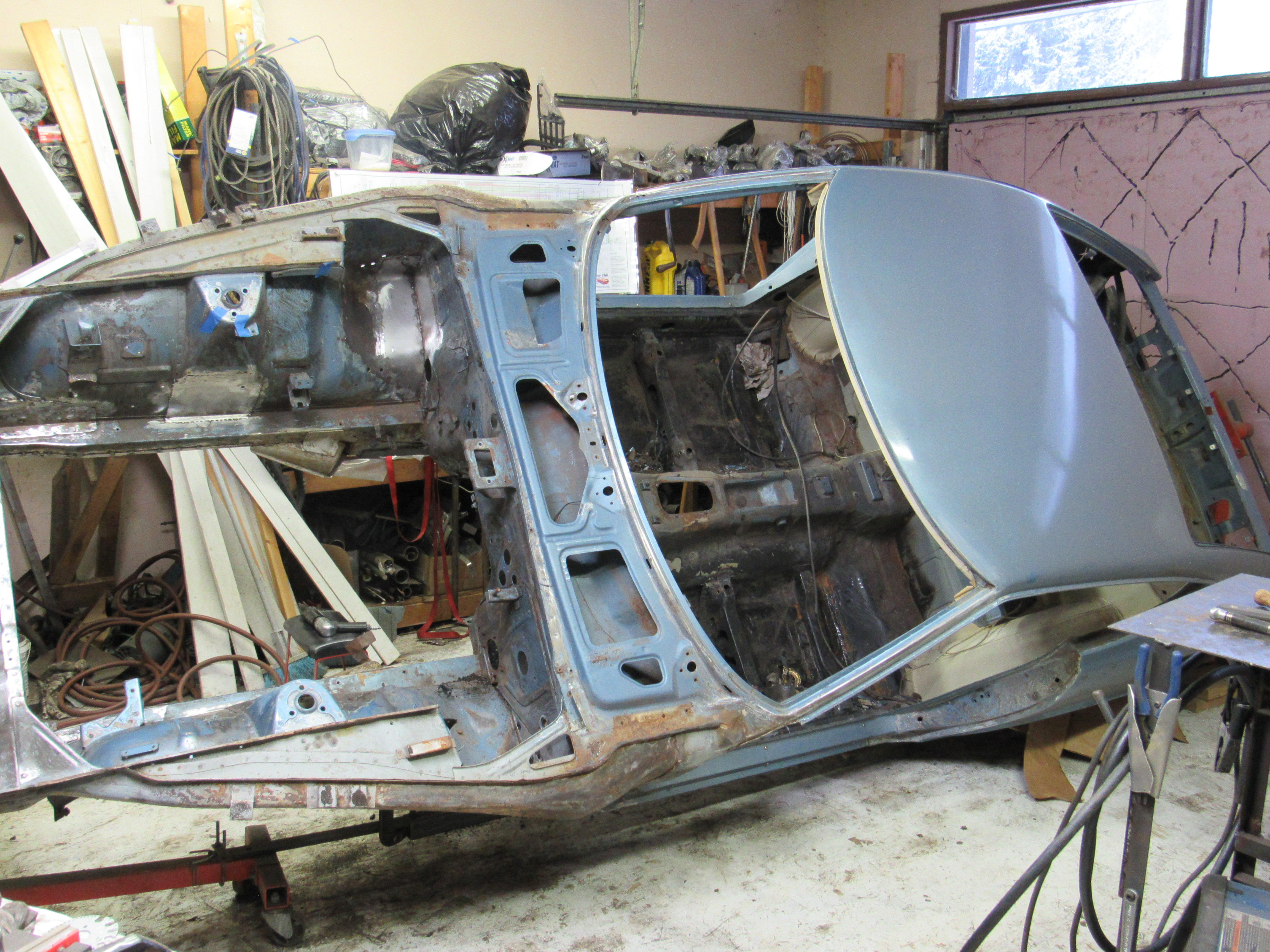

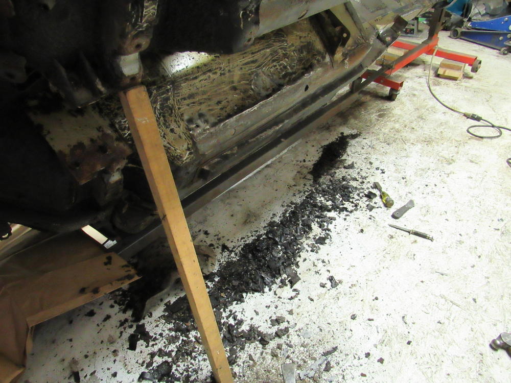

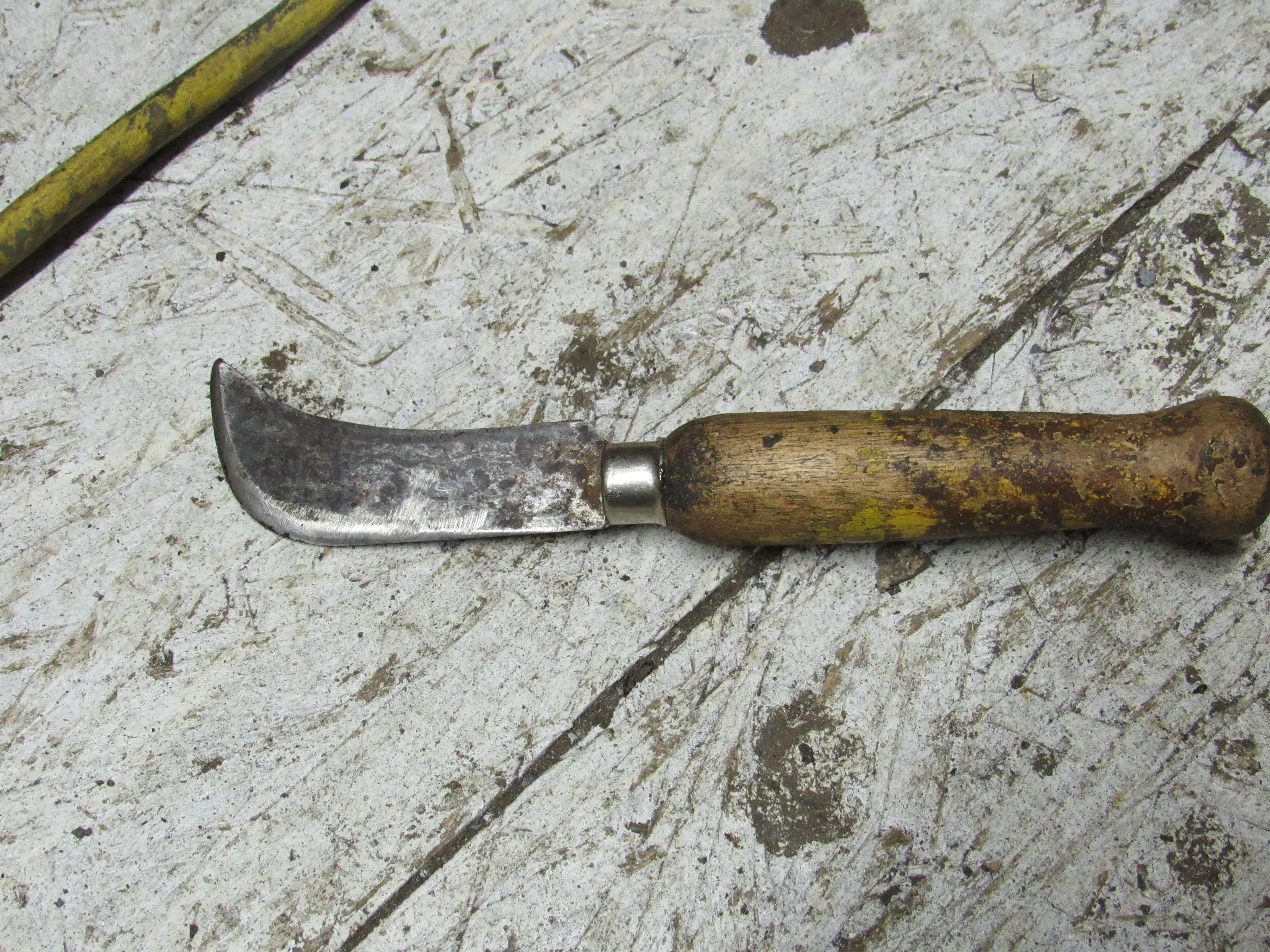

The 280 is up on the rotisserie now, cleaning up some of the previous guys welding work, only about 1/3rd into the undercoat scraping:cry:

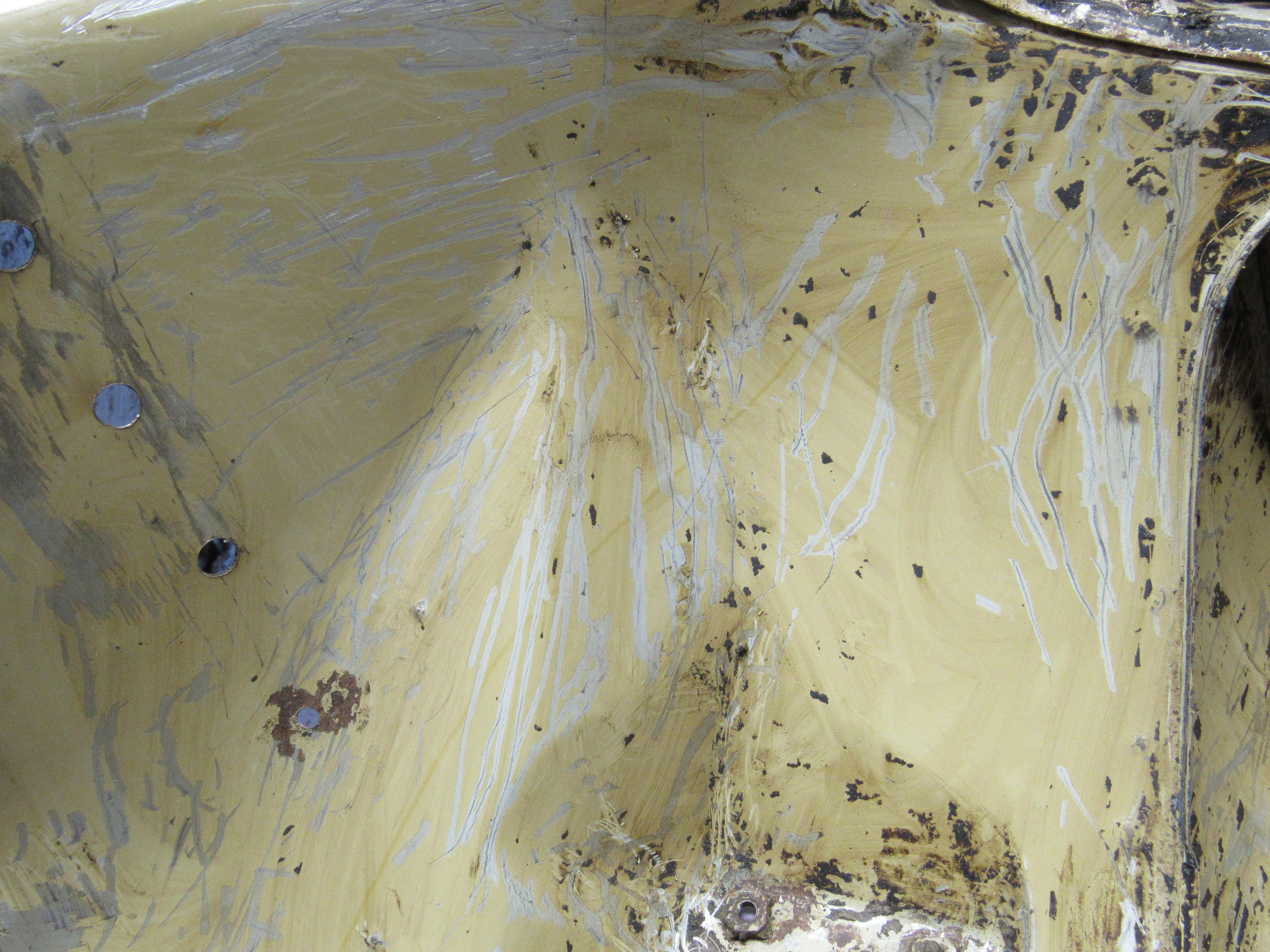

Underneath the crud is a cream coloured coating and bare metal underneath that, can anyone tell me exactly what that is, 2k primer, single primer, paint?  The last pic is a scraper I made out of an old carpet knife, I sharpened the outer edge as well as the inner and it allows you to get into most of the curves and crevices, wish I had thought of this years ago.
Will it come off with lacquer thinner? If it does, it's single stage. If it doesn't it's probably a 2k primer. I wouldn't expect epoxy. What type I don't know, but from my experience it seems to stick  pretty good.
MEK would be the better solvent.  The MEK rub test is an actual coatings test, to assess degree of cure of 2K type coatings.
It's a people-power test but they've tried to make a machine for it.  A look in to the world of paint.
http://www.trl.com/paint_solvent/
https://gardco.com/pages/abrasion/mekrubtest.cfm
OK so I just did the rub test with MEK, the cream coloured coating is definitely 2 part epoxy primer, I rubbed hard and nothing came away on the cloth but the last remnants of the undercoating. Thanks all.
