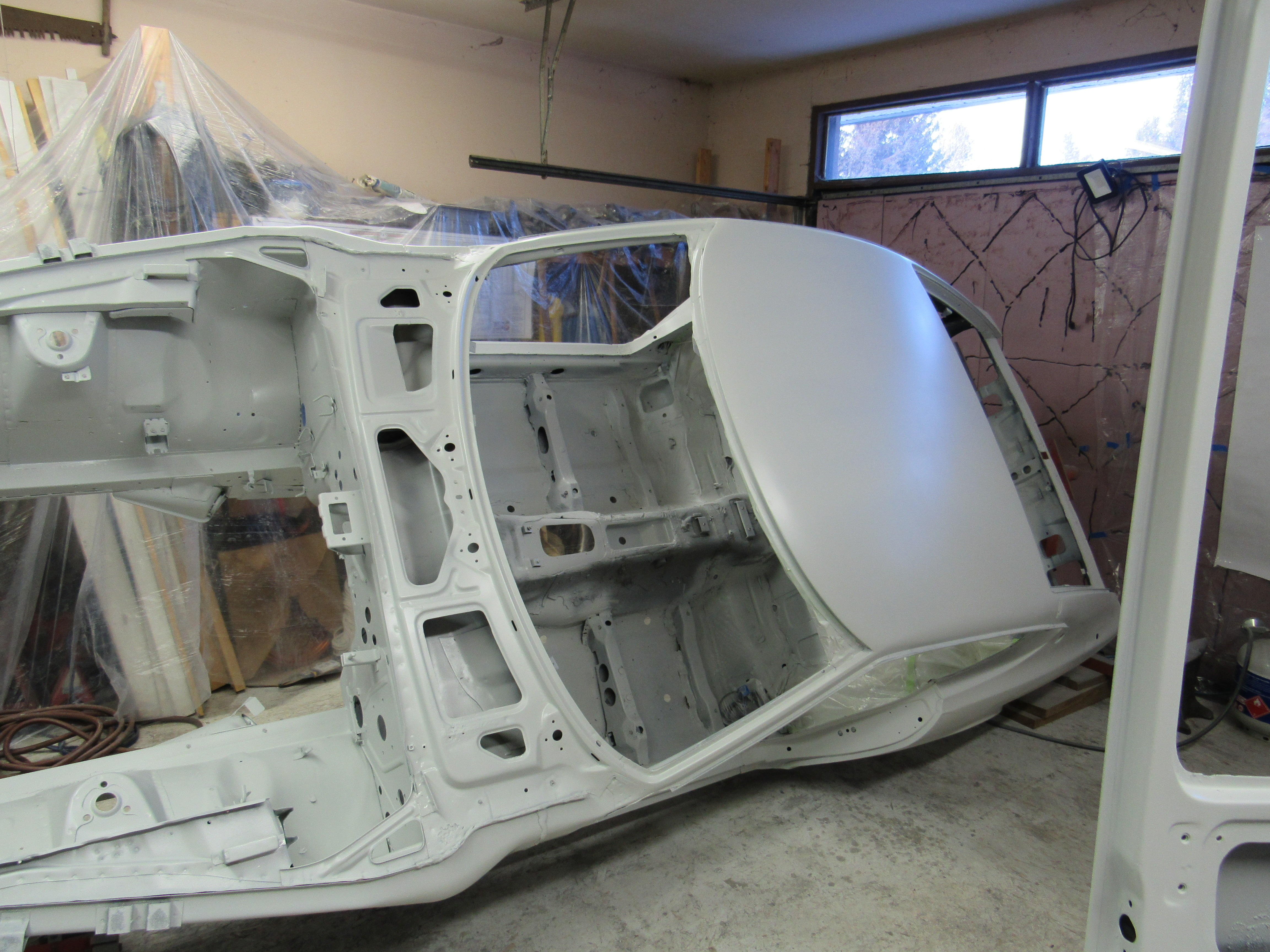

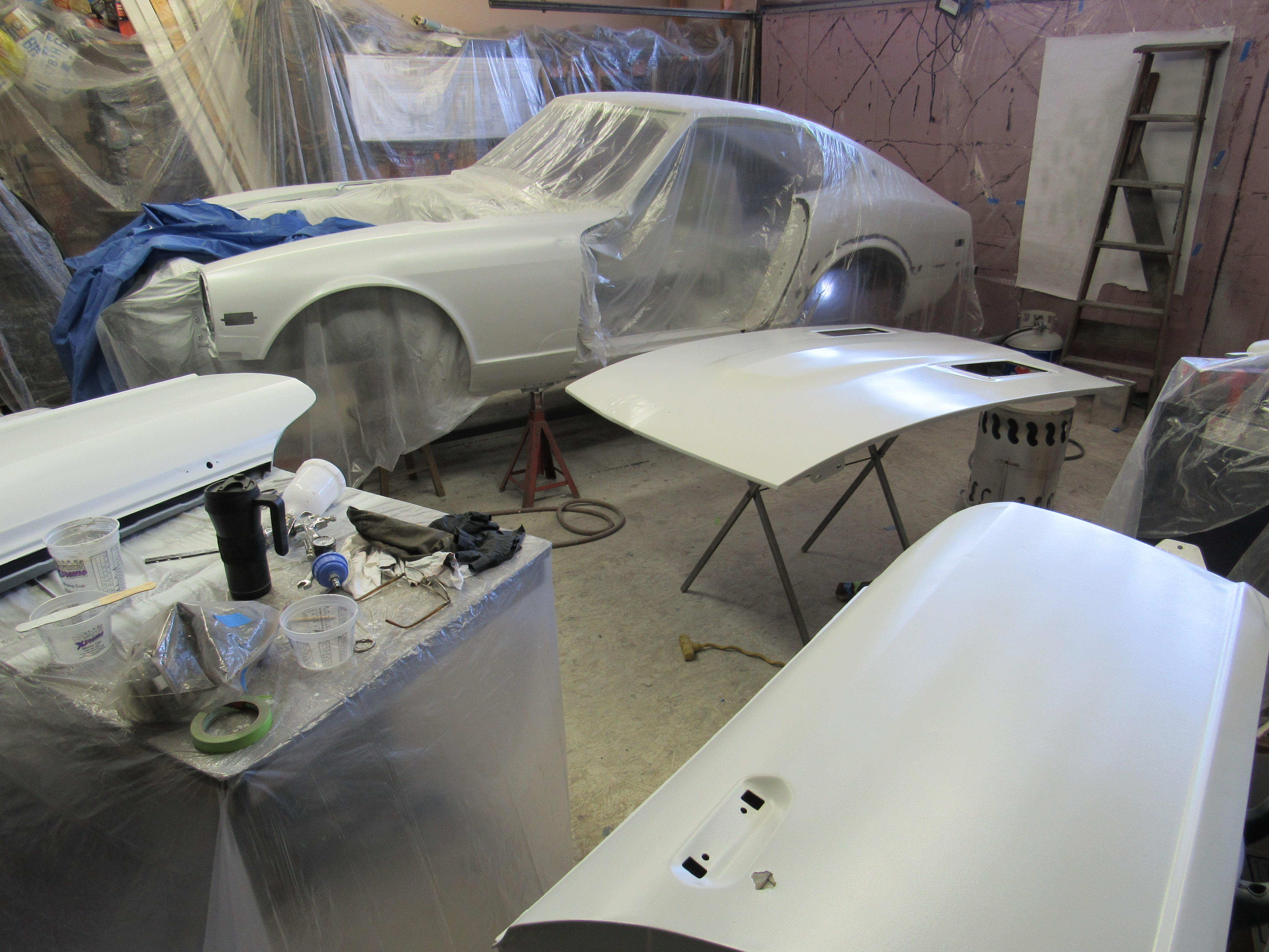

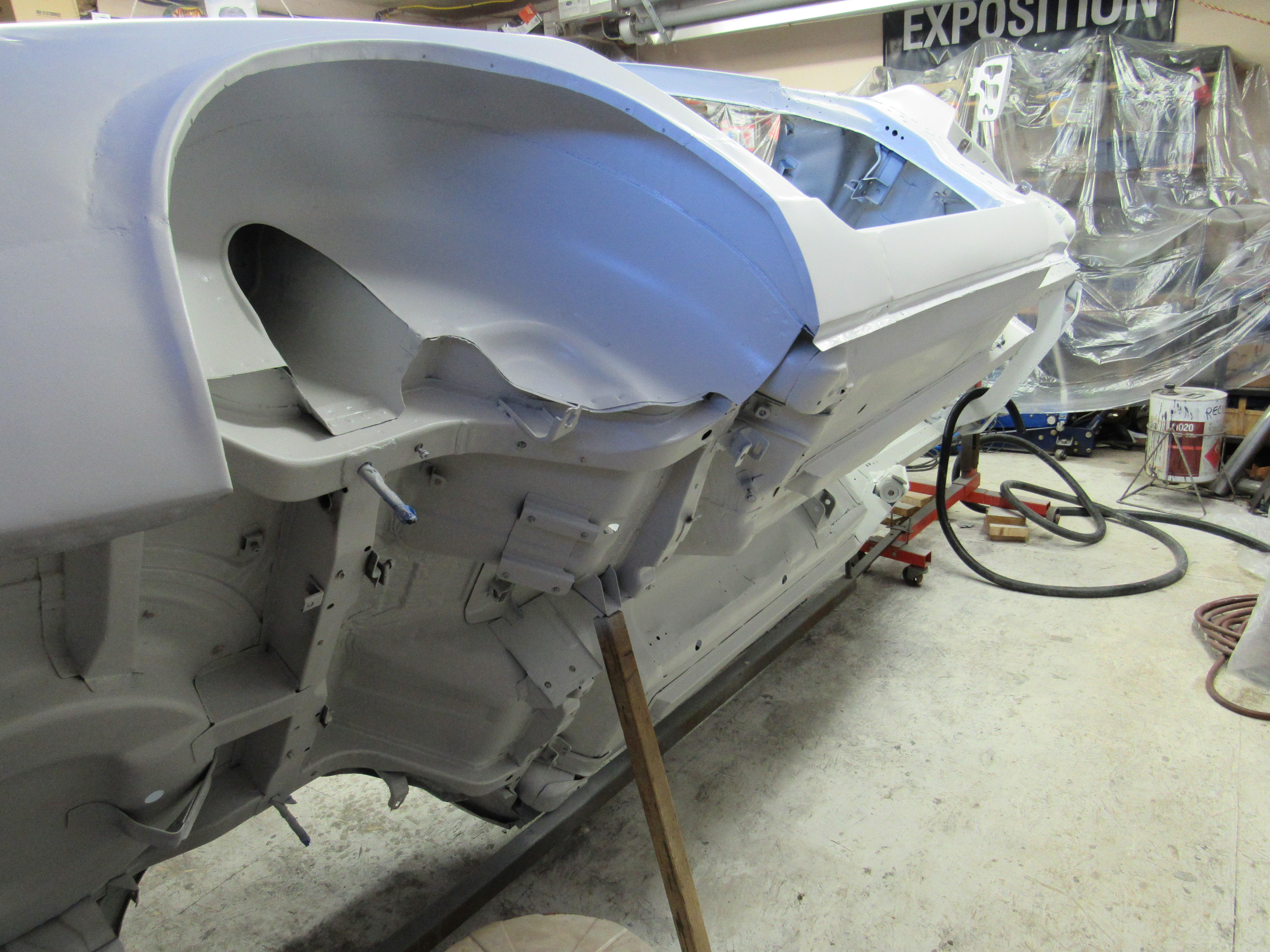

I have been so busy with the 280 I forgot about this thread, so I got everything down to bare metal, two coats 2k epoxy primer on all surfaces and two coats of undercoat, and now that it's all sealed up I can breath a bit and not have to worry about the coming humidity.
As it was time drop the car off the rotisserie I had a chance to weigh it, this is just the shell,  the only thing left on the car is the vinyl headliner and the 2 rear wheel arch vinyls.

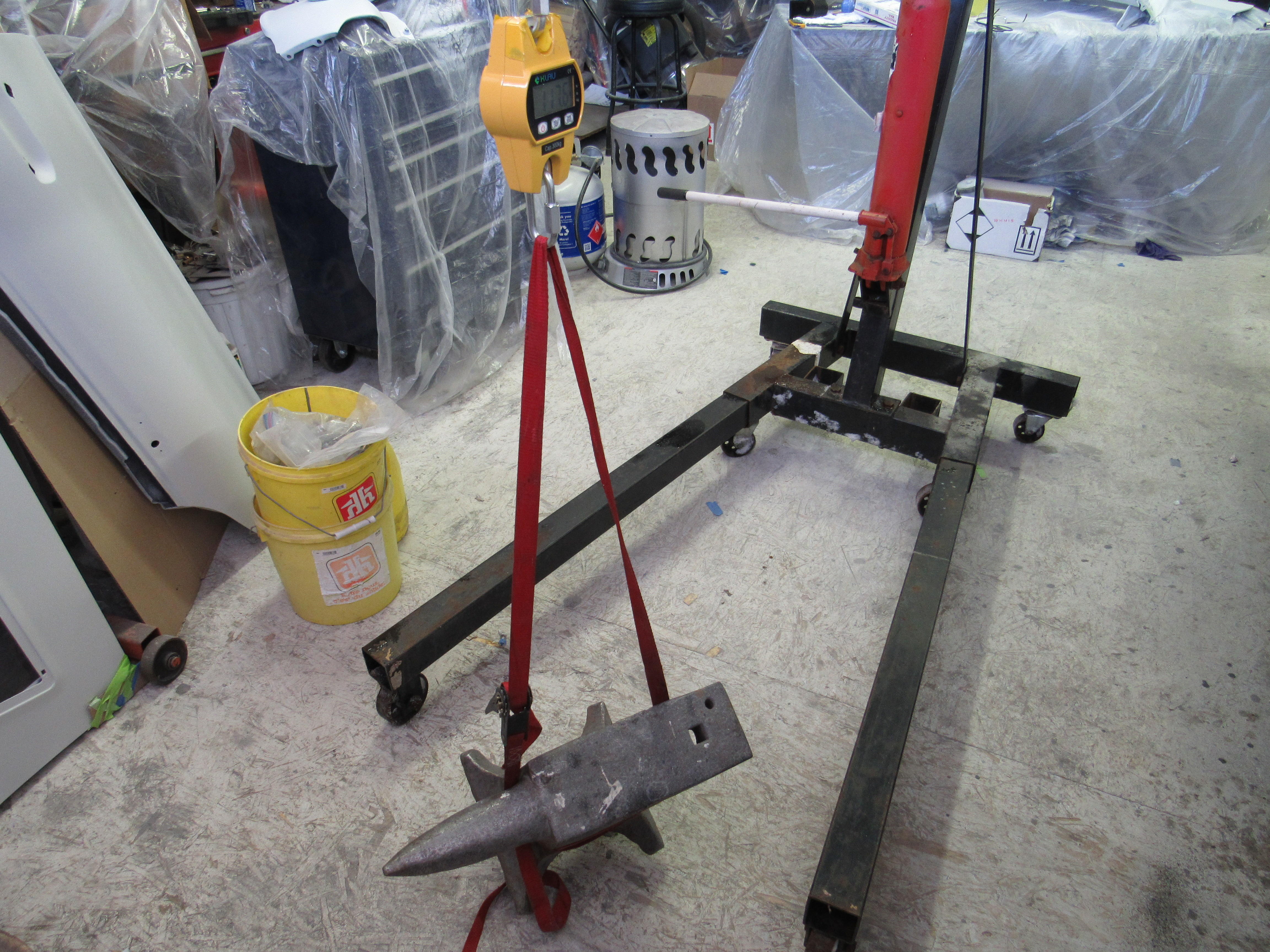

Now I'm not 100% on this method but I couldn't think of any other way to do it with what I had on hand.  With the car level the rear measurement  was taken with the car hanging from the rotisserie bar that bolts on where the tie down hooks usually are, then jacks were placed under the rear rotisserie bar and the front was weighed hanging from the front rotisserie bar that is bolted to where the bumper shocks attach just in front of the radiator support.
I checked the accuracy of the crane scale by lifting my small anvil which I know is 118 lbs and it was bang on,

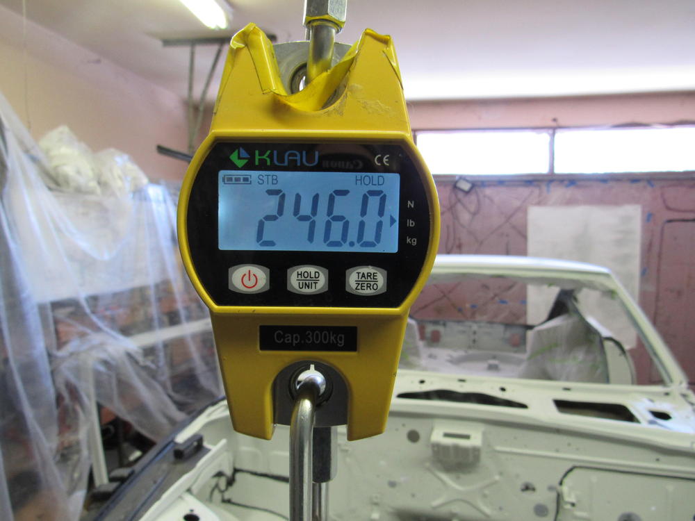

I have to apologize, I forgot to take a pic of the rear measurement but it weighed in at  289 lb, front was 246 lbs
289lbs
246lbs
535lbs minus the 6lbs of the rotisserie bars, is 529 lbs
