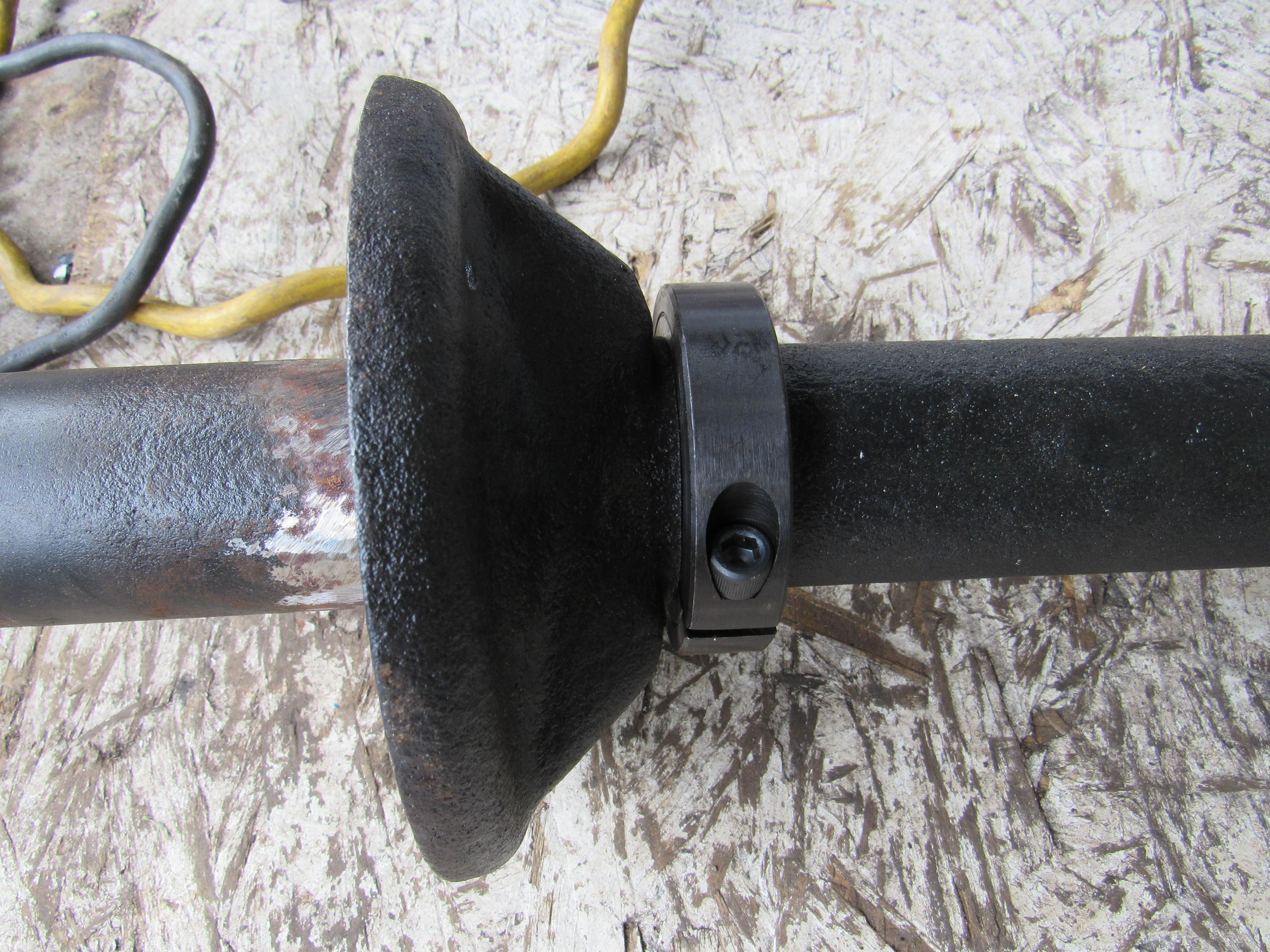

CO, you don't need to weld the perch and hope that you have picked the right height, you can mount the perches on split collars and raise and lower them until you're satisfied they are perfect and then weld them.  In fact the split collars clamp with such force that you could tack the perch to one side of the collar and leave it at that.
Thanks. I was thinking about doing just that (after I saw your post on your 510 thread).  "Test" out the amount of drop before I permanently committed to it.

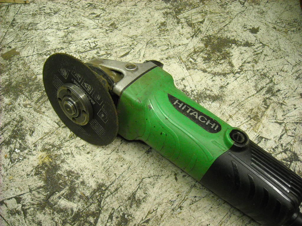

@grannyknot, What tool did you use to cut your perches loose on your 510?
When I cut the perches off the stubs I got from @wheee!, I did it on the lathe by boring the inside out until the perches fell off. Can't do that with the bodies I want to put on the car.
I had originally planned to just go completely postal with the grinder and cut the perches off my tubes in pieces (since I didn't need to salvage them). But your removal method looked gentle enough that you could reuse the perches (which I assume was your plan).

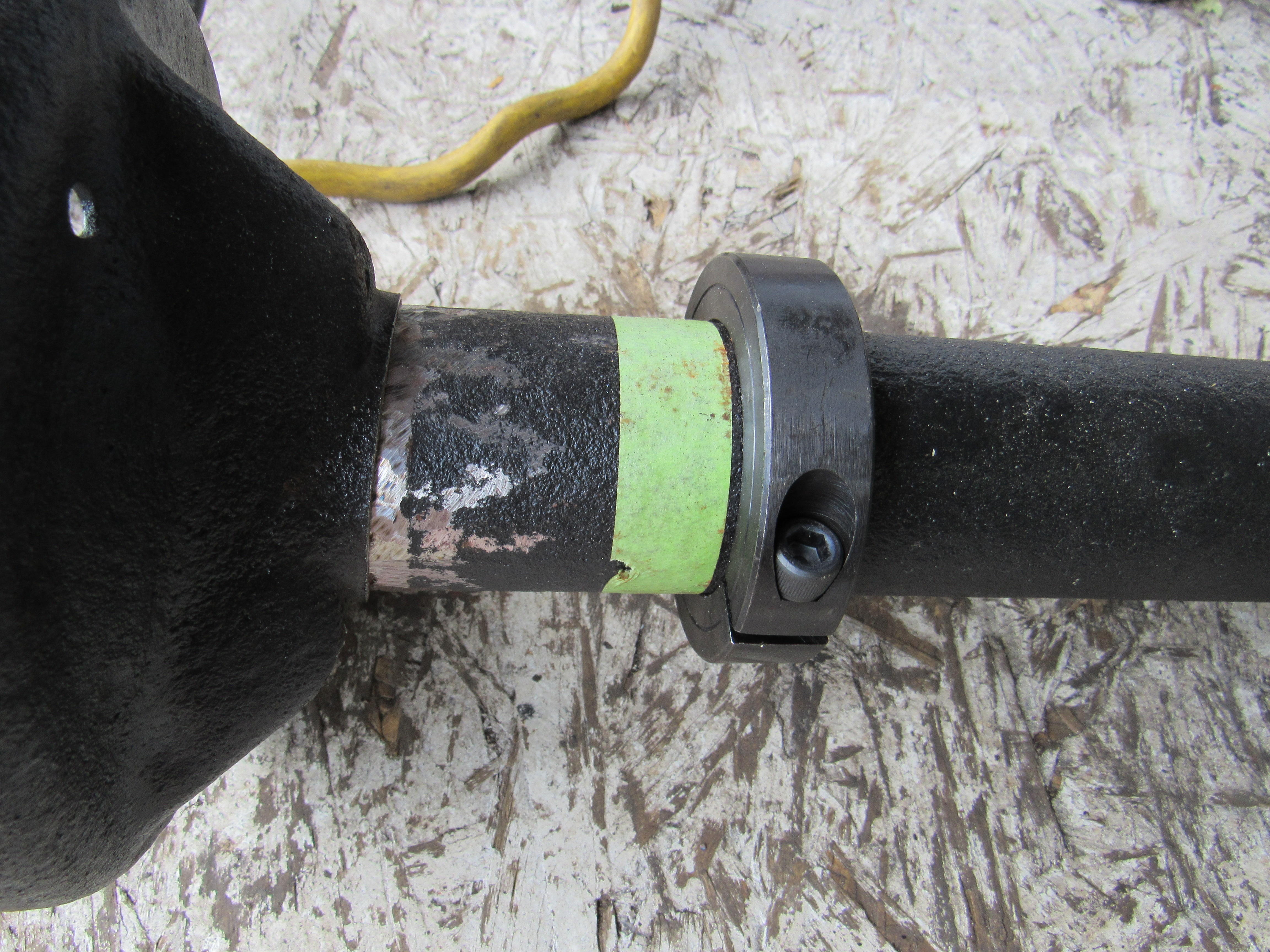

If possible, please mark the photo in Post #32 to show the area where the grinding needs to be done.  Based on the earlier pix (Post #28), it looks like you just ground off the weld bead that sits immediately below the perch stamping.  Is that sufficient to free up the perch?  Just want to be sure I understand this correctly.
The weld bead holding the perch to the strut tube is about 1/8th" tall and I cut just above that, you can see the cut line right next to the weld bead  in the photo on post #32, after the perch is off you grind down the bead so the split collar and perch can slide past.
The only danger is cutting too deep and going into the strut tube, the metal is thin. A hacksaw is a safer way to remove the perch.
Thanks for the tool info. Some guys are artists with the angle grinder, but I'm not one of them. I'm worried that I'll slip into the strut tube.
Maybe I'll try it on the band saw first and see how slow that goes. If that's excruciatingly slow, I guess I'll try the grinder.
