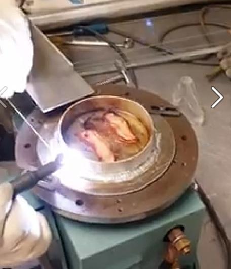

Or maybe frying a robot bee!  LOL
Point is... It shouldn't start and stop as the wire burns back so far that it breaks the arc until it contacts again and starts. It should be a nice steady sizzle. Like frying that bee.
This is making me both hungry and wanting to weld something. Is that wrong?
